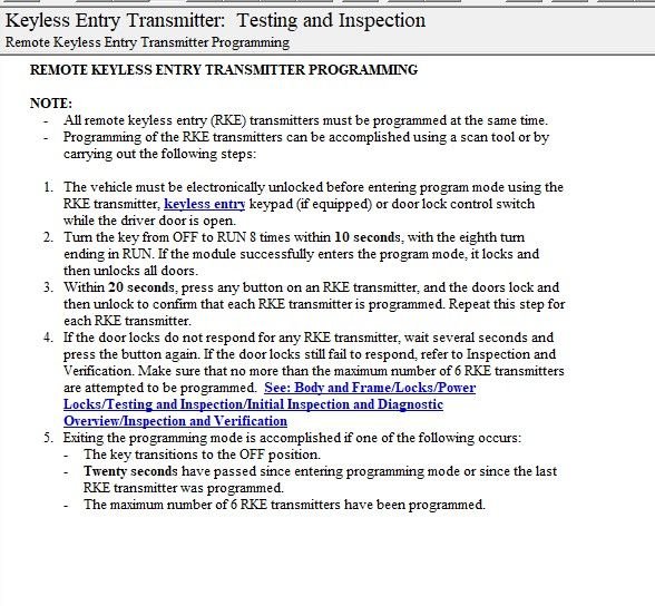

I have a 2008 Sport Trac and recently my key fob was slow in reacting, so I purchased two new ones and made sure the batteries were new. I programmed them and they worked fine for a while. Recently I have a had to push a button multiple times to get it to lock or unlock the doors, until yesterday they completely quit working. I placed new batteries in them and still nothing. I put each one through the programming procedure and all went well until I was done and the fobs still do nothing. I have programmed them multiple times and each time all of the lock/unlock responses happen, yet when I am finished none of the fobs will work. It almost seems like the signal from the fob to the truck isn't being received.

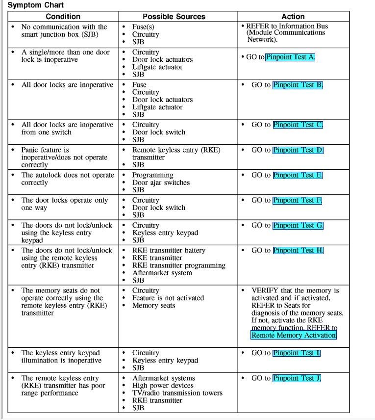

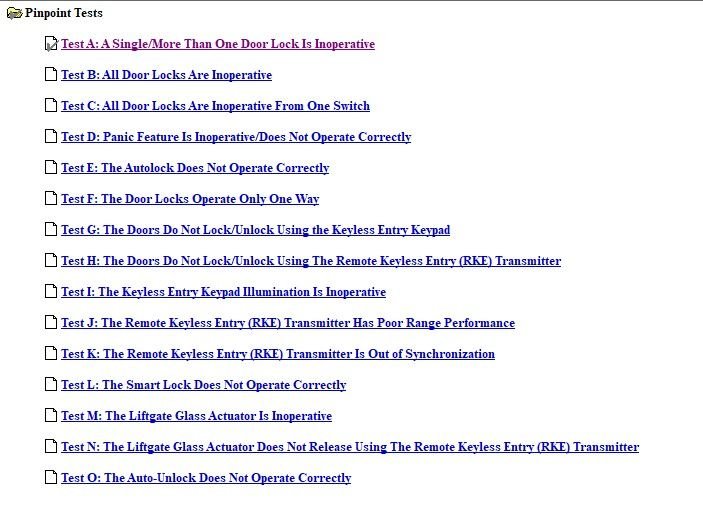

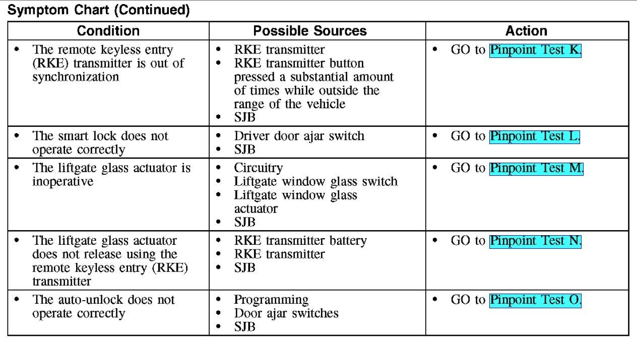

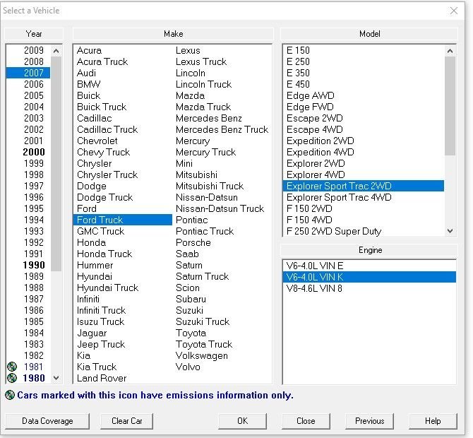

My alldata 08-09 are missing info, so I picked 2007 instead. I also randomly selected 4.0L with VIN K (8th character of your VIN as K) because you never provided that info. (Check my signature below).
Pinpoint test index page above, all the test details attached below.

If I'm reading your info correctly - which I greatly appreciate - I have programed my RKE;s properly and they respond to the programing during the process. However once the process is complete they will not lock or unlock any of the doors nor engage the security horn. I think Test H above is the one that would apply.
