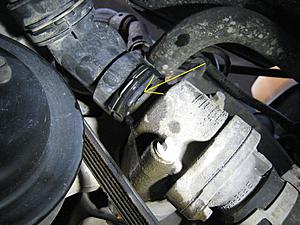

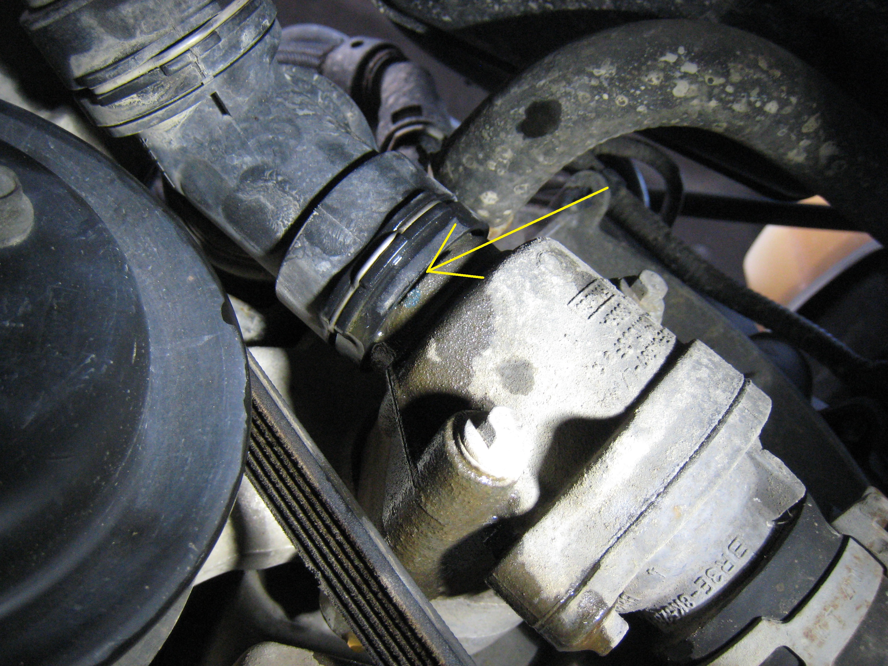

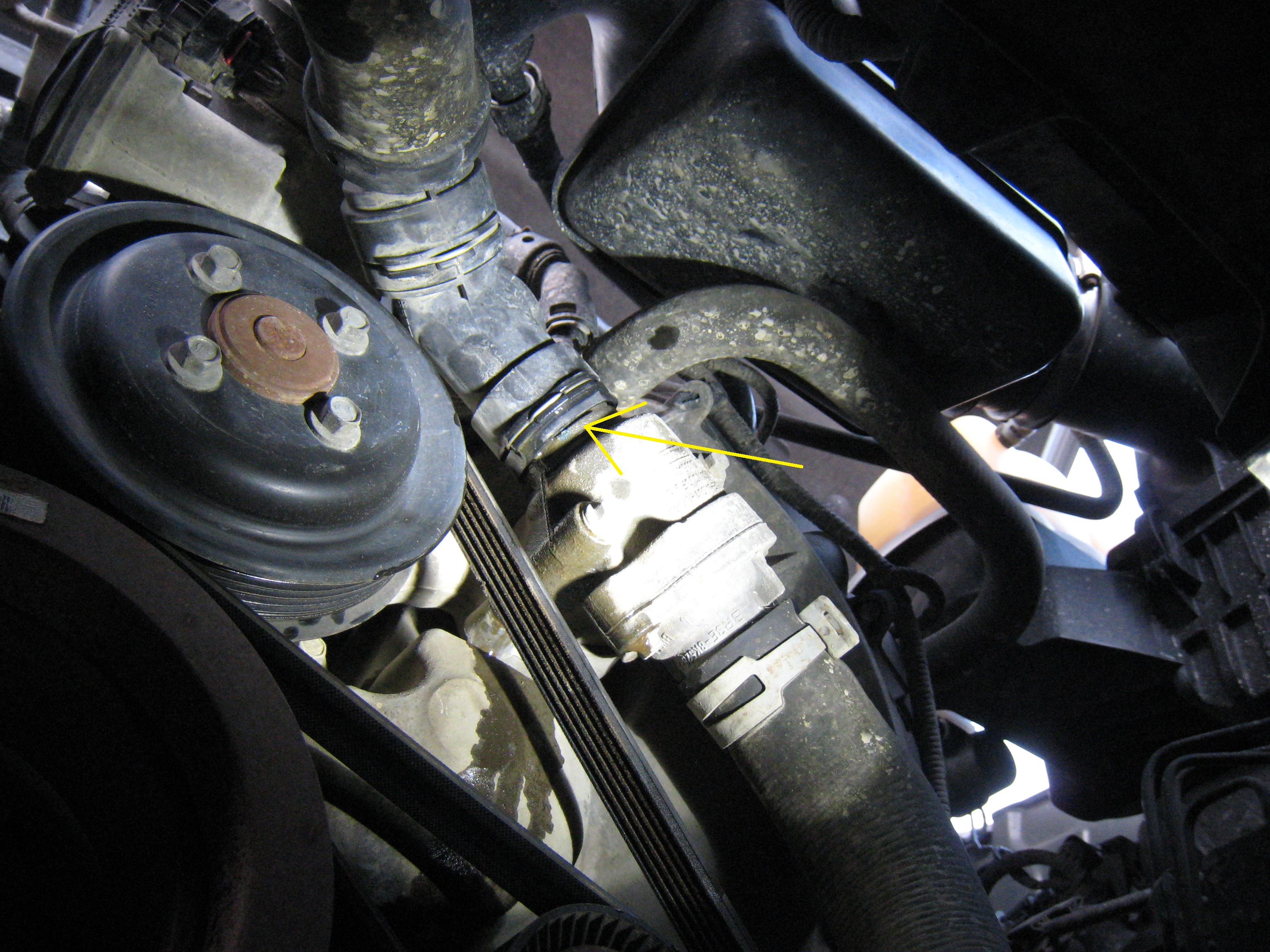

So it seems I've found the source of the leak. It appears to be coming from a junction point between the rad and the water pump, just below the air box. When I jiggle the connection point, some fluid visibly leaks out. If anyone knows a part number, that would be great. It seems easily accessible once the air box is removed. I will include some pictures. Thanks again.

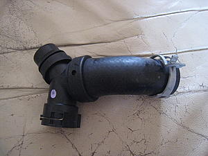

Hey so I picked up the part from Ford today, $100 in Canada. IM sure you'd be able to find it cheaper in the States.
Part# DR3Z-8566-B
