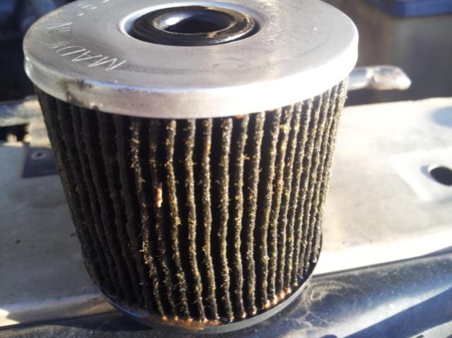

Ok, I replaced the filter and the truck is running great now!! But now I have another problem. My fuel tank selector valve is leaking pretty bad when the truck is running. I went to a few autopart stores and they have them, but the wire hookup is different because they're universal. I cant find the original that is on my truck. Is it a pain to re-wire it so it works on my truck? And I need a 6 port valve, they sell the 3 port valve for $30 cheaper that looks exactly the same, but they have three of the ports capped off with rubber caps. Can I pull those caps off and use it as a 6 port to save 30 bucks? Or is it built different on the inside? Thanx for everyone's help. By the way, heres the old filter I pulled out, pretty nasty!

glad to hear that you got it going, and yes, Mr. Grindman, it WAS vapor locking, because the pressure wasn't what it should have been.
As for the selector valve, you might try Vintage Ford; but these selector valves were getting scarce a few years ago, so it might be hard to find an original.
You might just be stuck having to modify whatever you can get; it's not the first choice, but sometimes you have to do it.
