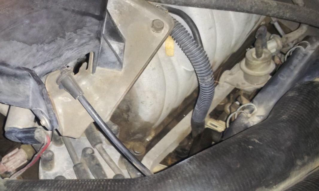

Well, when I said it ran fine, I barely drove it. I just went around the block. The last time I drove it, I went farther and it was fine in the beginning but then started doing the same thing as before I started fixing anything. Im trying to find my schreader valve to check the pressure but I cant find it. I know its on the fuel rail but I'm not seeing it. On another post someone is saying I'm only looking at half of my fuel rail and its on the other half, but I don't know where the other half of it is. Here's a couple pics of my rail if anyone can help me locate the schreader valve. And the tank selector valve that I replaced had to be replaced anyways because it was leaking pretty bad, so I haven't wasted any money so far, thankfully.....
