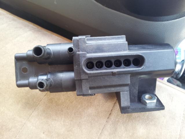

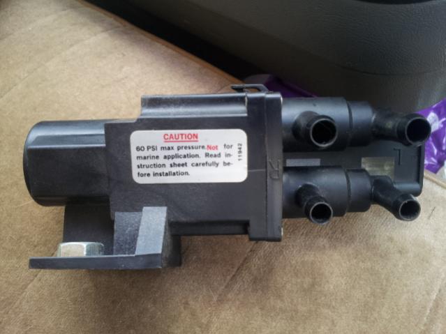

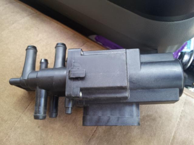

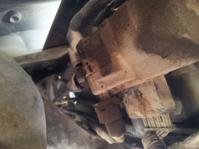

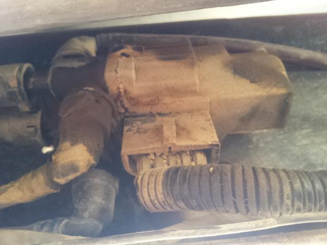

Well, here's the new one, and the old one. I had to order the pigtail for the new one and it wont be here until the 25th. I'm wondering if anyone knows where I can find a wiring diagram, or anything that will help installing the new one. Also, the new one came with an extra port, its a lot smaller than all the other ports, its in the pic. I blew through it and it feels like its sealed but the part came with no paperwork what so ever.

I got it from autozone, but I know how to hook it up, I just dont know about the wiring part. The guy at autozone that ordered the pig tail wasnt sure if its coming with a wiring diagram or not. I just need to be sure I wire it right. And thats the only kind of selector valve anyone has now. I looked everywhere and they all have the same thing. The original is extremely hard to find now, I couldnt even get it through ford.

I have the right part. Im just looking for a wiring diagram. I found that site you sent me to, and theres no pics of the part, and doesnt say if they are 3 port or 6 port, it doesnt ask what kind of motor you have, etc. Like I said, I have what I need, I just have to see a diagram so I dont hook the wiring up wrong and burn out my fuel gauge, and so It will work the way its supposed to. Thank you for your help though.
