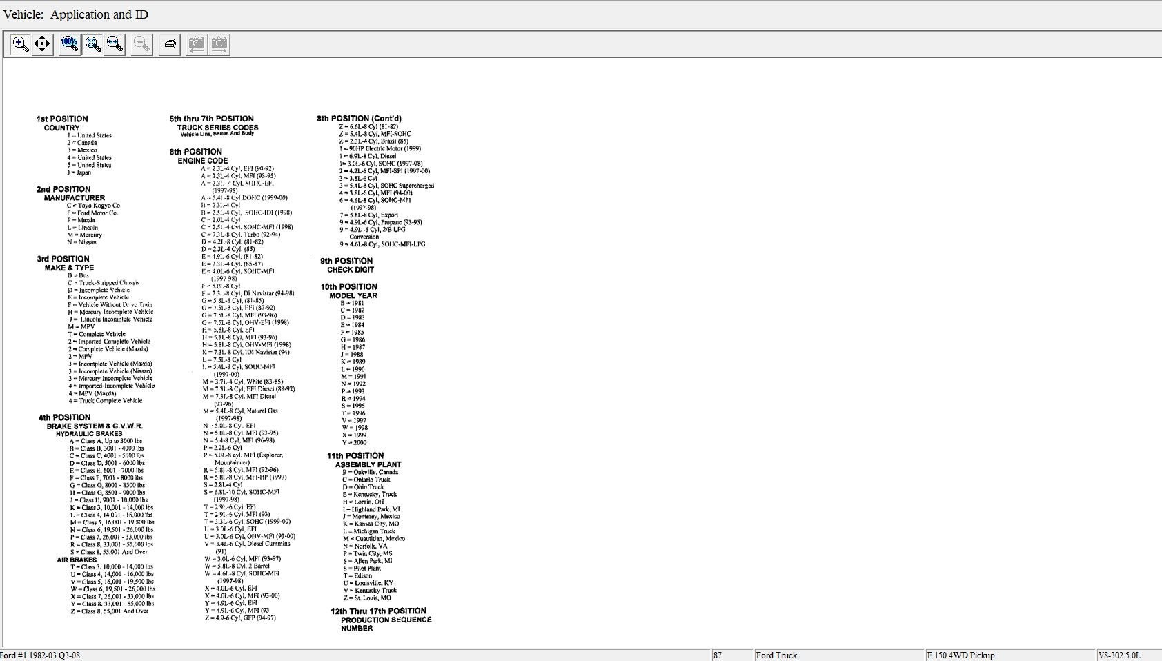

You need look at your VIN then refer to the chart I attached previously, don't worry about my signature, your original post was clear enough.

Which VIN number do I need to look at. The only things I see on that chart are for assembly location, brakes, and engine basically. I do not see what to do to find the information I need
