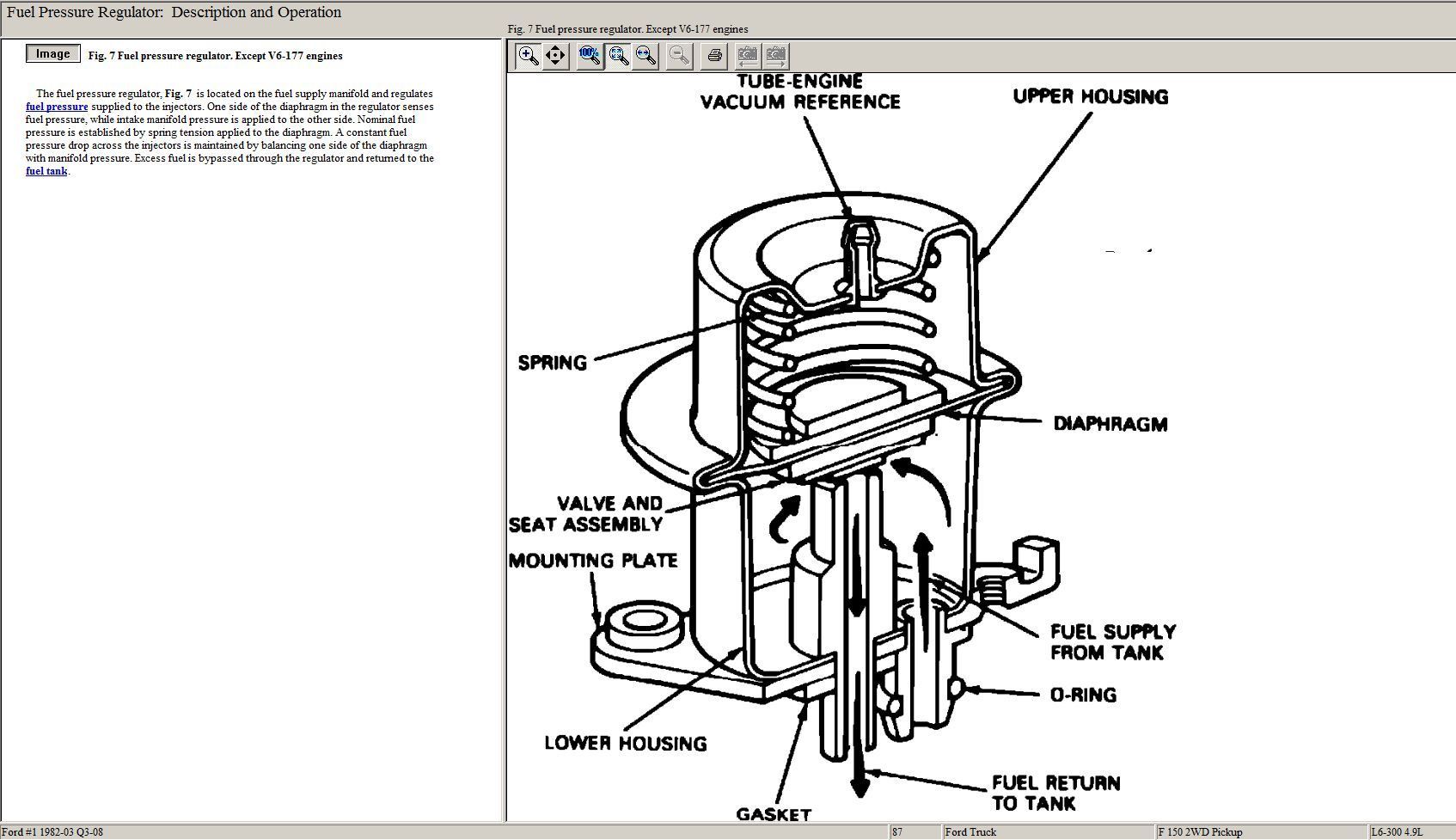

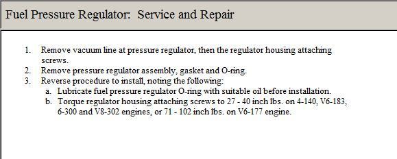

I have a Ford F150 4.9 (6 cylinder) and need to remove and replace the fuel pressure regulator. It seems the only way to do this is to remove the top half of the intake manifold.
Anybody have any tips which may may make this easier?
