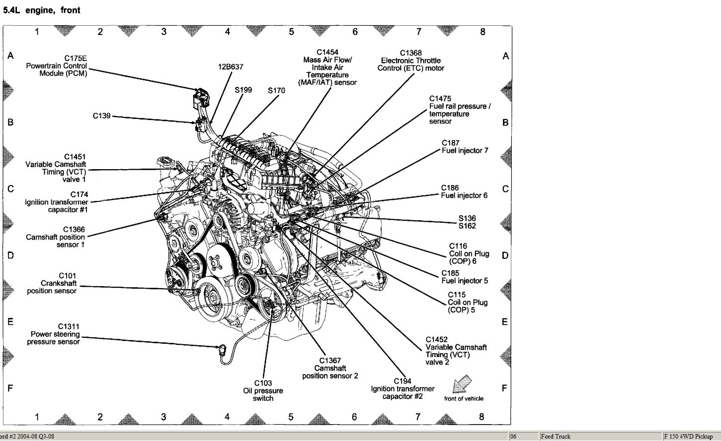

Next time your engine stalls you can disconnect your battery ground cable, then quickly remove the MAF harness, and quickly connect your battery ground back. Please note when driving without MAF you can put your car in limp (fail-safe) mode and you get CEL but that's fine for diagnostic purpose, your AC and radio might not function, your trunk may lose power when it's in limp mode, just drive for 10 minutes or so around your neighborhood and your objective is see if the engine stalls again with MAF disconnected. When you are ready to plug the MAF back just stop the engine, pop the hood, and key out door closed, and wait 15 minutes, then plug the MAF back, you don't really need to disconnect the battery ground this time.
Are you sure your CEL is working? Do a bulb check real quick you can tell, turn your key to ON/RUN position, do you see the CEL and once you START the CEL should go away. Please also note that if the previous owner just did a CLEAR CODES the relearn can take 100 miles driving or a few days and during the relearn process don't disconnect your battery anymore. Also do not scare yourself on those receipts, you need to trust your good scan tool to find out more.

Thanks for the suggestions and info - if the truck still stalls with the MAF disconnected, is that an indication that the MAF is bad and should be replaced?
CEL is working, the bulb ignites on power on then disappears when the engine is started.
I have a feeling the PO cleared the codes, yes. Does that mean new codes won't start showing up until the relearn is complete? I feel like I've had new codes pop up right after they've been cleared on cars with chronic misfires in the past.

When you disconnect the MAF your truck will operate in fail-safe mode or limp mode with the factory predetermined air fuel ratio, and when everything seems fine except the lack of power, then your MAF is bad. When there is no improvement, then your MAF _should_ be okay. Don't worry about getting new CEL when MAF is unplugged, your goal is to narrow down the issues so you can move on to something else.
If your CEL bulb test is working and if your truck has major issues you should get the CEL anytime, or they are already in pending stage. There are Ford's specific DTCs that don't trigger the CEL. If you have a generic obd2 scanner you should be okay, but you still should ask your friend to borrow a good scan tool.
