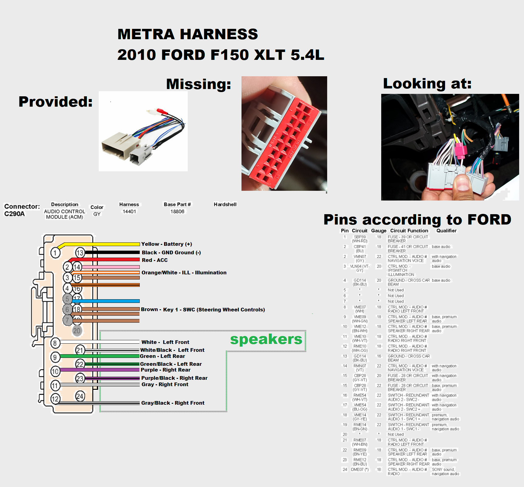

I attached some files to reference to. In the attached picture “RadioC290A” you will note that pins 18 and 19 are for the audio controls. If they are blank/empty,the wires for the audio controls have not been installed. If they are… you suck because I have to run my own… Now skip down to the section SWC Adapters. If not… then continue on…
Disable your Airbag and unplug the battery.
locate the clockspring plug (C218A) in your steering column. It should be located under the steering wheelas seen in picture “SWC”. Unplug the clockspring plug.
Locate empty pin 13 - VME14 (GY-YE). See “ClockSpringC218A” picture. Attach female pin on 18-16 AWG wire (can’t rememberwhich one) and install it into pin socket 13. The pin can be purchased on Amazon
here here
Using picture “SWC” run the installed wire to the radio harness (C290A) along thefactory wire harness with zip ties as seen in picture “RadioC290A.” Attach female pin to wire and insert into pin 18 of the radio harness.

Thanks for you message, it helped me a lot. I did it a little diffrently than you as my joying Radio has a CANBUS functionality built into it. Just like you PIN 18 is the important one.
However I found that just connecting the RED to my RED from FORD HARNESS to META HARNESS did not POWER UP my radio. I needed to attach my RED ACC PIN2 to POWER, I first tried the lighter and that worked,
then I realized that the power was in the 16 PIN harness that was not being used. SO I Spliced into that.
HERE IS A PICTURE OF WHAT I DID AND HOW I CONNECTED SWC Controls.

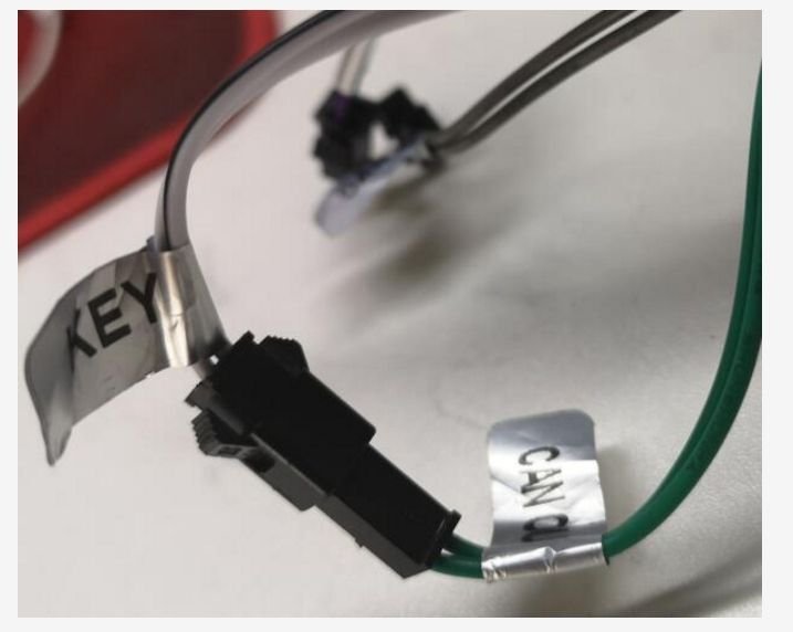

On Joying RADIOS you need to connect the canbus to the key1, its on the outside

Also if you want the SWC to work with joying RADIOS make sure you hookup their CANBUS interface which can be done by following this guide:
https://www.joyingauto.com/blog/tag/...le-din-stereo/
For FORD F150 it will be like so: connect KEY1 -> CAN OUT (these plugs come out of the Android unit itself, there are 4 on mine, CAN OUT, CAN IN, KEY 1 and IR)
This configuration seems to work for the FORD F150 (Key1 to CAN OUT) The other plugs can be left unplugged.
