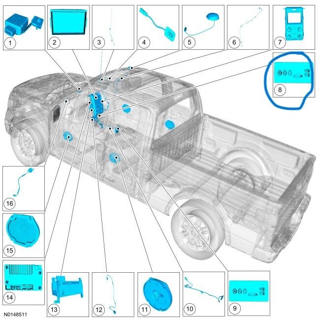

I'm posting images for reference. Does your vehicle have a media hub (image circled #8)? If so it receives PWR and GND from directly from the APIM (attachment labeled "media hub" is wiring diagram for SYNC gen 2) so if it is staying on, it would draw very little but your APIM would be the fault. Pulling fuse 2 would disable the APIM. Your bluetooth and radio wouldn't work. If it is just the a USB port (attachment labeled "usb") it's the same issue. If you believe it is the ports causing issue just unplug them.
