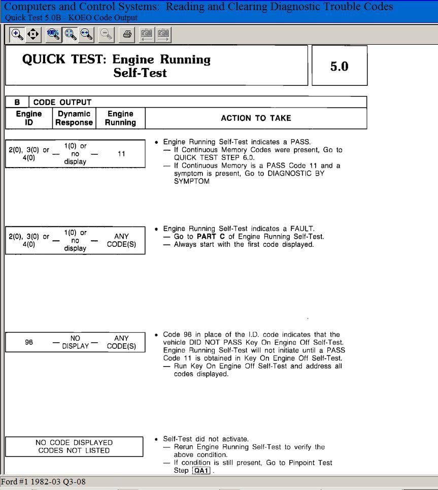

If you need to get to Quick Test 6.0 check the "Reading and Clearing Diagnostic Trouble Codes" section I attached previously.

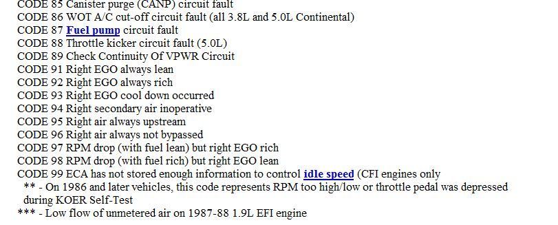

Does your engine have a Mass Air Flow sensor ? Code 98 is different for engines with a MAF sensor.

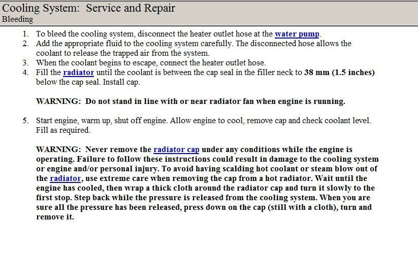

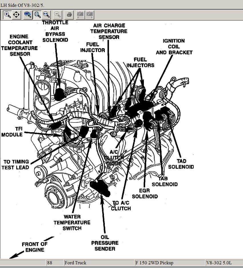

Code 21 + 51 locate ECT above. Just remove the electrical connector and clean both ends, also check for damage wires. ECT doesn't go bad, almost always a wiring problem. If you choose to remove ECT don't bother cleaning it's dirt cheap so just buy new (don't need Motorcraft brand), and you need to bleed if you remove it. If you have trouble removing trapped air bubbles, use floor jack and jack stands, simply elevate the front where your radiator cap is, so that it's at the highest point of the cooling system, much easier for the bubbles to escape.
