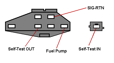

If you have access to a fuel pressure gauge, jump the DLC on the 'fuel pump' connection and ground the other end. You should hear the fuel pump relay 'click' and the pump/s will run continuous as long as the key is ON. If the relay clicks and the pump/s don't run, look for 12V through the inertia switch. If no voltage there, check the relay again. If all the voltages prove out, make sure there's enough pressure and volume at the schrader/rail when jumped. Grounding the DLC will also take the PCM out of the diagnosis and helps to prove out the circuits for voltage distribution.
Attached Thumbnails 92 f-150 problems with truck shutting off-eec-iv_testing2.gif
