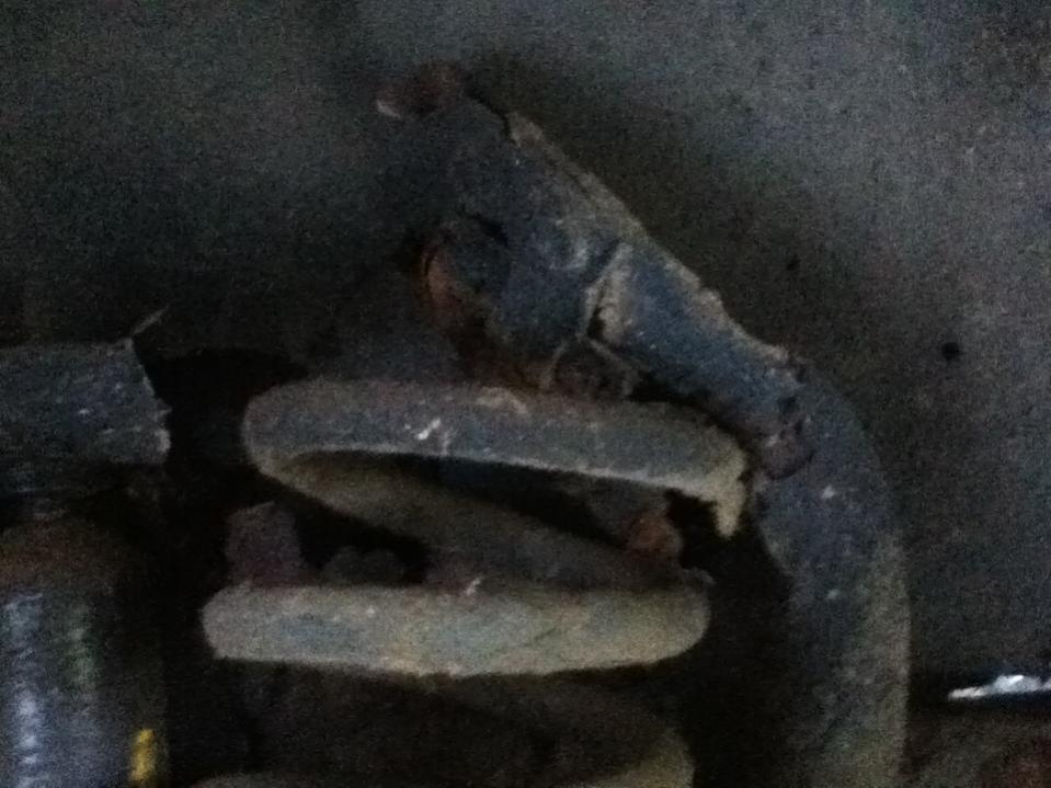

so as it says in the title my '94 f150xl has its front passenger side suspension bracket (riveted to the frame) basically destroyed, it cant get any worse in my opinion. so can this part be replaced? if so whats the technical name for it and where would i purchase such a piece?

Some call them a spring perch, but more accurate would be coil spring tower. If you can find a salvage yard with a donor, they can blow the rivets for you, then bolt it in place with some grade 8 bolts.
