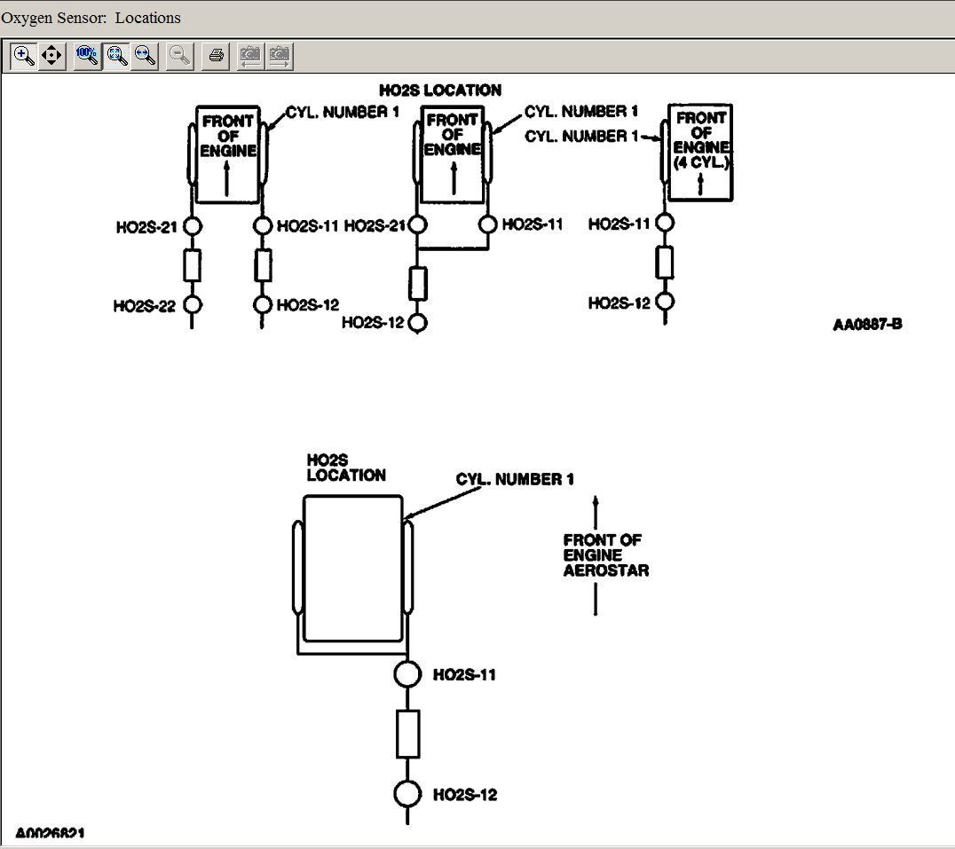

also which is bank 1 left or right?

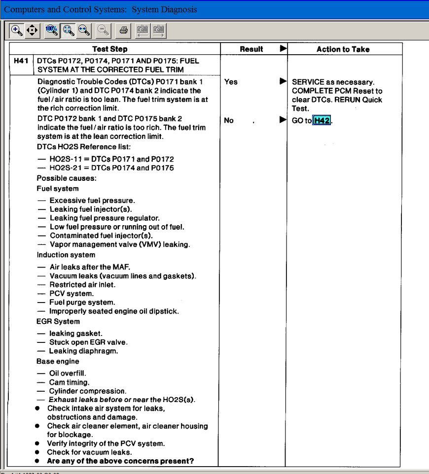

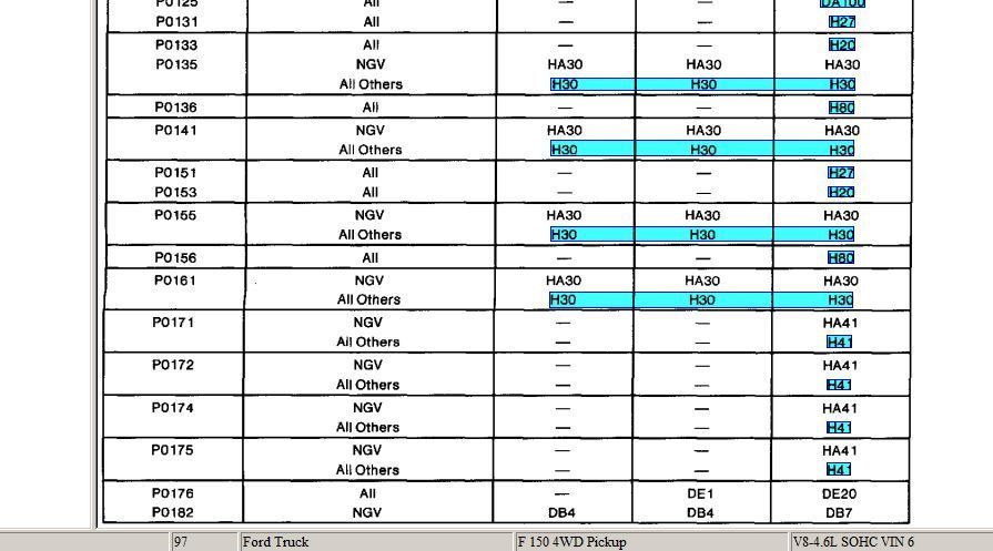

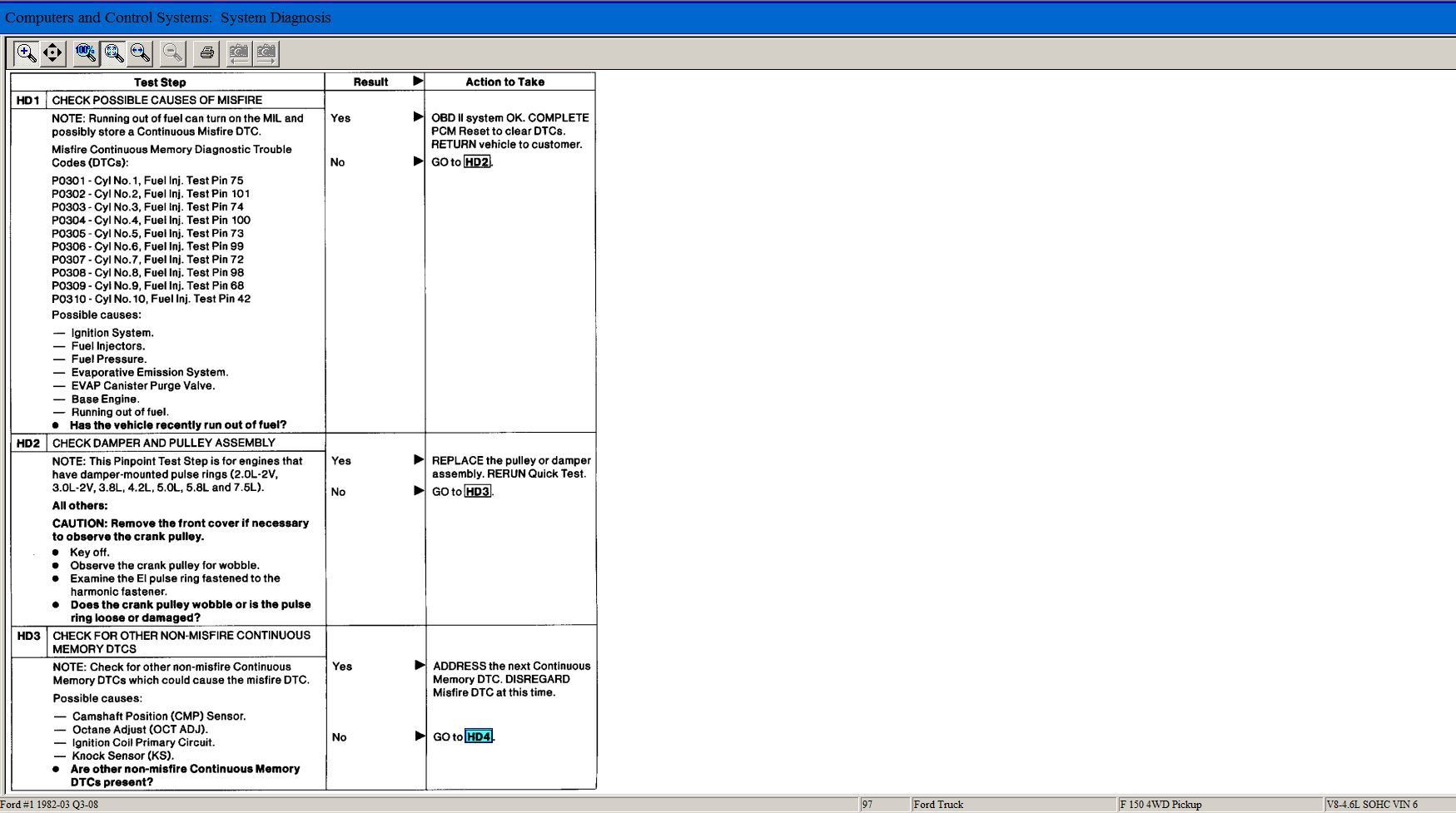

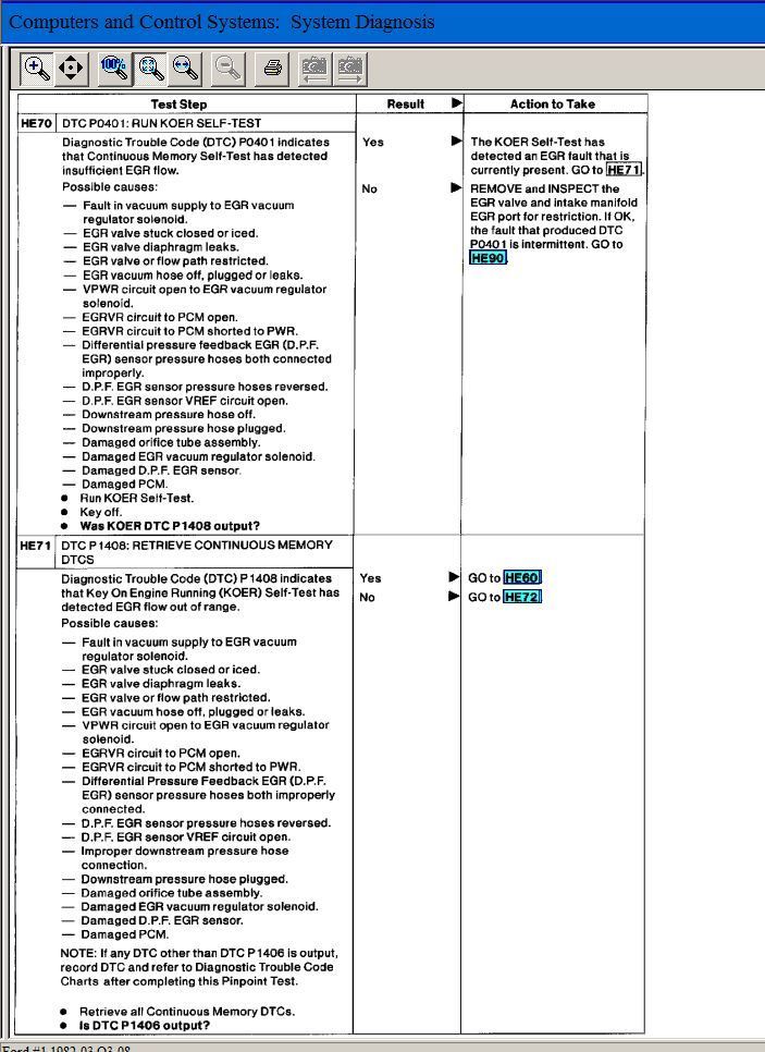

P0401 Below:
P0300 Below:
P0171 Below:
P015X Below, additionally, H20 to H28 and H30 to H37 attached below in zip format:
o2 sensor location you requested below:
If all of a sudden so many errors showed up all at once, it can be a problem with poor ground.
