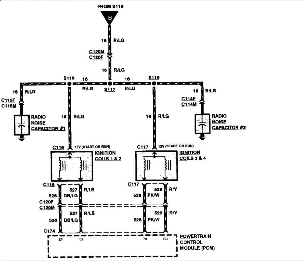

Did you check, with the test light, if you have power coming to the coil with the key on ? Yes/ No ?

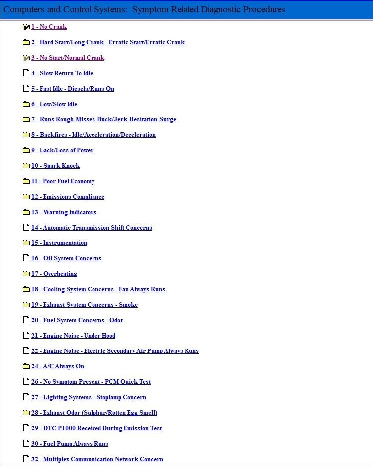

Old Jul 23, 2024 | 04:47 PM
Posts: 1,267

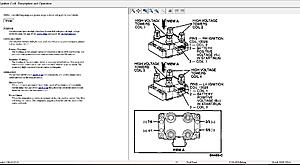

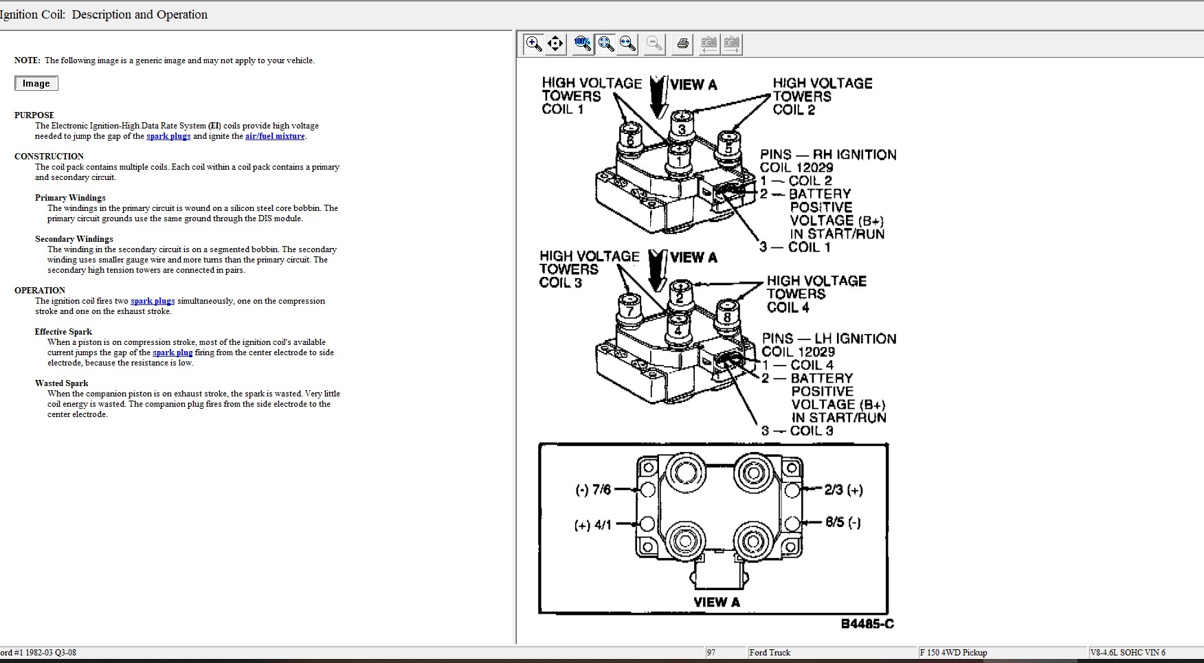

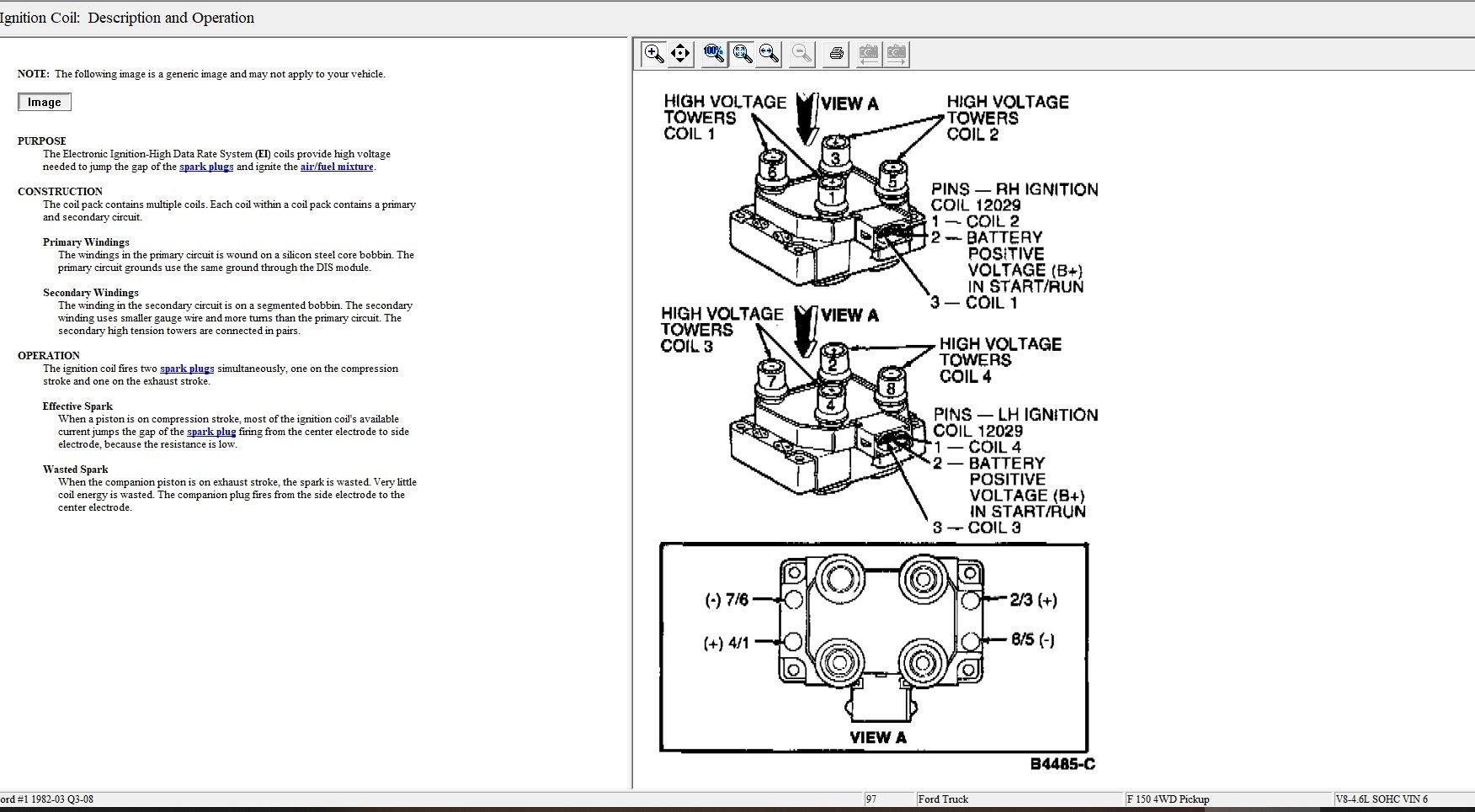

yep have power to coil and colis Ohms out

so far this is what i ave:
12 + volts to coils
both coils ohm out at primary lL . c-l 0.7 c-r 0.7 sndry 1/6 13.4K 3/5 13.3K
R c-l 0.6 c-r 0.7 sndry 8/2 13.3K 7/4 13.5K
Injectors all ohm out at 14.4 -14.8 ohms w/ all at 12+ volts..

How about your spark plug wires, you checked them?
Check Computer_Control_System-Diagnostic_Procedures.pdf for more details.

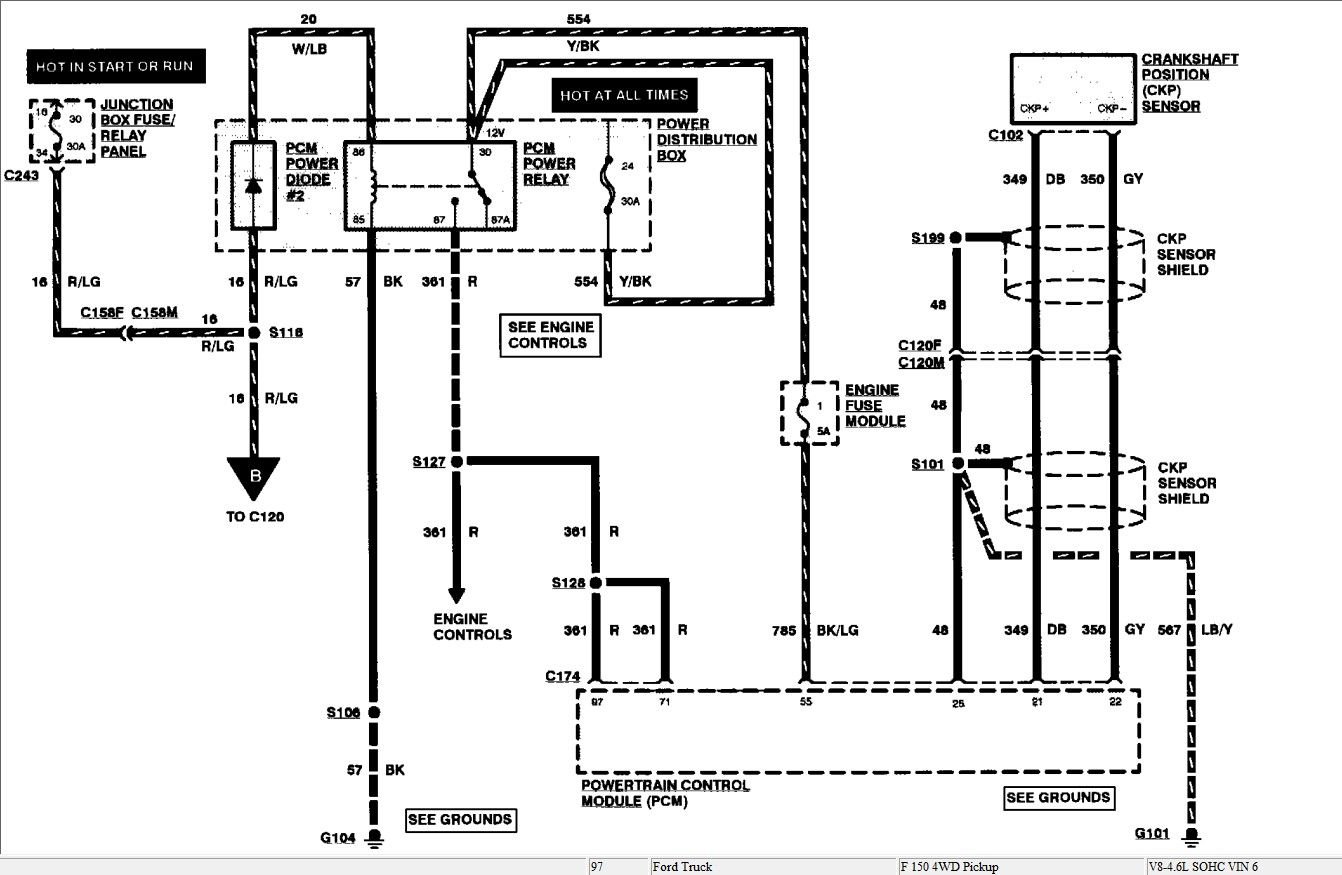

We verified we have power coming to the coils, right ? The next thing we need to know , is the ECM getting the signal from the crank sensor. You can check that partially with an ohmmeter. It should show continuity, . If yes OK, if no, replace it, then it should start.

A little tip, crank sensors when defective or malfunctioning don't always throw codes, so forget that. Misfires , YES !
