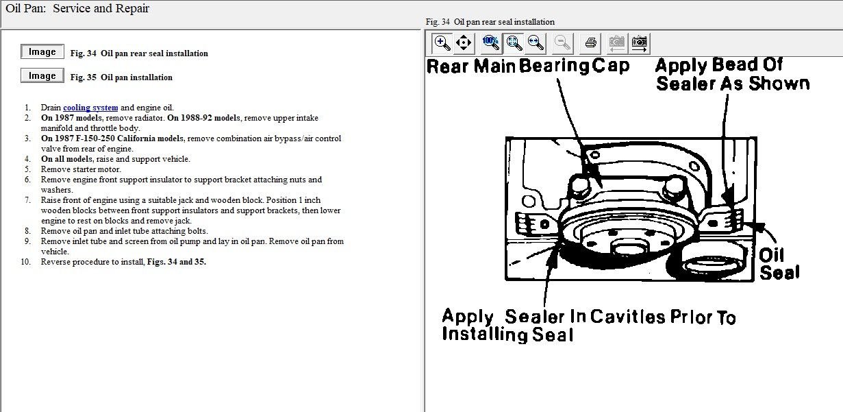

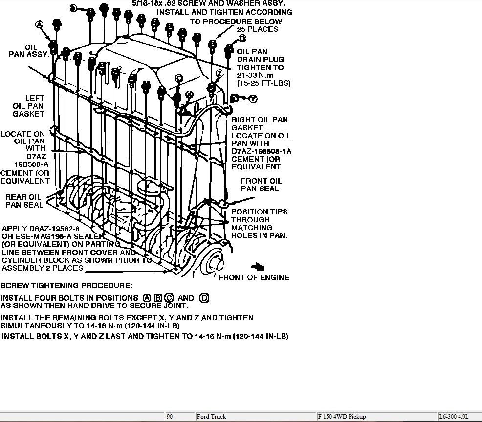

Old Nov 15, 2024 | 01:16 PM
Posts: 1,267
Old Nov 15, 2024 | 03:38 PM
Pablo_2005's Avatar
Joined: Jul 2024
Posts: 10
Originally Posted by heiko
I followed those steps and didn’t really work
Old Nov 15, 2024 | 03:57 PM
Posts: 1,267
As long as there is no leak from oil pan gasket (yours can be reusable), how about forget dropping it, just buy the oversized drain plug kit and retap it. The kit should come with the new drain plug in correct size and thread. It's not like a tranny with filter inside (unless you externalize the filter) and without drain plug.
