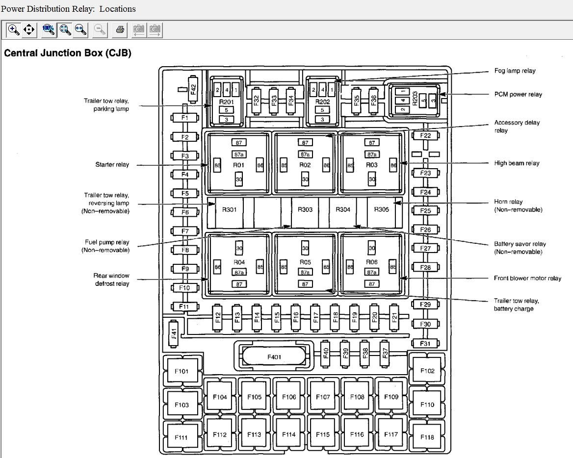

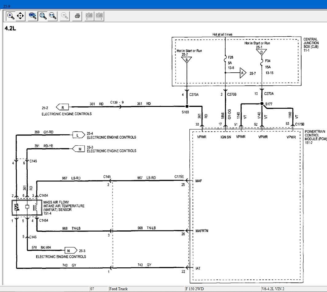

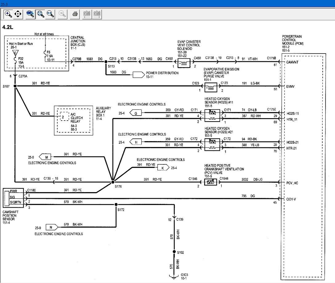

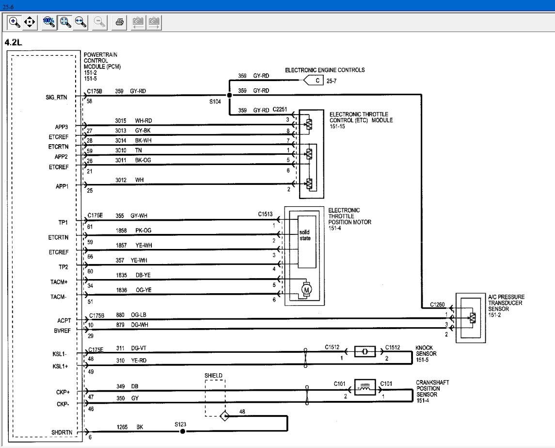

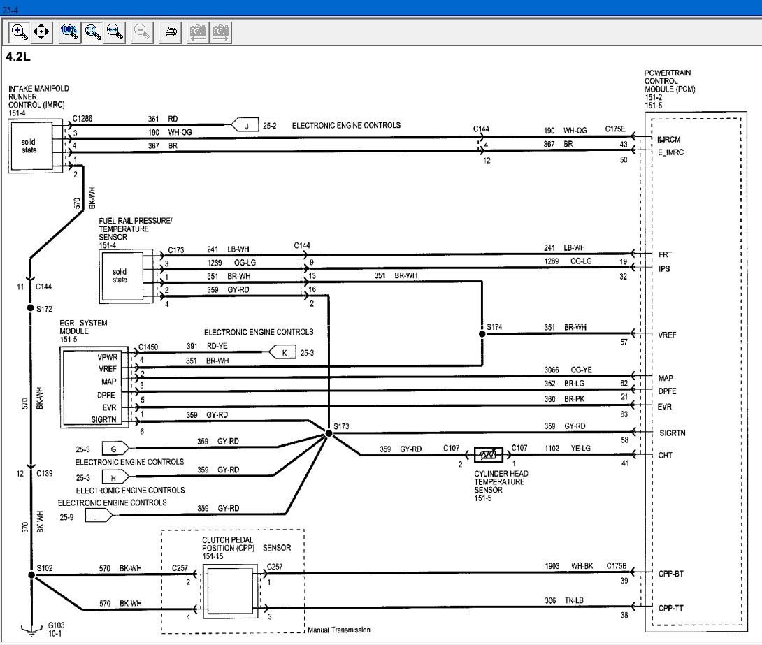

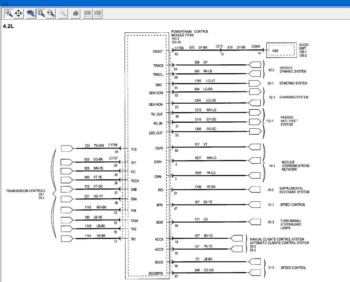

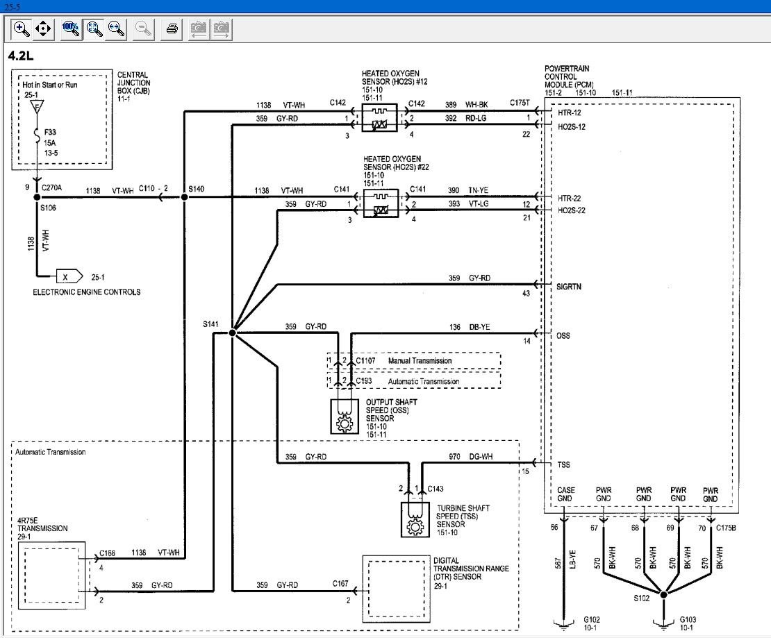

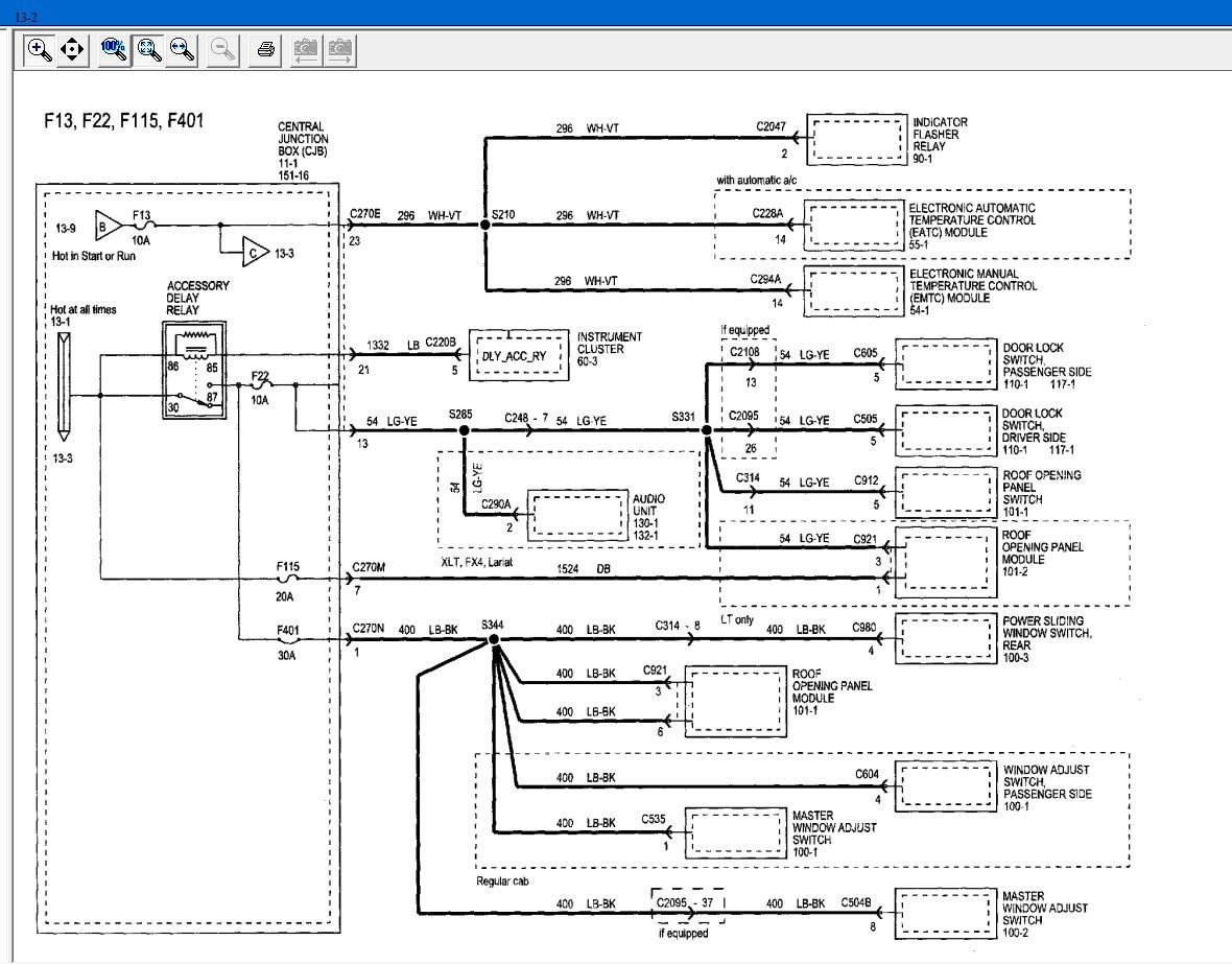

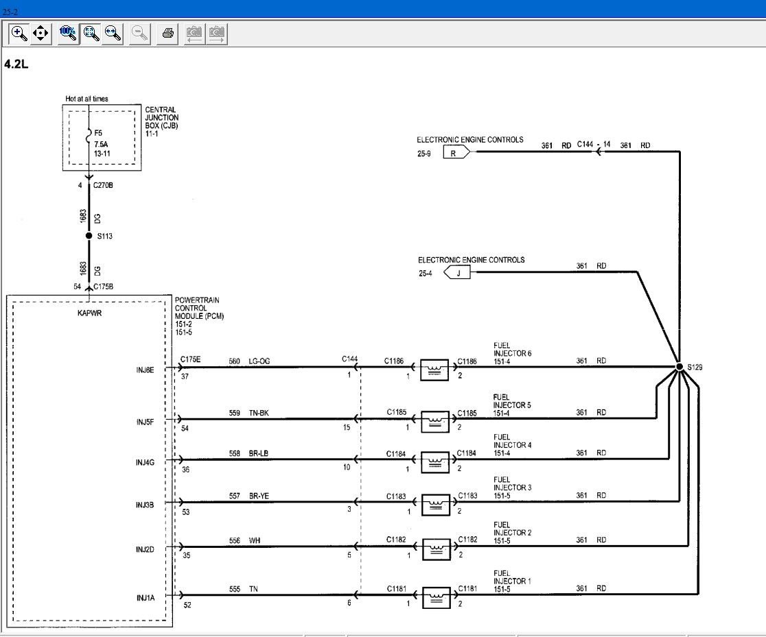

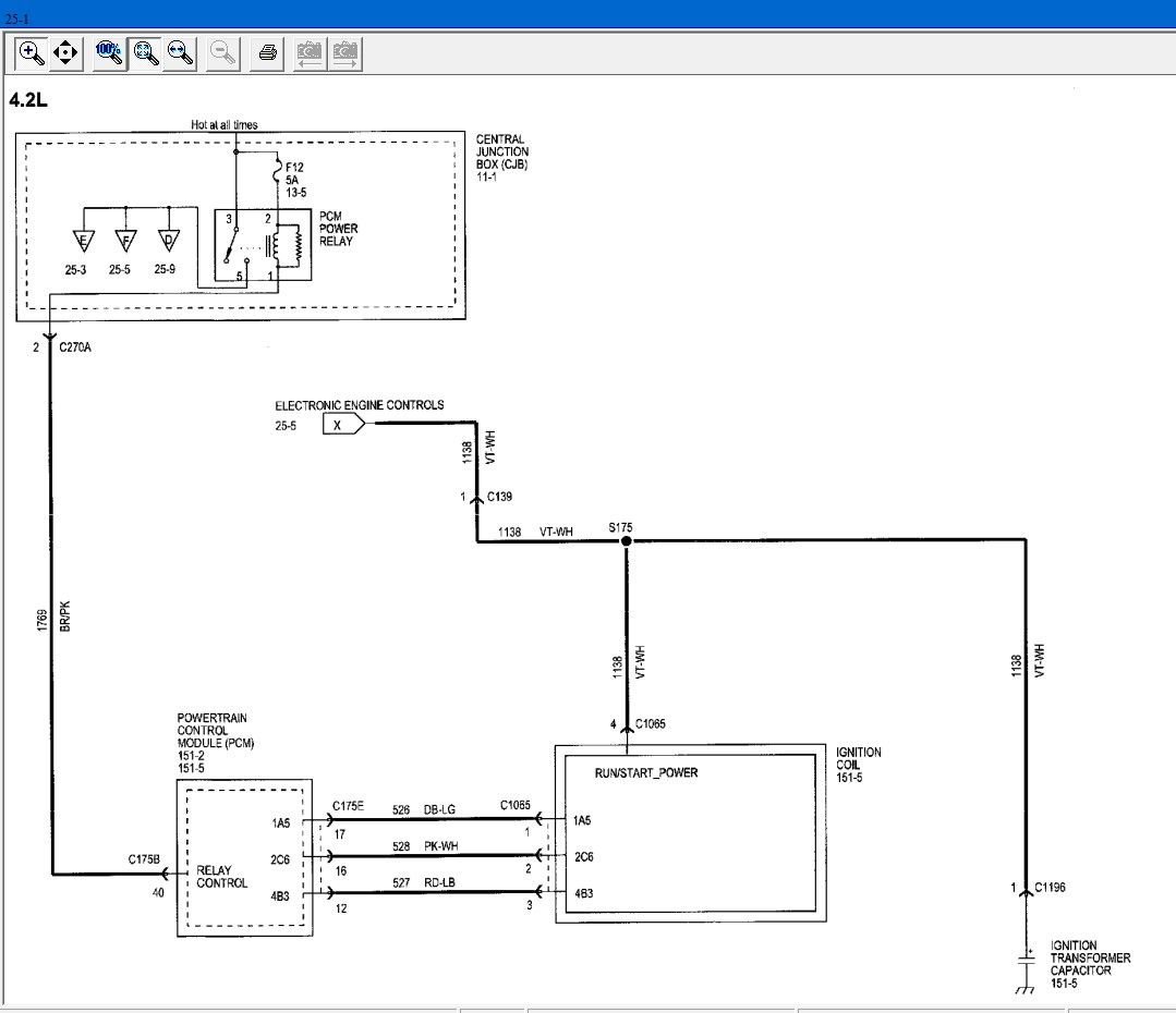

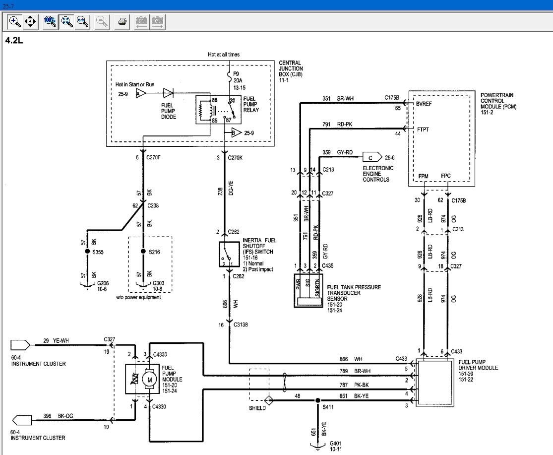

HI guys , thanks for the info for that diagram for IGN SW . now i am looking for a FREE version of the PCM PIN OUT for PCM 7L3A-12A650-FMA PCM model # 6HXD2NAA03
PCM221 MRKO 6J02 want to be able to trace down a few wire like all pcm wake terminals run ,
and keep alive and grounds,fuel pump ect....i just want to be sure every thing up to snuff and to be able to rule out each module- relay -fuse and trace wires in the harness. thanks in advance for any info
Old Aug 19, 2025 | 12:32 PM
Posts: 1,280
Note BCM is controlling all that, not PCM. And the accessory delay relay activates when ignition is off. And the delay timer is not adjustable/cod'able with IDS/forscan. If you need to run custom applications you need to add your own timer or bistable relay.
