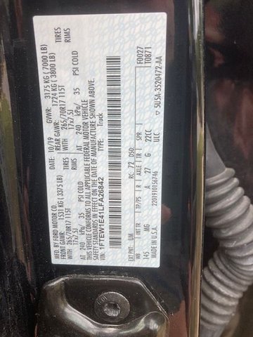

looking to buy a camper and want to know what the tow capacity of my truck is but i cant seem to find much on ford and camp world says the capacity is 7300lbs which i feel like is rather low. this does not have a tow package. any ideas out there?

Looking up your VIN,
2020 F150, 3.5 GTDI, CC, 4x4, 331 axle, your truck has a 7000 GVWR as noted/imaged on the VC label.as 'GVWR' and would be the MAX vehicle/payload the truck can carry, keeping in mind axle F/R load ratings. Also, any gear. passengers etc that tip that weight scale
The GCWR (combined vehicle weight rating) is 16,100 lbs, and would be the rating you'd want to follow towing, as a combined vehicle/payload/trailer for the truck loading totals..
The Curb Weight on your truck is 4946, or 5108 depending on package/build.
.A good rule of thumb is to have it 'cert' weighed 'wet' and any add on boxes. racks. mats or ? that may inflate the Curb Weights. As well as individual axle weight/s calculated (if in question), and trailer (loaded) weights taken to be certain you remain in GCWR.
