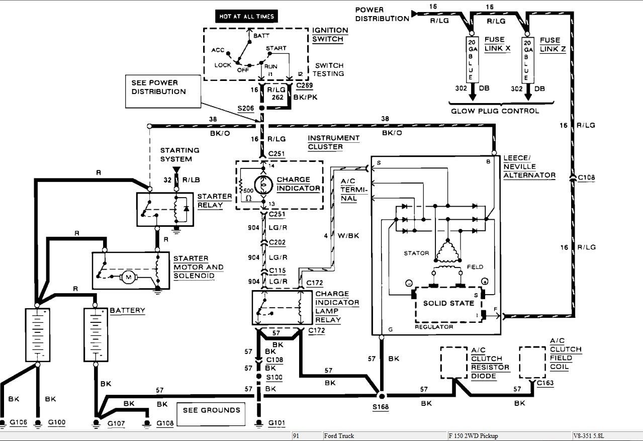

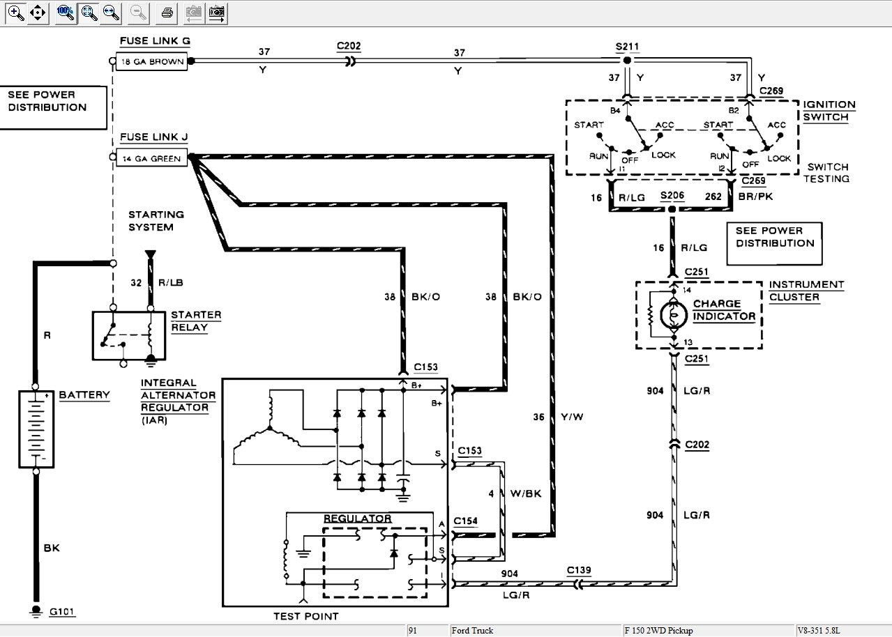

Single battery above, dual battery below.
