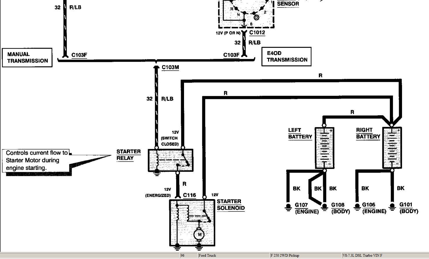

You said no crank look at the diagram below and locate the "starter relay" on the left of the diagram:
When it's no crank no start again, above diagram locate circuit 32 (R/LB - Red/Light Blue Wire) at the relay terminal and connect to the red lead of your voltmeter, the black lead of your voltmeter connects to the engine block with good ground.
Find a helper and crank, what voltage you get at your voltmeter?

By the way the diagram previous to this post is inaccurate.
It says the starter relay is closed when it is not closed in the diagram. ..

Ok with key on and wait to start light off, I jumpered starter relay posts and get click but no crank
That, I believe, shows that it's not the relay that's bad...is that correct??
unfortunately i have no second set of hands to crank while I read voltage...I'll have to get some long leads to bring vm into cab when i crank
but when I have key on and read voltage at the input lead to the starter relay I only get 4 +/- volts which seems weird...
bad ground somewhere?

You are not supposed to test the relay yet, you are testing just the trigger wire to the relay, the very first step. Just testing the R/LB wire for now while cranking.
If you get 12v while cranking in START position, what voltage you get?
If no voltage at all continue to step (2) below:

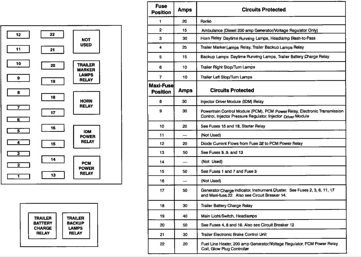

2) Check fuse no. 5 at engine compartment fuse box it's 15A as shown below:
Is the 15A fuse blown or not?
