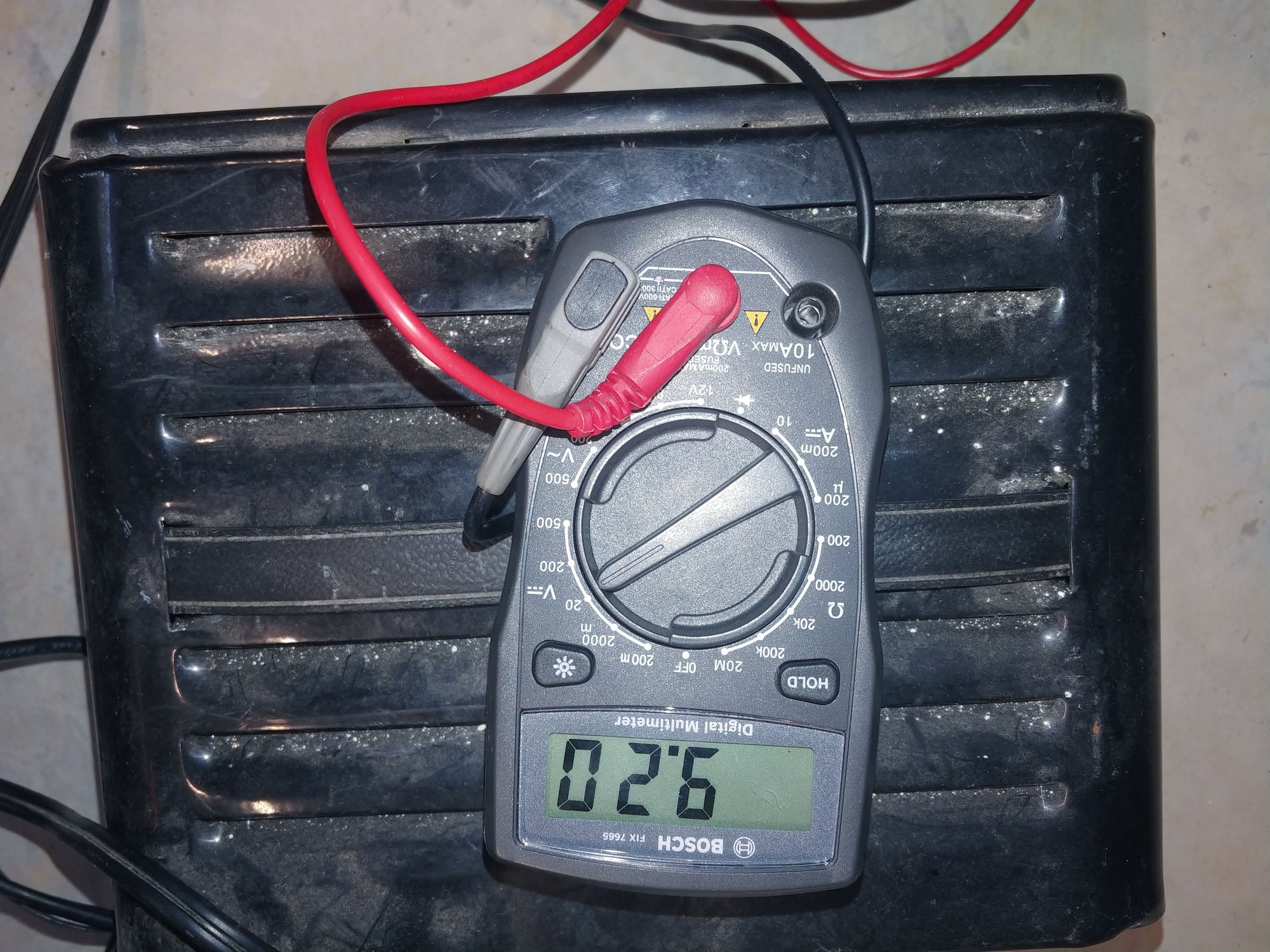

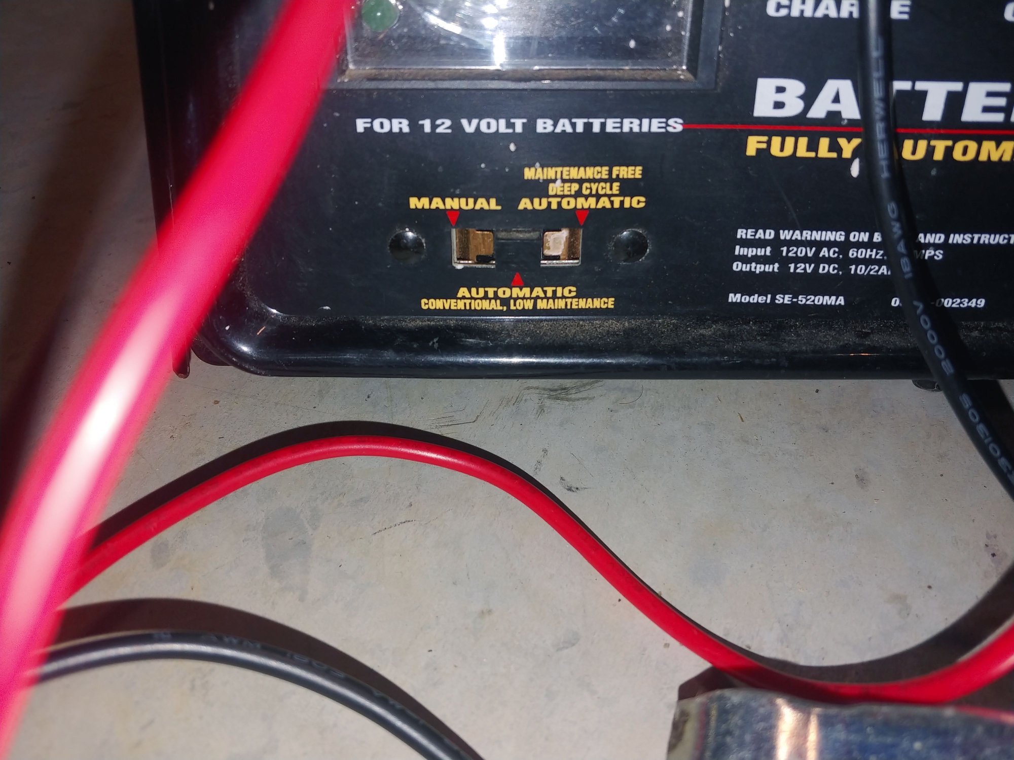

what am I missing about chargers or meters?
granted this isn't about the original post, just an anomaly I figured you smart guys would know something about :-)
I assume throw this charger away?
set to automatic
the first time I connected it said 12.0 now 9.2 wtf

Hi Marko,
I believe you are trying to get a reading of what/how much the charger is pitting out, correct?
Your meter leads should be plugged intonthe10 amp connection of the meter.because you want to measure amps.
When measuring current (AMPS) you need to use the amp function of your meter, OK.
After placing the RED lead in the10 A socket on your meter and the black lead to common of your meter, just place the charger black lead to your meter black lead and the charger RED lead to your meter RED lead. That should give you the output of the charger. OK. The current must be connected in series with your meter.

Hi Marko,
So it should not necessarily show 12 volts DC when it's supposed to be a 12 volt charger?
