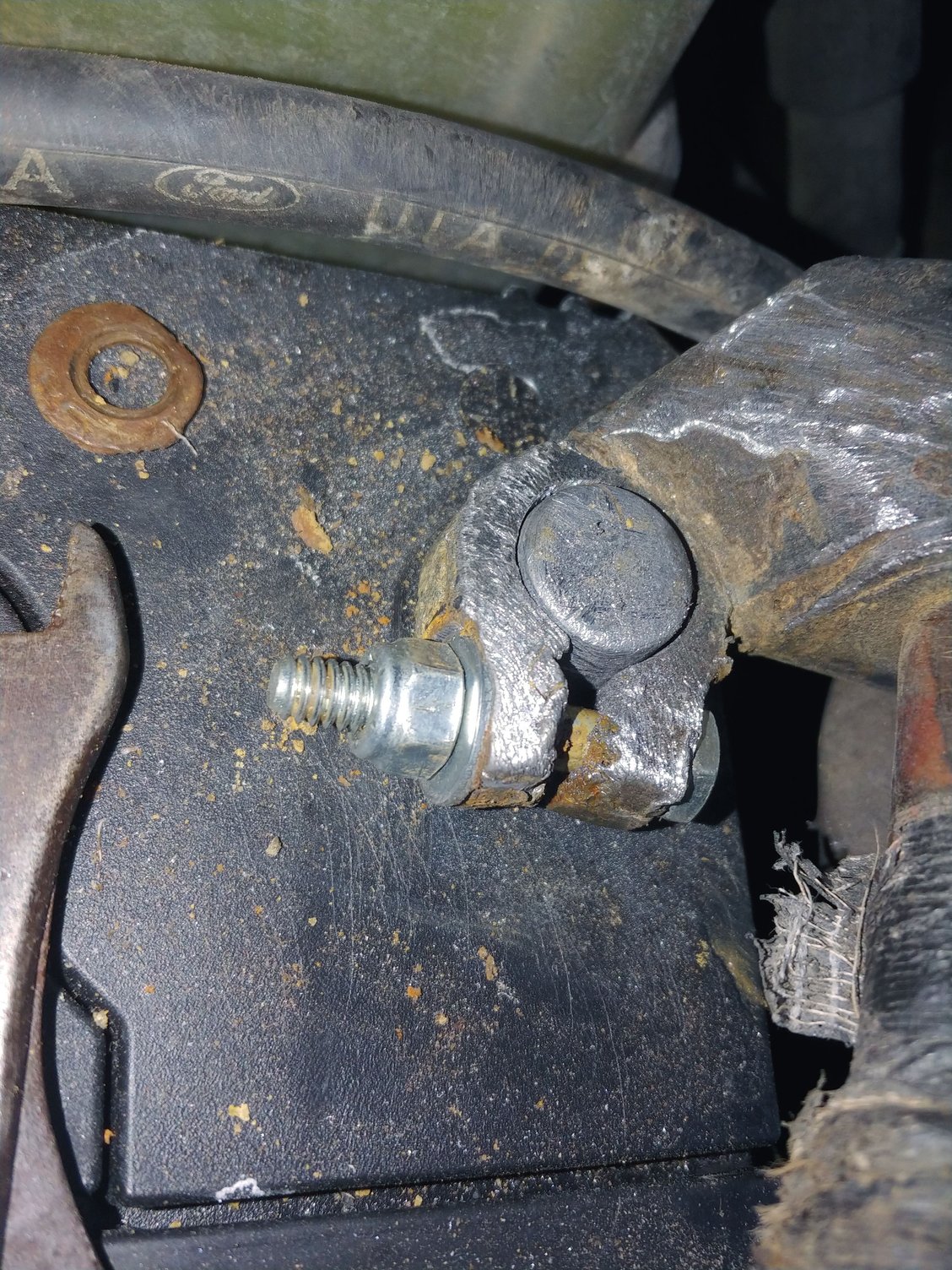

If you still get 12.60V at the battery, but the terminal at the blue arrow you get 12.58V or 12.59V that's barely acceptable, you get 12.57V or below after deep cleaning you just have to replace that bad cable. This time you know no cranking no key needed. Please note you are not even testing the resistance with ohmmeter. If the terminals at the battery are really bad and can't be cleaned, try to cut the terminal and replace just the terminal if the cable length allows you to do that. Personally I use hydraulic crimper with bunch of different terminal sizes because I make my own cables all the time. Your red cables should be either 2awg or 4awg. No car makers use thicker than 2awg unless it runs a long distance.

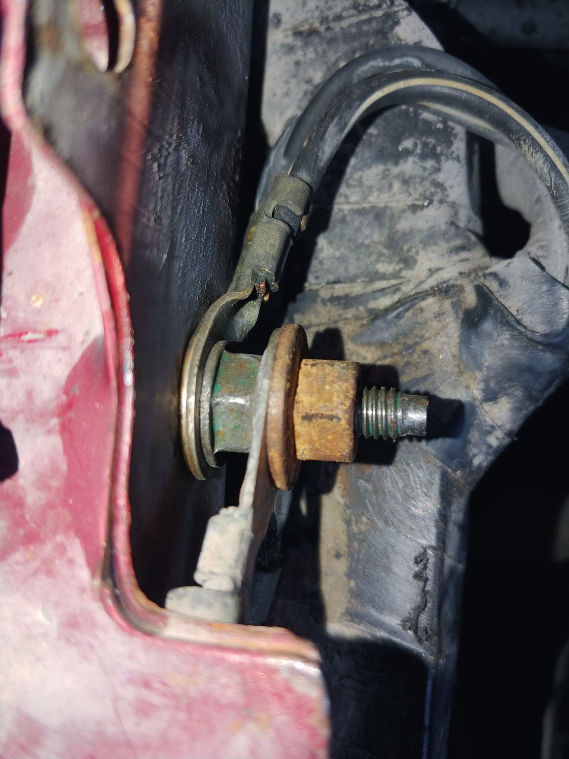

G101 Below:
G108 cleaned and reassembled

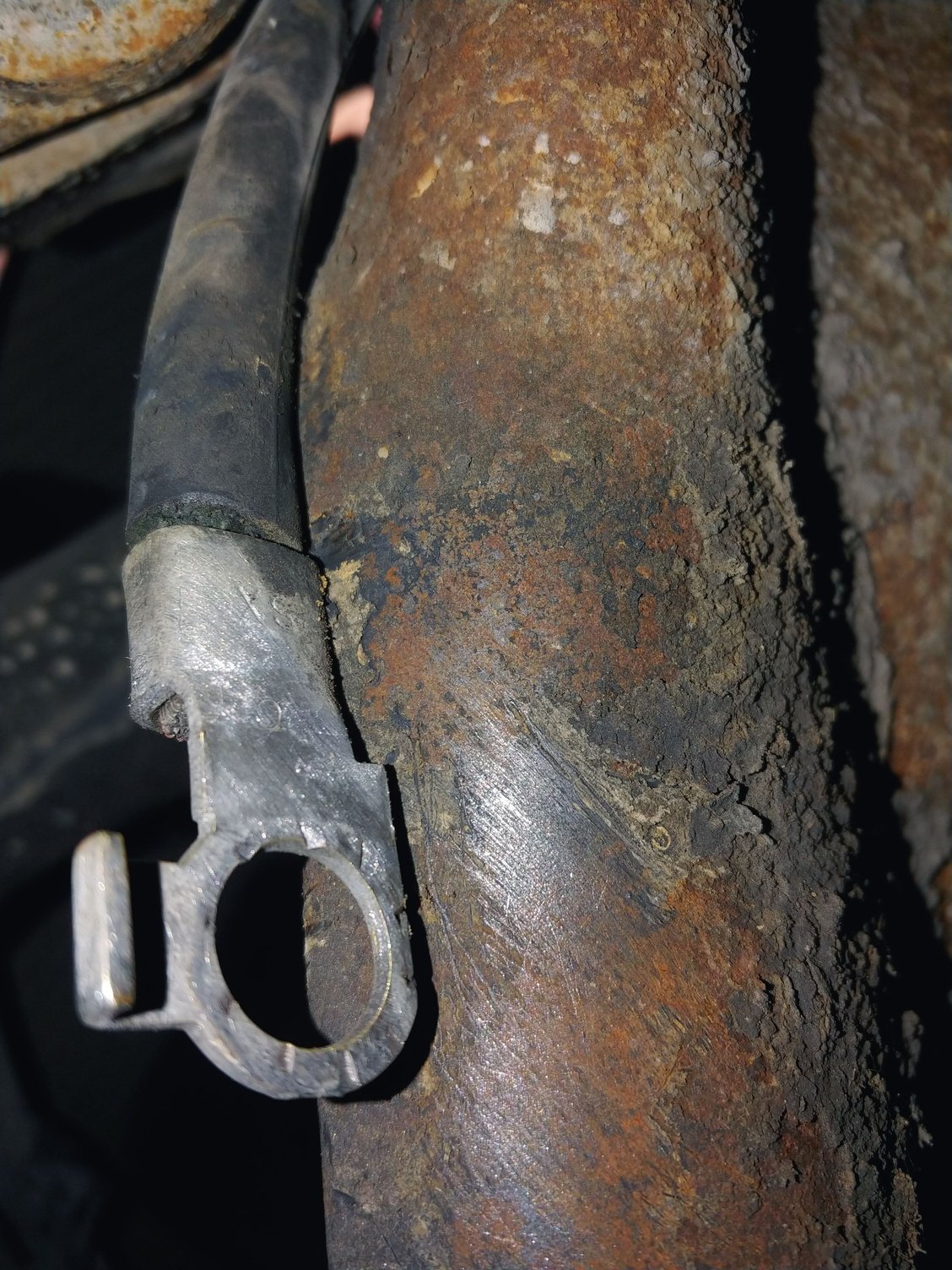

G107

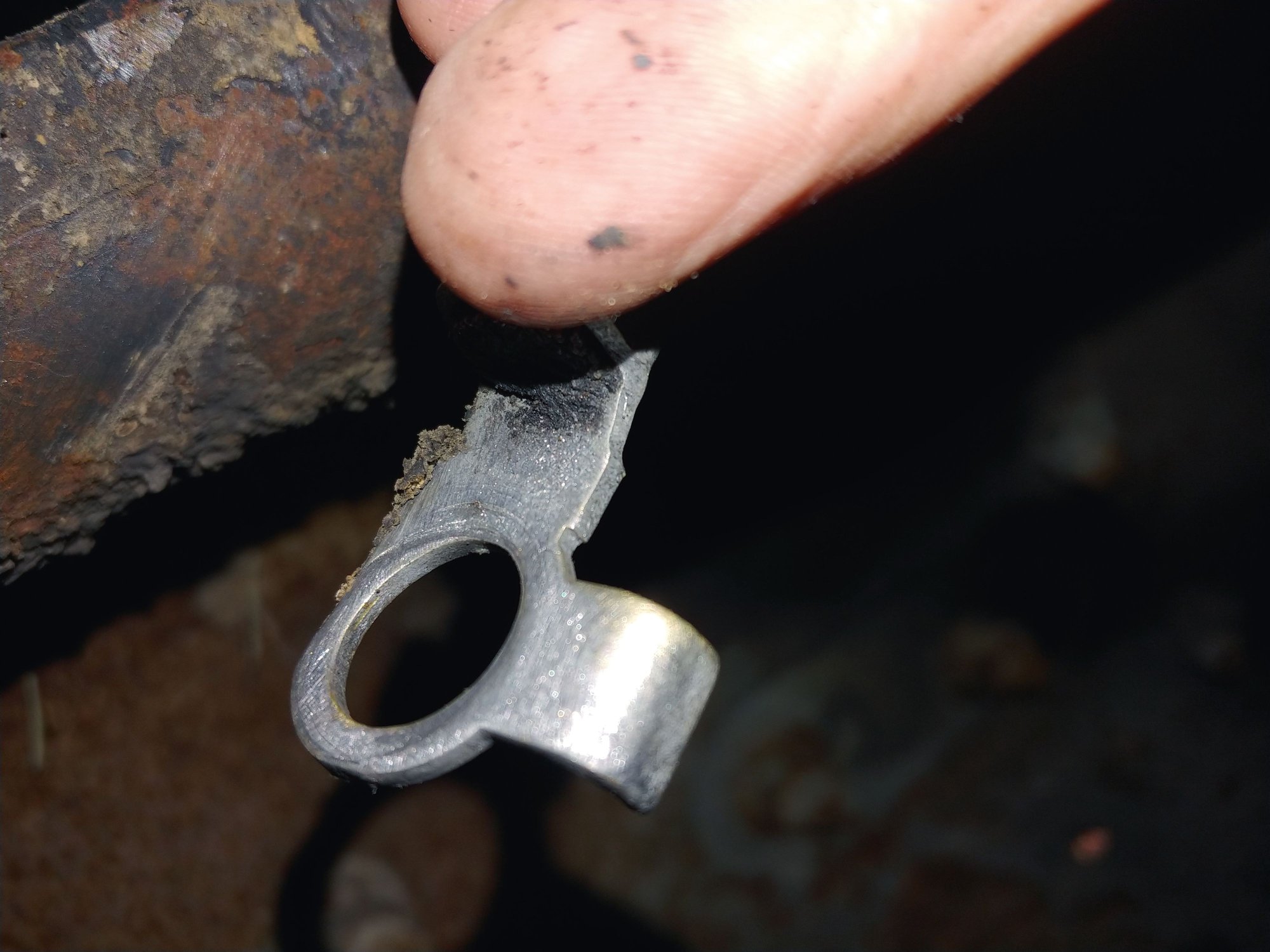

G107 clean
G107 back on

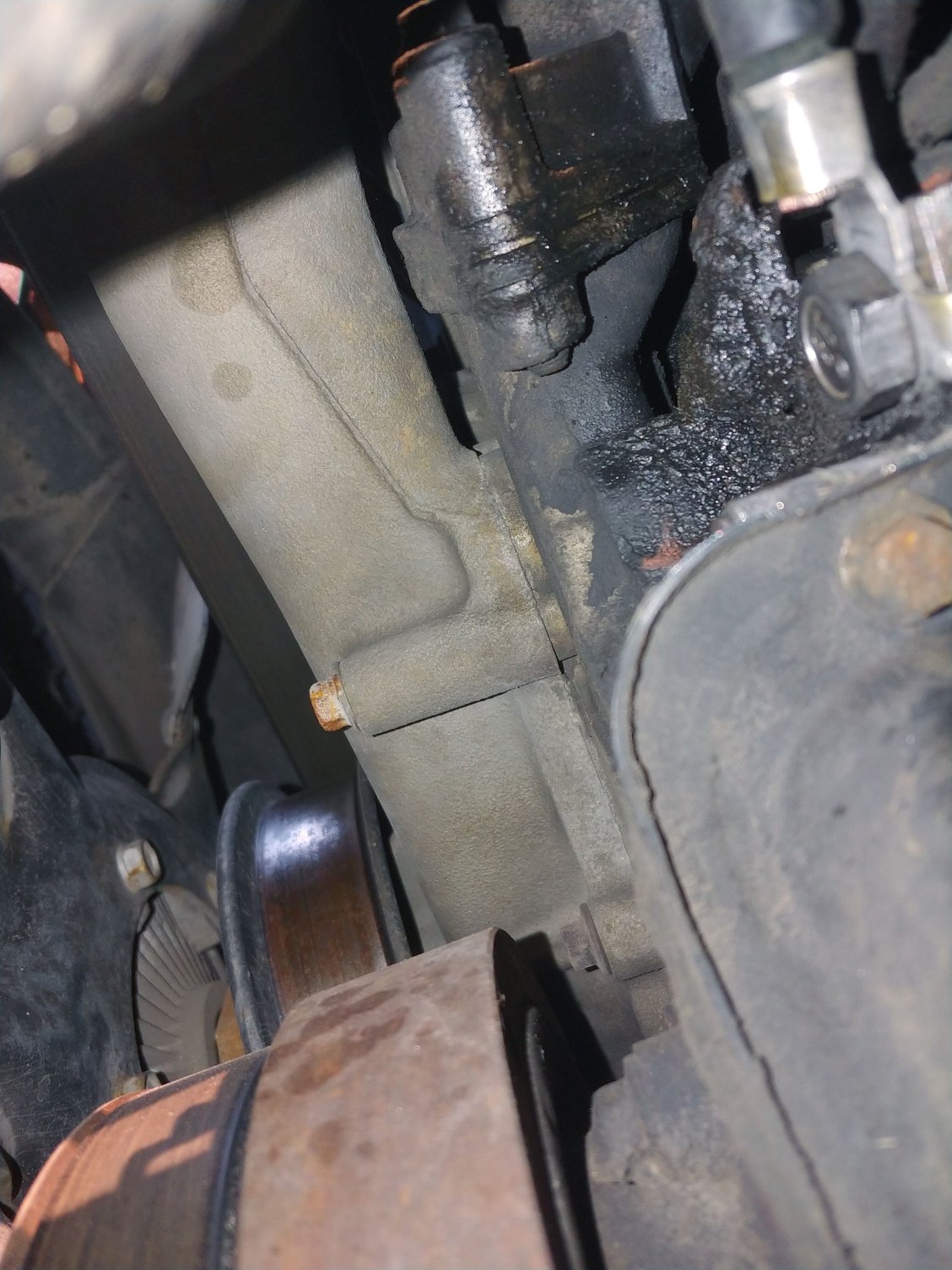

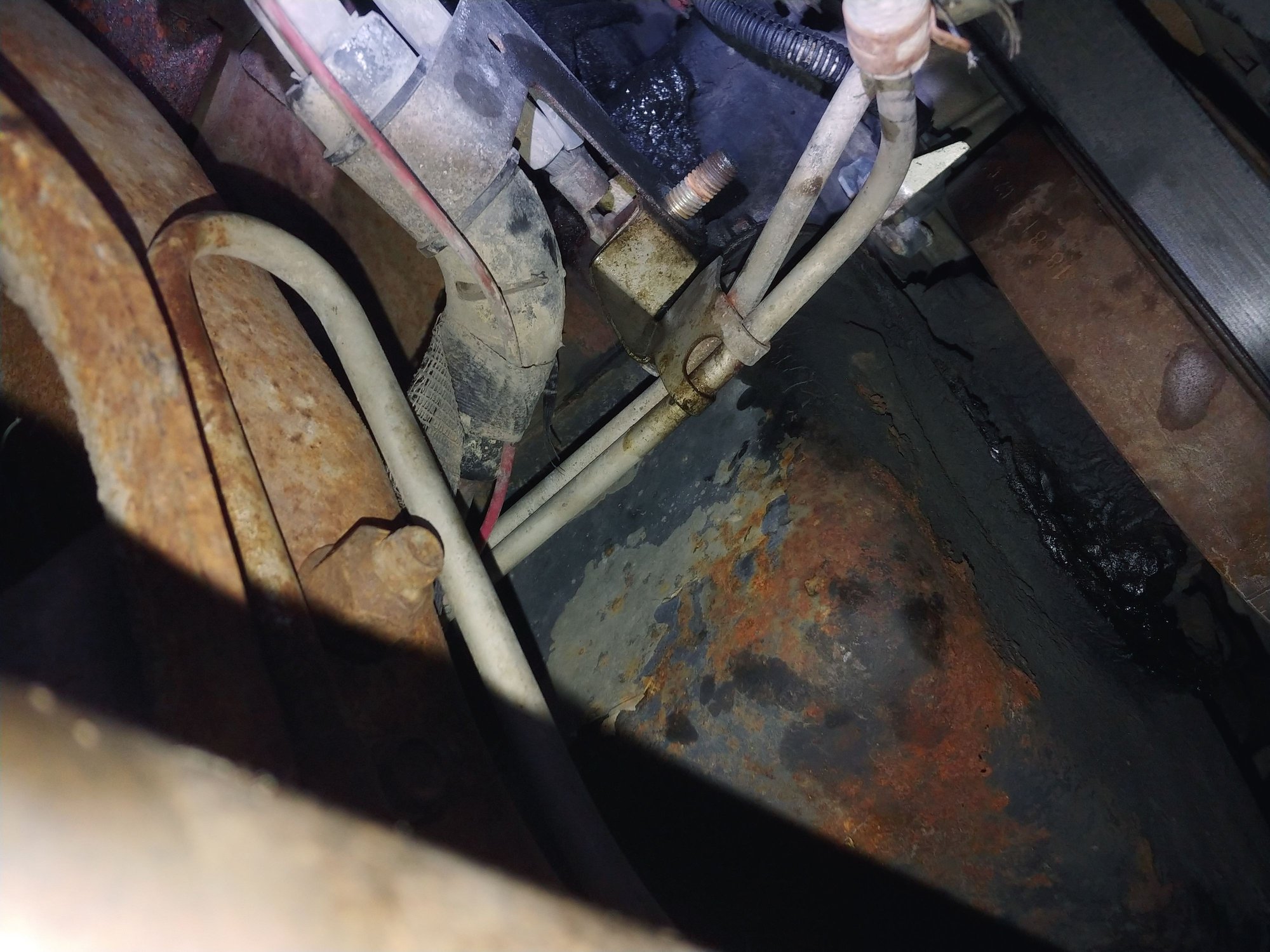

G106 buried by metal brackets holding lines
so i got 107 108 easy but 106 is on a stud with two brackets holding hoses/ steel lines on top of it so I'd have to pull all that off to get to the ground wire
typical batt term

It would be good to go through the hassle of cleaning that one (G106). Not like it is a frequent job.

So I just got to get a pry bar or something and yank those things off of there? They weren't wanting to come easily... It almost looks like they're on a rubber bushing between the bracket and the bolt. I'm assuming that's a stud coming out of the engine block right?
Also of interest to note is the ground 101 does not come from the passenger side battery. There are two small gauge wires bk and BK/wt that connect from g108 over to g101 just going from one body bolt to another which seems weird. I'm thinking I should add a ground from the passenger battery over to g101 like the diagram shows.
