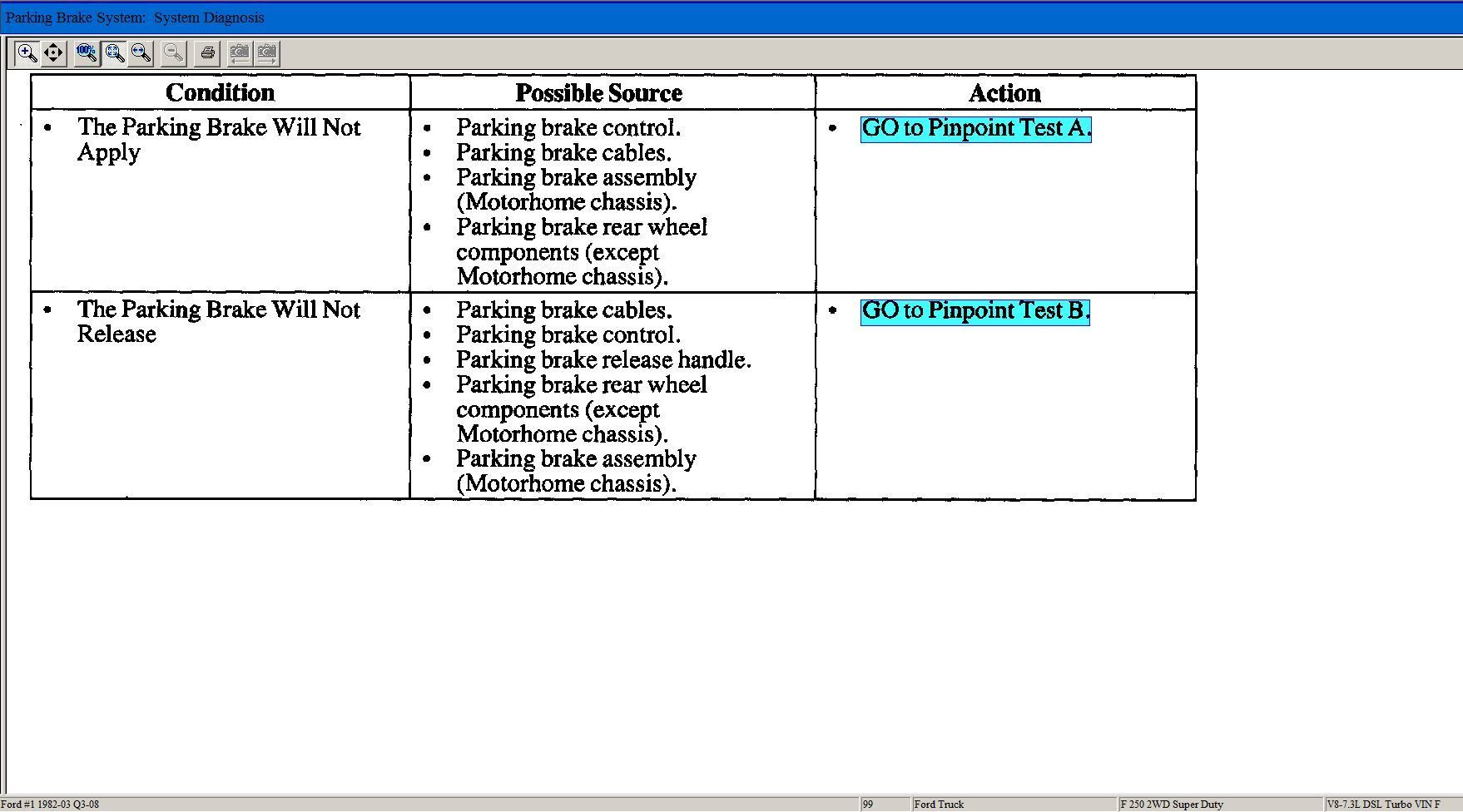

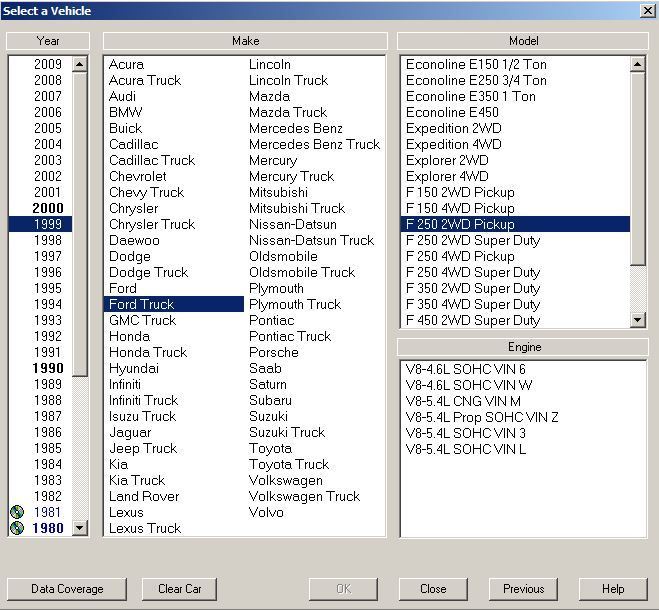

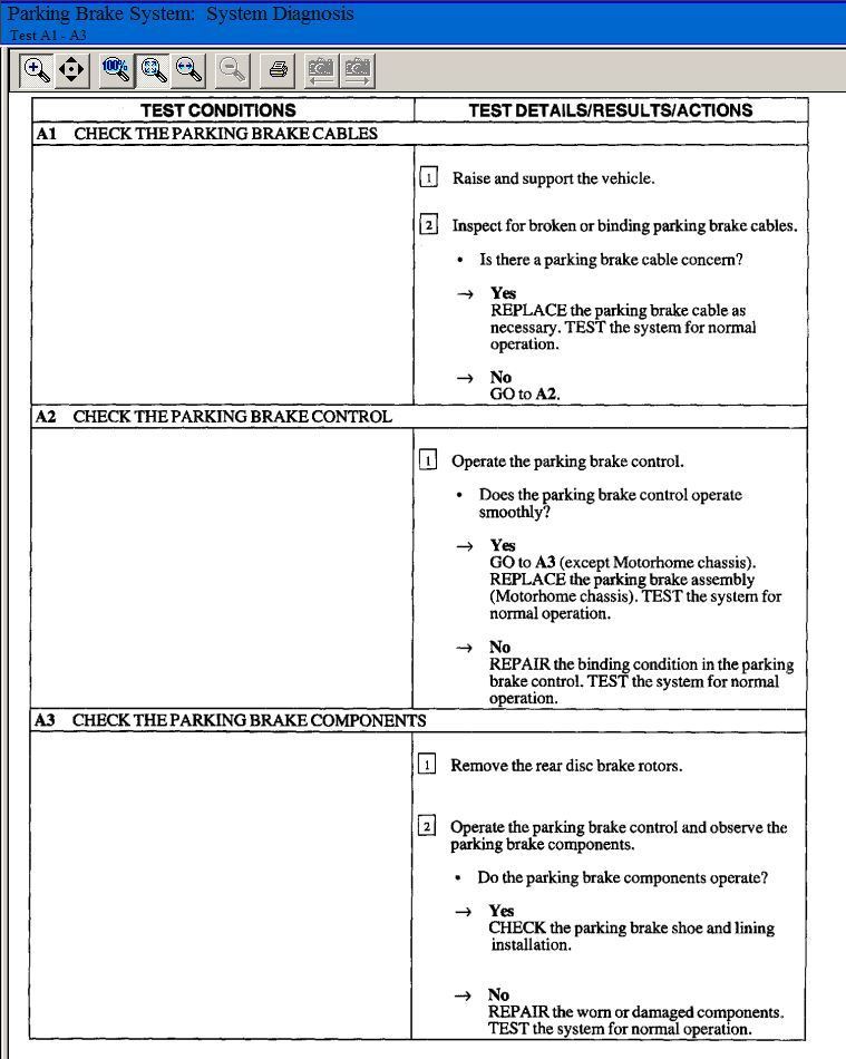

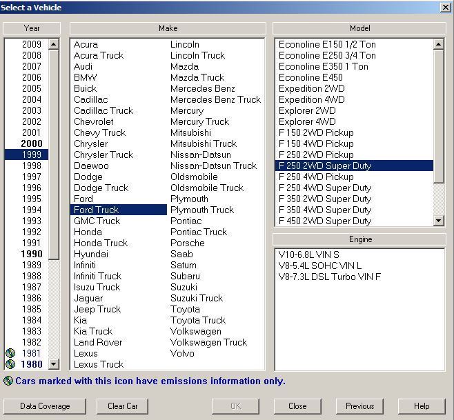

I asked "since when". Just yesterday? Since a year ago? Since day one you owned the van? intermittently?
If it happens since yesterday you just need to lubricate it. Check 2nd pdf below.
What is XLT with 7.3L? Look below it's NOT FOUND.
Now look below:
That said, you identify your truck as F-250 Super Duty, not XLT, whether you go AutoZone or you shop for auto parts online.
