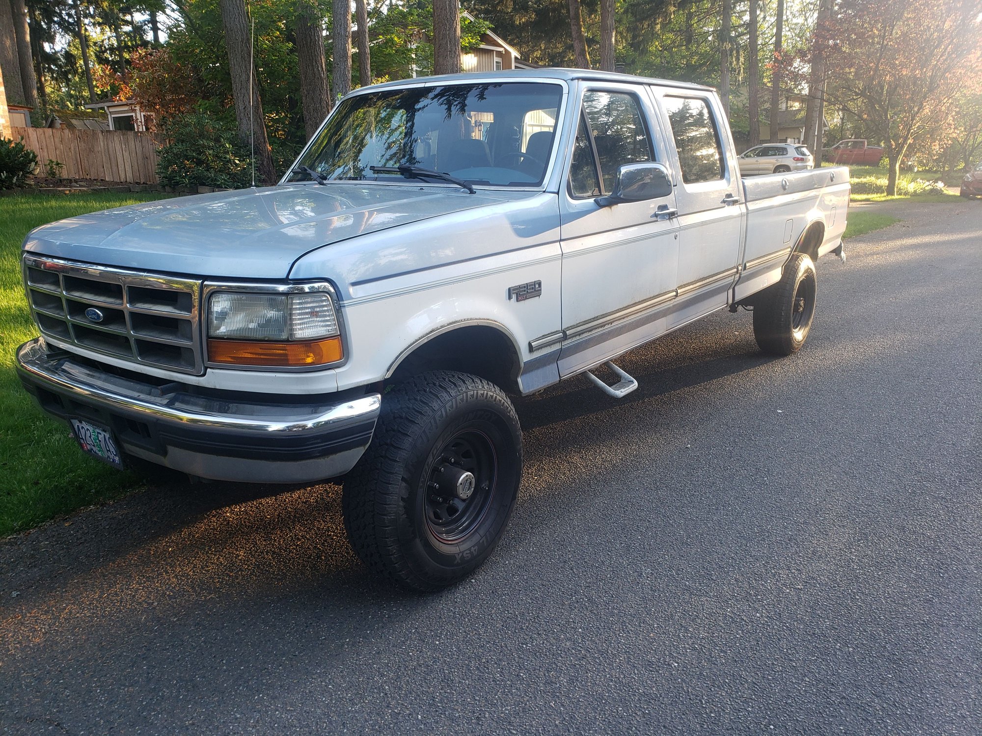

Hi all, ive got the an odd and unnerving sound coming from the front of transmission/back of engine. Its definitely rotational, and I wold describe it as a rotational grumble/whirring. I at first though it was a bad wheel bearings but after replacing that them it was still present. Checked driveline and everything looks good. Truck drives absolutely perfect but if I go up and down the road and let it warm up, as I slow down you can hear and feel the grumble. I really only hear it below 25 mph. If I go faster it goes away which I also find odd. It is not gear specific. Ive put it in manual 1 and 2 and you still hear it but there is no sound in reverse!? I took a video to capture the sound best I could.. Im curious if you guys had anything I should check out without pulling the trans. What really has me scratching my head is there's no other symptoms. No Torque Converter slip, no delayed or rough shifts, just this sound thats feels like impending doom 🙃
I am mechanically inclined so if its a torque converter or something I'll probably be dropping the trans in my driveway but figured it wise to ask some experts before fixing what may not be broken.
thanks guys!
** was able toaget the video uploaded below
