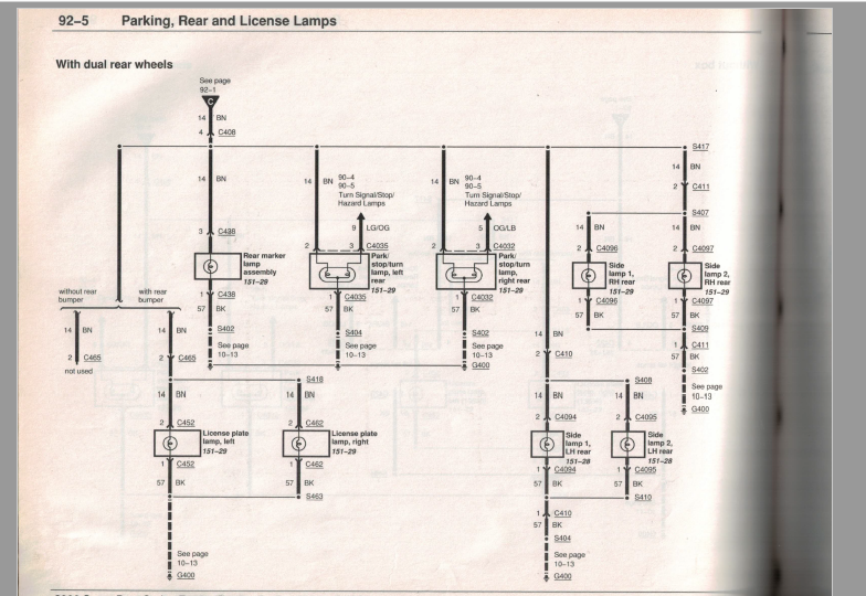

Might help to know if the OP has single or dual rear wheels.

My truck is a dually.

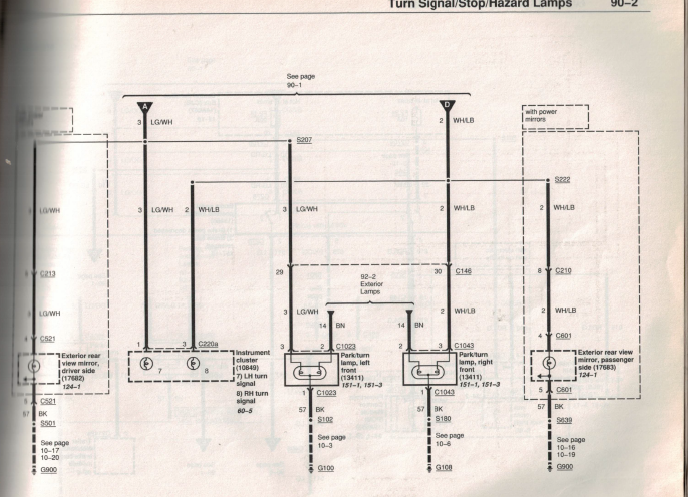

Will this do it? Not sure what else I have, lol!

All signals work. Both hazards (now) and turn.

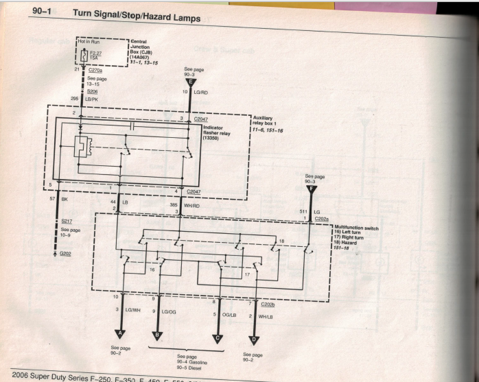

F, from page 90-3 comes from the brake pedal position switch. Fuse 2.18 feeds the brake pedal position switch AND it feeds the indicator flasher relay in the Aux relay box (reference "E" at the top of page 90-1)
I don't think that fuse 2.17 is shown anywhere else, and almost certainly not under any other designation.

bismic, I apologize for causing you to send so many diagrams. You sent the correct ones for the parking lights.
First we had a sig light problem ,now we don't. That's fine.
The question now is, do we have parking/running lights or not?
Is the fuse in question still blowing?
Seems every time we get close the situation changes.
Found some addl info, now need to know if vehicle has rear bumper ,,,if,,,,parking lite problem.

I have no rear tail or brake lights. And fuse 17 still blows.
