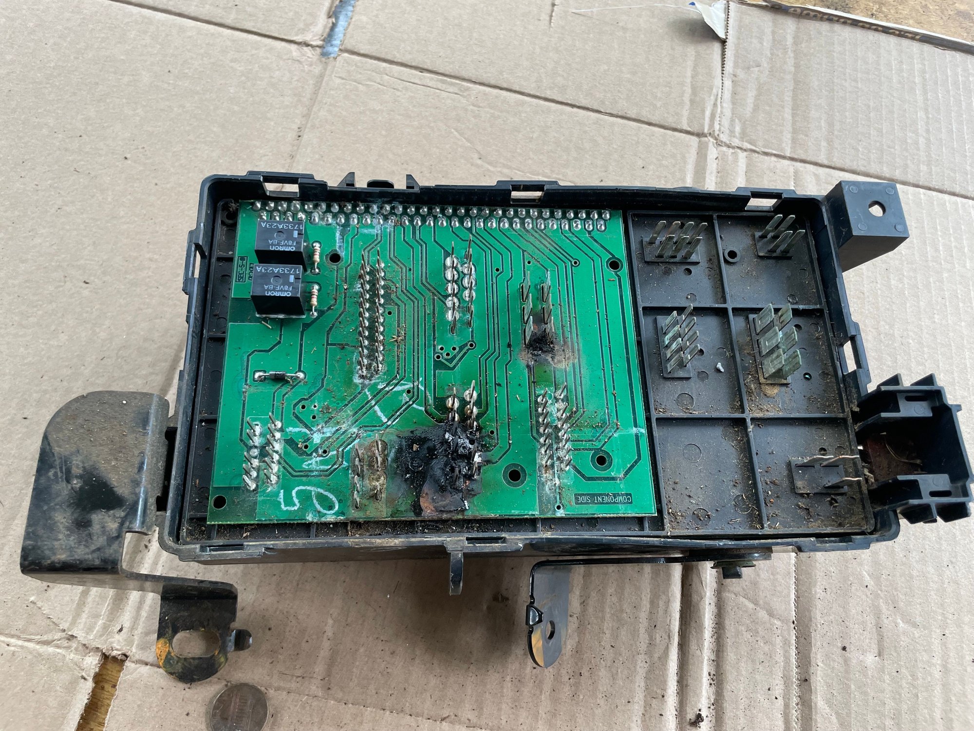

Damage to the Junction Box pcb is catastrophic, including several missing pins and damage to at least one of the connectors.
This is the worst one, the rest look fine. It still seats itself, but I guess I need to buy the box with the pigtails.

From the looks of that board, there is a larger problem than water damage.
Can't promise , but will try to look in my info to see what circuits might have been involved to burn it to that extent.
Maybe you already know, do you ,thanks.
If there was a problem with individual circuits, then it would be protected by the individual fuses, but if there was a short circuit inside the junction box, then that would explain the burning. I don't see any damage on the wires, even though there is burning of the same connector.
I have a new fusebox on order, including new connectors.
I suspect the large burn is from the fuel pump (#40) circuit. A few other blown fuses on 23 and 7, among some minor and some where I swapped a useful fuse.
