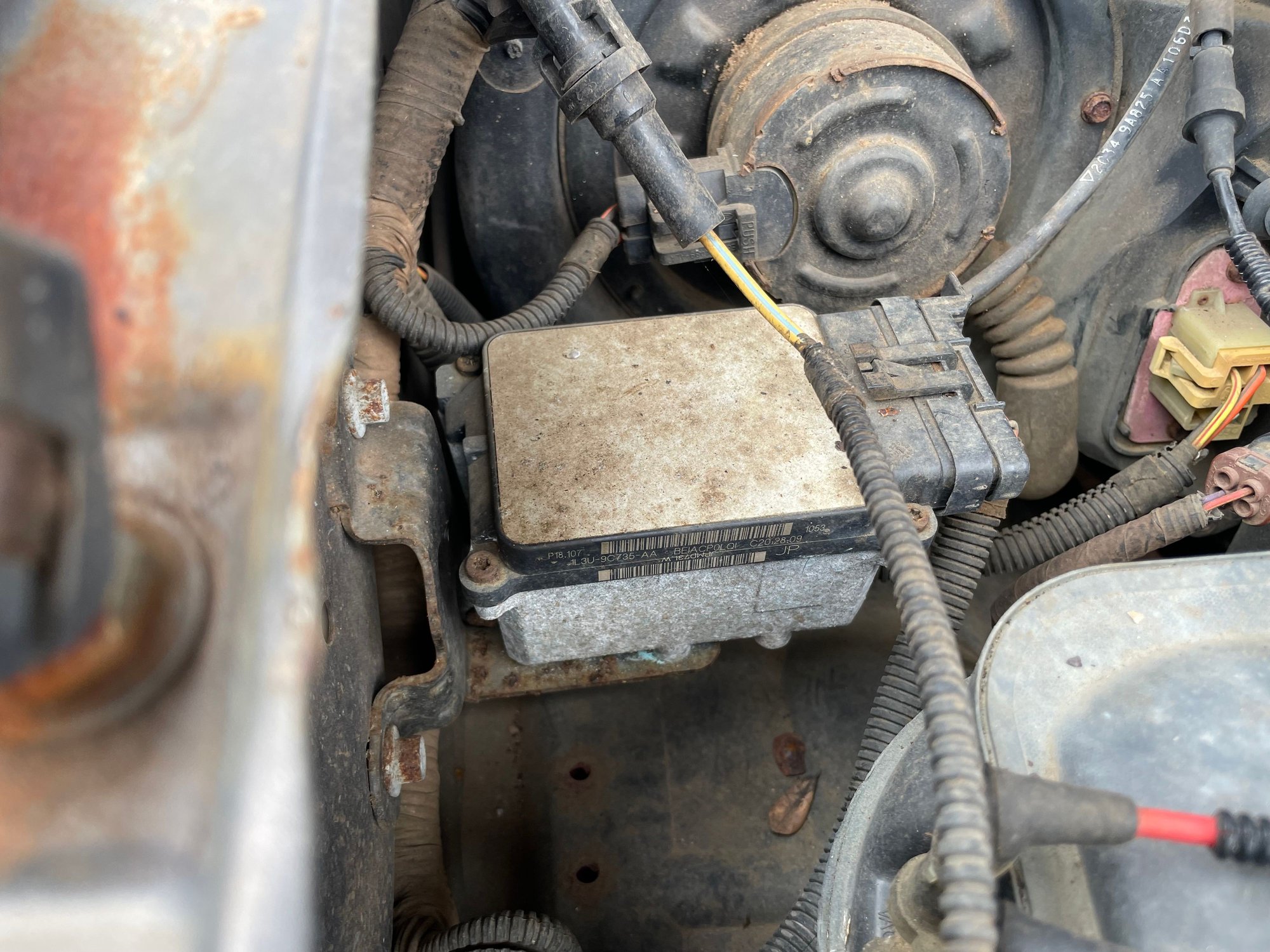

This is a good idea, though I'm thinking that there is more of a rat problem than a water problem. If a particular module was not getting power thats much easier to diagnose than when it has power and isn't working right. ie. no ECM, PCM, fuel pump, no start
There is another detail that I haven't mentioned to avoid overcomplicating the story, but I was waiting a month for an appointment to fix the engine mounts, so when I brought the vehicle in I added that it wasn't starting. They got it started and then replaced the engine mounts, and then they came to me with the transmission codes. I assume they pushed the car onto the lift, got it started, and then replaced the engine mounts. No one suspected such an issue. Then they drove it off and noticed the issue with the transmission. So, however unlikely, it is possible that the transmission issue happened while replacing the engine mounts. Doesn't change much either way, can't prove it, doesn't change anything.
The main suspect, the mechanics told me that it is not the case, should be the wires between the PCM and the transmission. They said "no, it must be something mechanical inside the transmission, the wires are fine." Either that, or just replace the PCM, but the PCM is dry, never seen a drop of water.
The PCM (I think)
The PCM (I think)

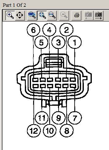

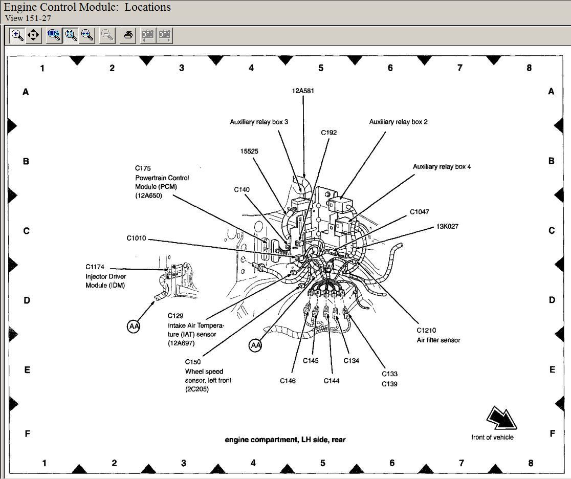

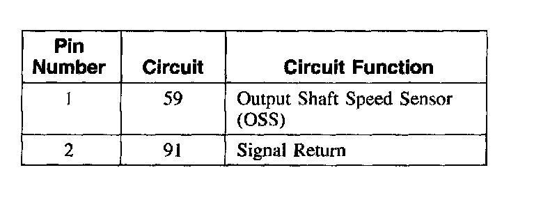

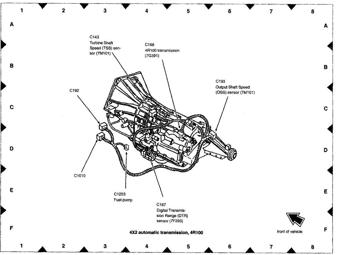

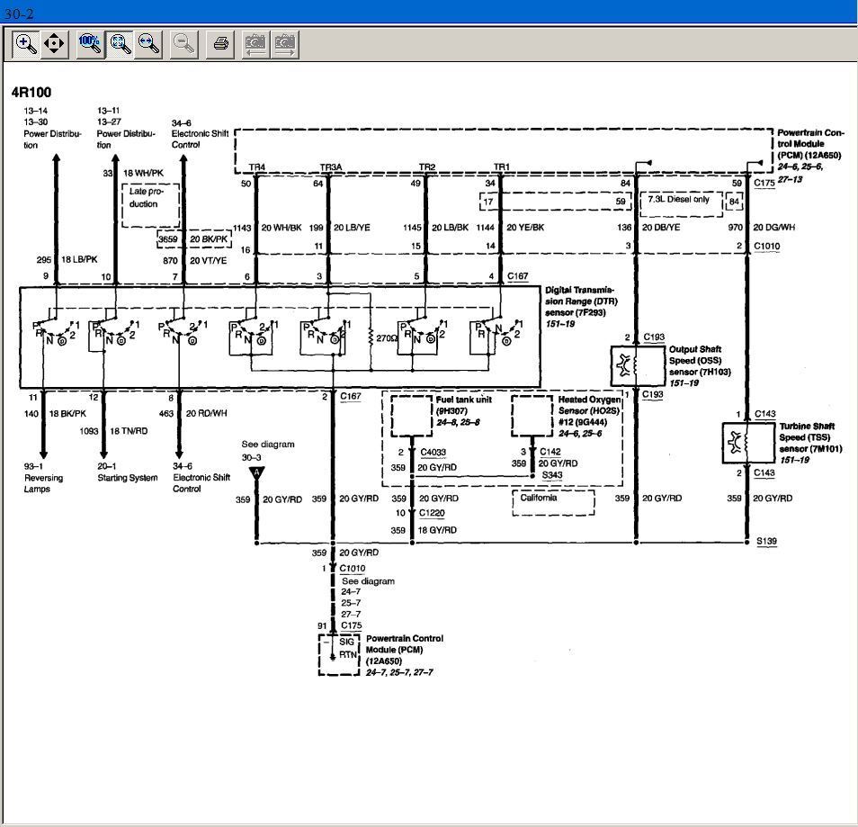

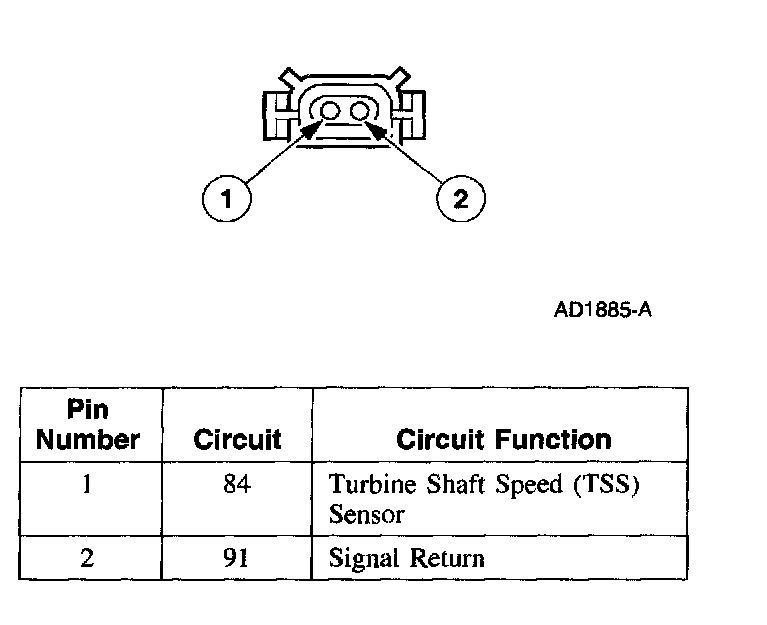

4 Connectors, I will include all 4 below:
1) Transmission Harness
2) Range Sensor:
3) TSS:
4) OSS:
Location shown below:

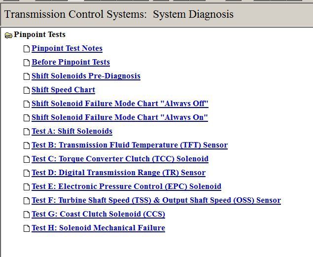

Pinpoint Test index page shown below:

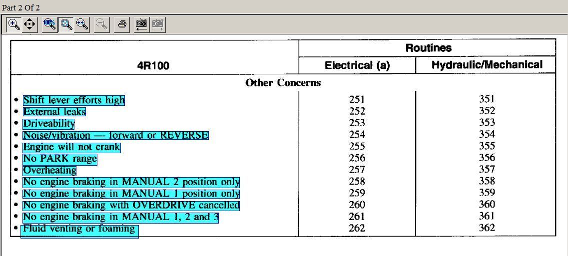

I gave you Pinpoint E previously, the P1747.pdf I renamed to. Download Pinpoint-ALL.pdf to see all A to H.
Routine index page shown below, download Routine-ALL.pdf to see the routine number.

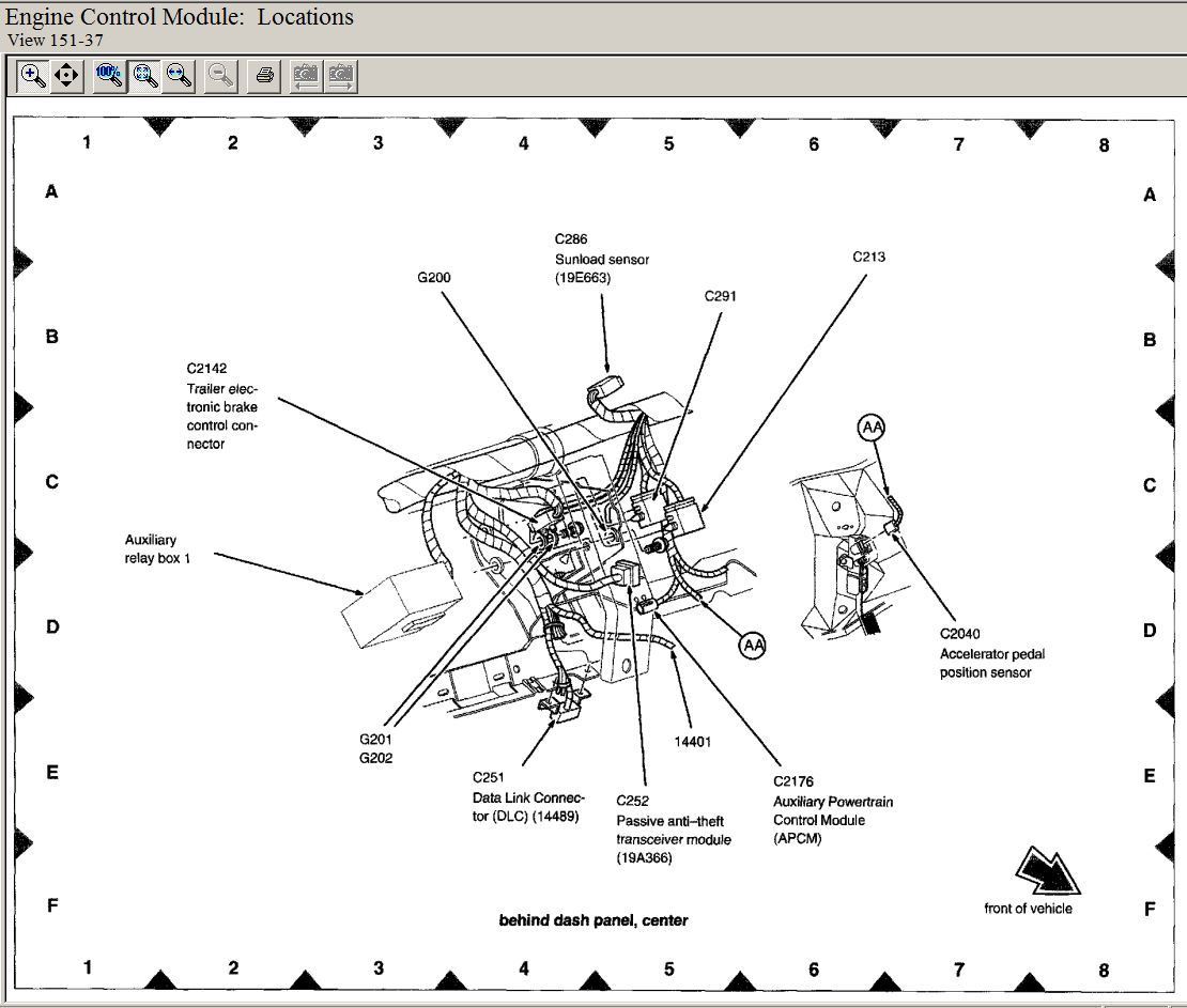

Now let's get to PCM:
C175 above and C2176 below:
Download PCM-Connector-Views.pdf to view the PCM pinout. You need that when testing 4 transmission connectors above (transmission harness, range sensor, TSS and OSS).
To check the DTC download DTC-ALL.pdf and DTC-Pinpoint-ALL.pdf.

I desoldered and replaced a horizontal stabilizer chip on a projection TV in high school, then re-assembled all the components and wires from memory, and spent a portion of my life watching Macbook repair on Youtube. That being said, I've not yet successfully unclipped any of the connectors in the engine, such as the one pictured above. Looks like it needs a screwdriver and one turn too much and it will snap.

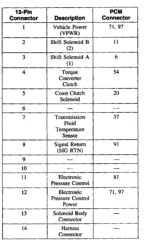

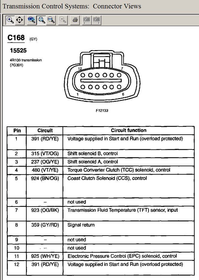

Thanks for these images, they are helpful. What program is this?
Does this 12 pin connector go directly from the transmission to the PCM, or is there another harness for the PCM where it intakes the transmission wires?
Old Yesterday | 03:07 PM
  #17
Posts: 1,263
AllData, mine covers any car make up to 2007 and incomplete info up to 2009

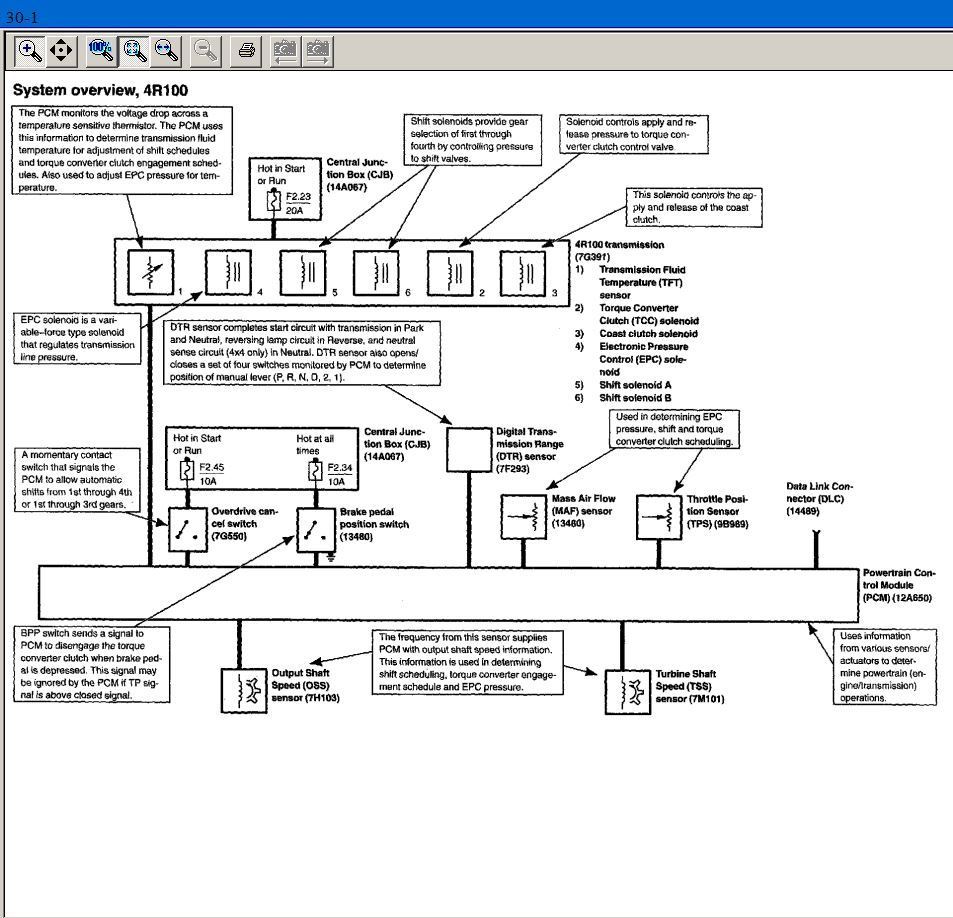

Yes, check post # 13, my long post. From the top you can see 3 diagrams labeled 30-1, 30-2 and 30-3, check 30-2 and 30-3 you can see C175 is the PCM connector, C167 the range sensor and C168 the 12-pin connector you talked about on 30-3.
The 4 connectors, all 4 of them I included the 12-pin connector to the matching PCM pin on the right.

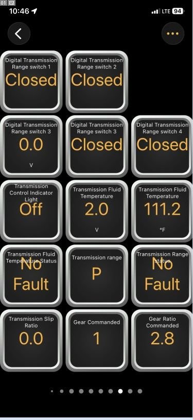

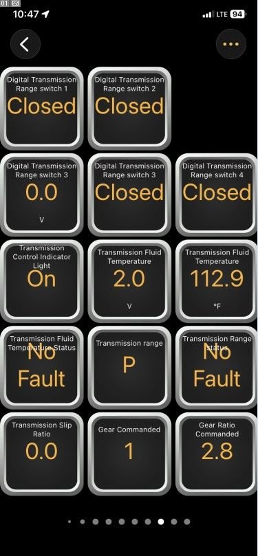

There might be mechanical problem, but I wouldn't drop the pan until all the electrical stuffs are sorted out. It would be helpful if you have a scanner and a bluetooth adapter to read all the Ford's specific DTC and the live data. OBDLink MX+ for instance, you can read 100+ PIDs on just transmission only. For example:
