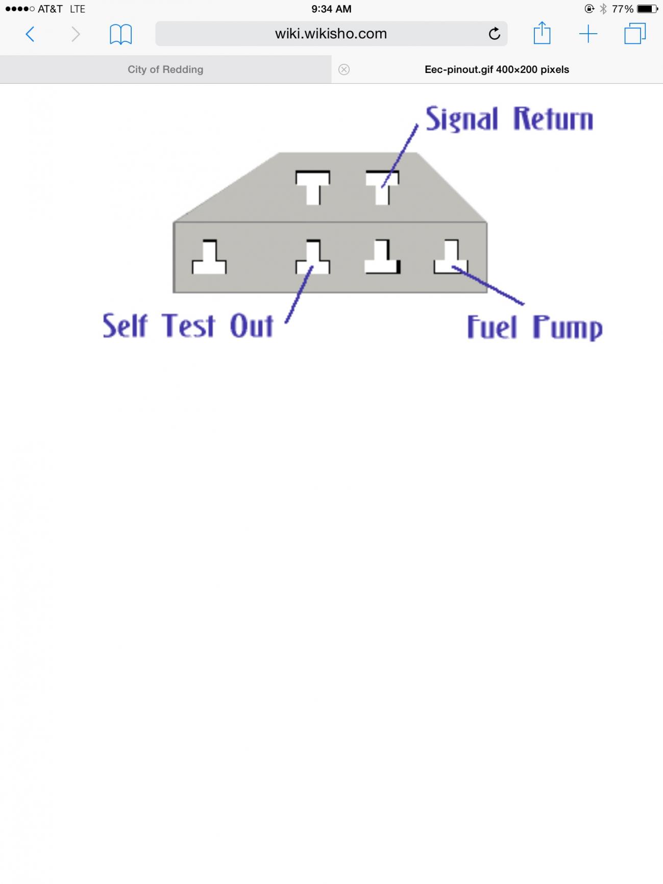

Good way to check is to bridge the DLC connector pump circuit to run the pump continuous. If the pump runs, a pressure and volume check to gauge pump health is a good start point. Being the pump circuit is full time active without a running engine, helps to diagnose power distribution/relay/inertia issues.. Ground the pump terminal only, key on, engine off

OK, is that the little box under the hood, right in front of the master cylinder? I'm not sure this will really help. I always turn the key to "on" and listen for the pump before I waste power cranking the engine. BTW, I tried about 4 hours after posting this and it started. The pump works fine once it's running - no issues with driving it other than the "check engine" light and terrible gas mileage.
