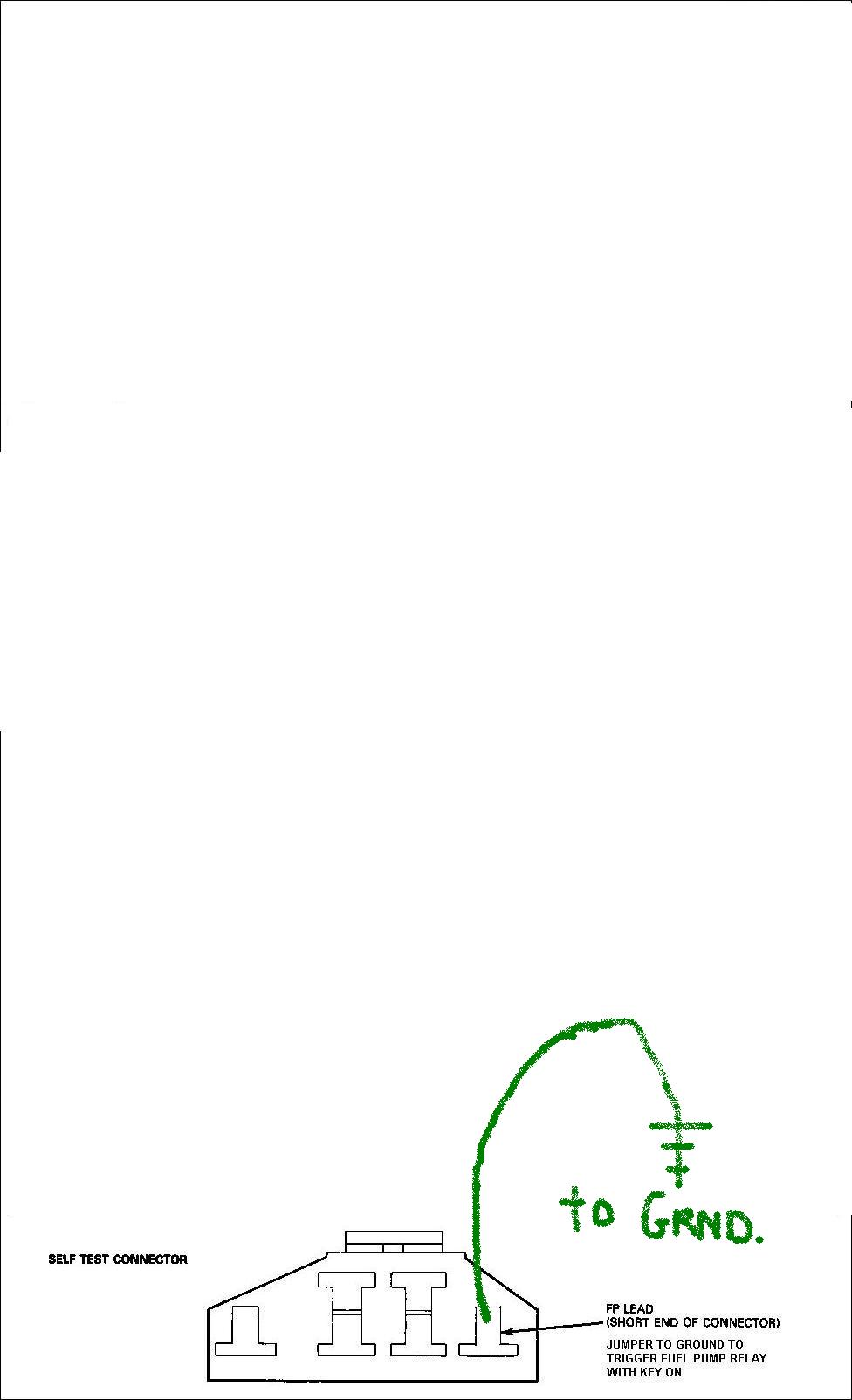

DLC/Data Link Connector or EEC Electronic Engine Control..
Sometimes to 'test run' the pump and 'prove out' the system components like, pump, inertia switch, relay, and power distribution circuits/connections, you can jumper or 'bridge' the EEC/DLC for test purposes only. The trucks PCM/ECM controls pump run times by controlling the fuel pump relays ground. By jumping the test connector, you take the computers control of the fuel relay grounding function out of the diagnostic equation. During a normal system test with a scan tool, the fuel pump is run in the same way and checked. During a self test, if the ground was missing, generally a DTC is set.
On the left side of the engine bay, up close to the firewall/booster you'll see the test connector. May still be snapped into its plastic cover. With a jump wire grounded as show, the pump should run 'continuous' as long as the ignition is ON.
If by adding a ground on the connector corrects the pump drop out/run time issue, chances are the computer isn't supplying a ground or is intermittent to the relay. At least suspect.
If it doesn't correct,, then it helps to diagnose and pin point the area of failure since power distribution can be checked either from the pump forward, or from the relay on out back to the pump while the circuit is/remains active. As well as ground check while testing. If you have power distribution and an active ground at the pump connector, helps to diagnose a dead/dieing pump. Sometimes a stiff thump on the tank with the ignition ON will jar a pump back to life and confirm a sick pump.
Again,,TEST only. For fire and personal safety purposes, a test connection should never be wired and left. Being the relay harness was hacked, could be what was attempted or a test/run point..
