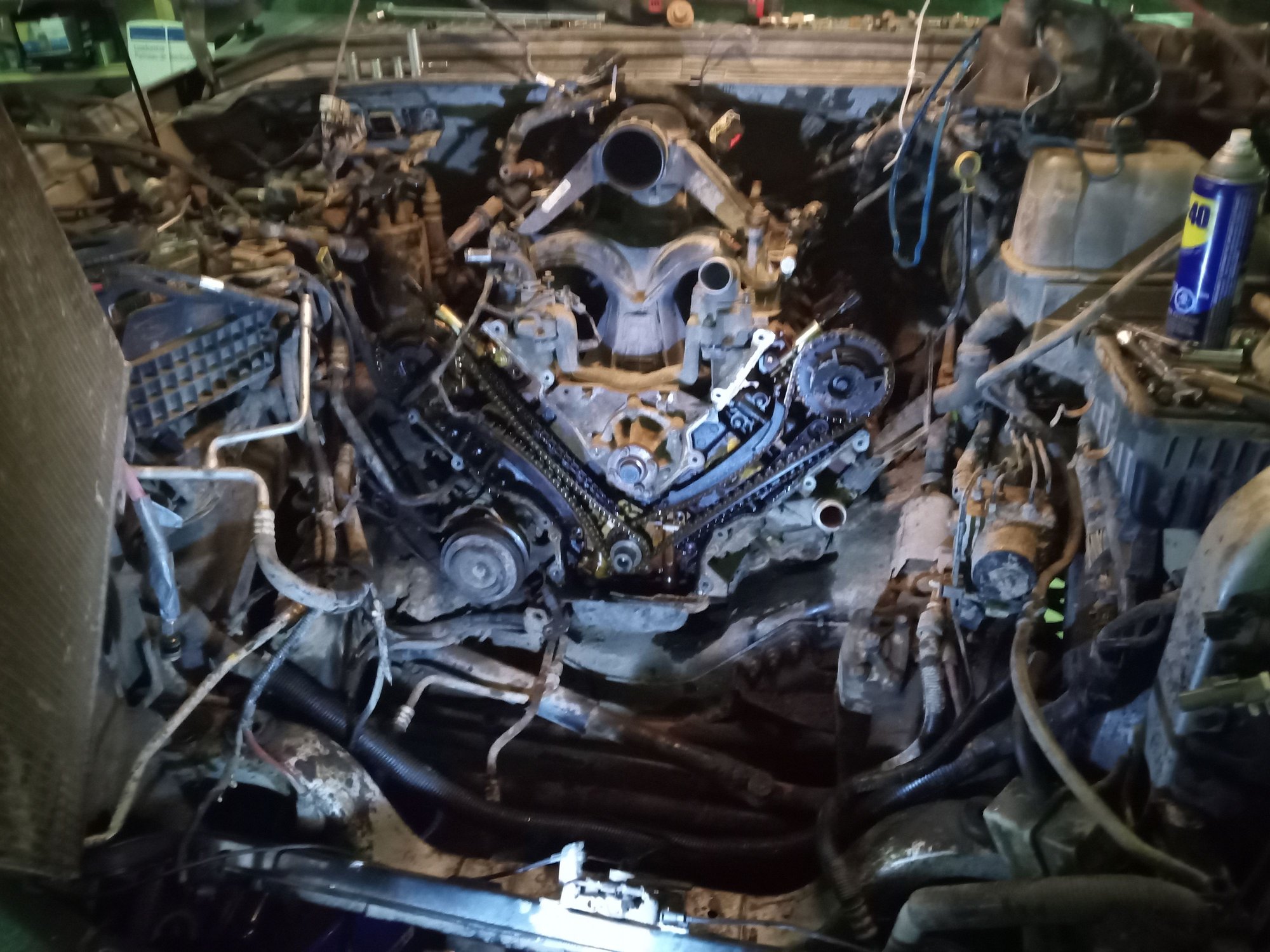

Old Jan 22, 2023 | 01:48 PM
Whiskey Victoria's Avatar
Joined: Apr 2018
Posts: 22
A very nekkid and sad truck.
Old Jan 22, 2023 | 03:38 PM
From your photo, it seems like the frame has had it. If they are holes, your decision.
