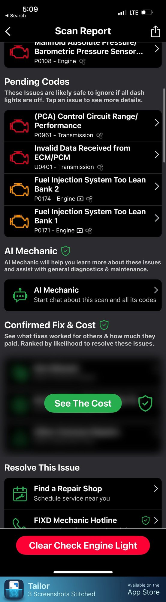

In case the photo doesn't appear here are some of the codes I get.
-P0961
-U0401
-P0174
-P0171
-P1000
-P0871

Codes I was getting from a cheap code reader. 2007 FiveHundred SEL

Your P0108 MAP sensor code could be setting the Lean Codes P0171 and P0174. Since you replaced the EGR, could be a faulty sensor or wiring. Do you feel comfortable performing the Tests for that code? You would need a multimeter and Scanner that can show PIDs. I can post them for you. Also check the connections for the MAP and EGR, make sure their not damaged and fully connected.
For the transmission there is a Note (see below) in the diagnostics. "NOTE: Prior to entering pinpoint tests, the vehicle harness must be checked for continuity and shorts, and the powertrain control module (PCM), engine control module (ECM), DEM module and other modules and non-transmission sensors may affect transmission operations must be checked for any concerns. Refer to the Powertrain Control/Emissions Diagnosis (PC/ED) manual for diagnosis and testing of the PCM concerns. Repair all non-transmission component and module concerns first.
NOTE: If any non-transmission repair codes appear, repair those codes first. They could affect the electrical operation of the transmission. Record and erase codes from continuous memory after repairs have been carried out. After repairing any fault codes in the Quick Test, the Quick Test should be repeated."
