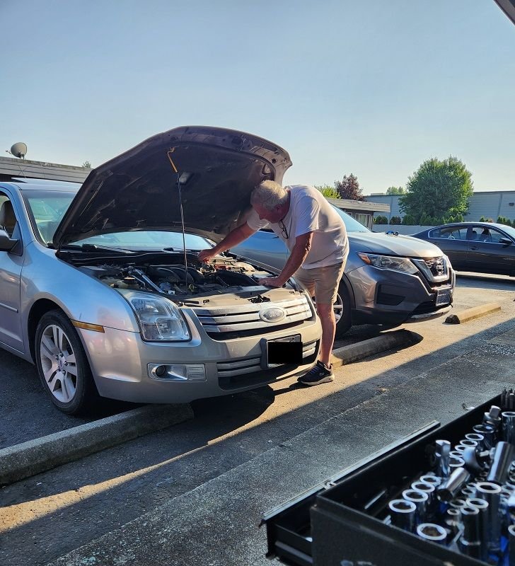

I have an 09 fusion v6. 170k miles
A weird problem started popping up that is SUPER inconsistent and hard to replicate. It's kind of difficult to describe as well.
The car has died a several times while driving, mostly within the first couple miles of driving. and, more curiously, would not start at random points as well. The two dont seem to be connected.
It cranks just fine, but won't turn over. But only periodically.
At first, i thought it was the battery, but no, current test came back good, battery is only 4 years old.
Then i thought it was somthing electrical, but when it dies, everything accessory is still working (radio, lights, etc.)
Then i moved to the fuel system. Checked pump first, as this model doenst have a fuel filter, that was good. Then checked the rail pressure, that was good.
Moved on to ignition, spark plugs are all good, ignition is good....
Then I read somthing on the interlock system could potentially do something if the fob is somehow sending bad signals due to a bad battery in the fob, it could lock the car as it's driving, and shut down ignition, preventing theft i guess. Wasnt that.
I'm thinking it could still be something with fuel. As only once, last month, as i was driving, it started faltering like it was out of gas, then "caught" itself and with a clunk like it found a new gear, came back to life, and continued on normally.
It's VERY intermittent, and it happened 3 times within a week last month. Now its been starting and driving perfectly the last few weeks. and today, it started doing it again. I am at my wits end, and don't have the funds top go to a shop.
I am new to this forum and any help would be greatful.
