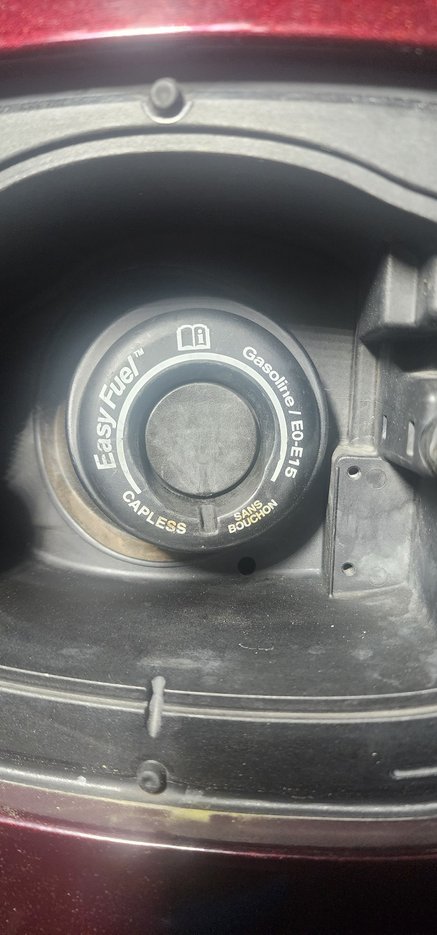

This 2013 Fusion has a cap-less filler neck, so I opened the flap and shot some compressed air into what I think are vents on either side of the tube that runs to the gas tank.
On Day-1, I tried cleaning the flap using the WD-40 on the funnel cleaning method.
I attached a couple of pics of the cap-less filler neck...seems like there were many different versions.
I imagine that since the car stalled again, that my Purge Valve (#3) is toast.
Bad pic, but i shot some canned compressed air into the side vents.
