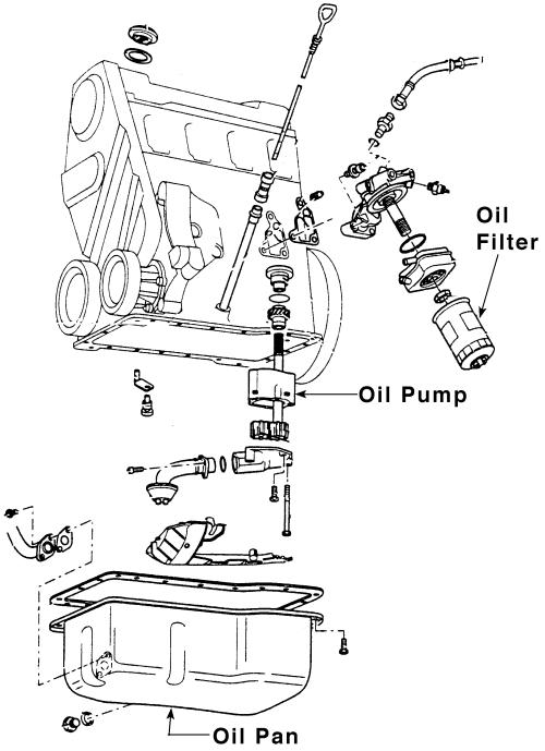

It would maybe be a good idea to locate an oil lubrication diagram/path for that engine and see just where the oil is supposed to go and it may provide some clue to just why the oil is causing so much problems.

This is the best I could find. I’m not so sure this is the engine though. The 4.0 has the double layer oil pan.
