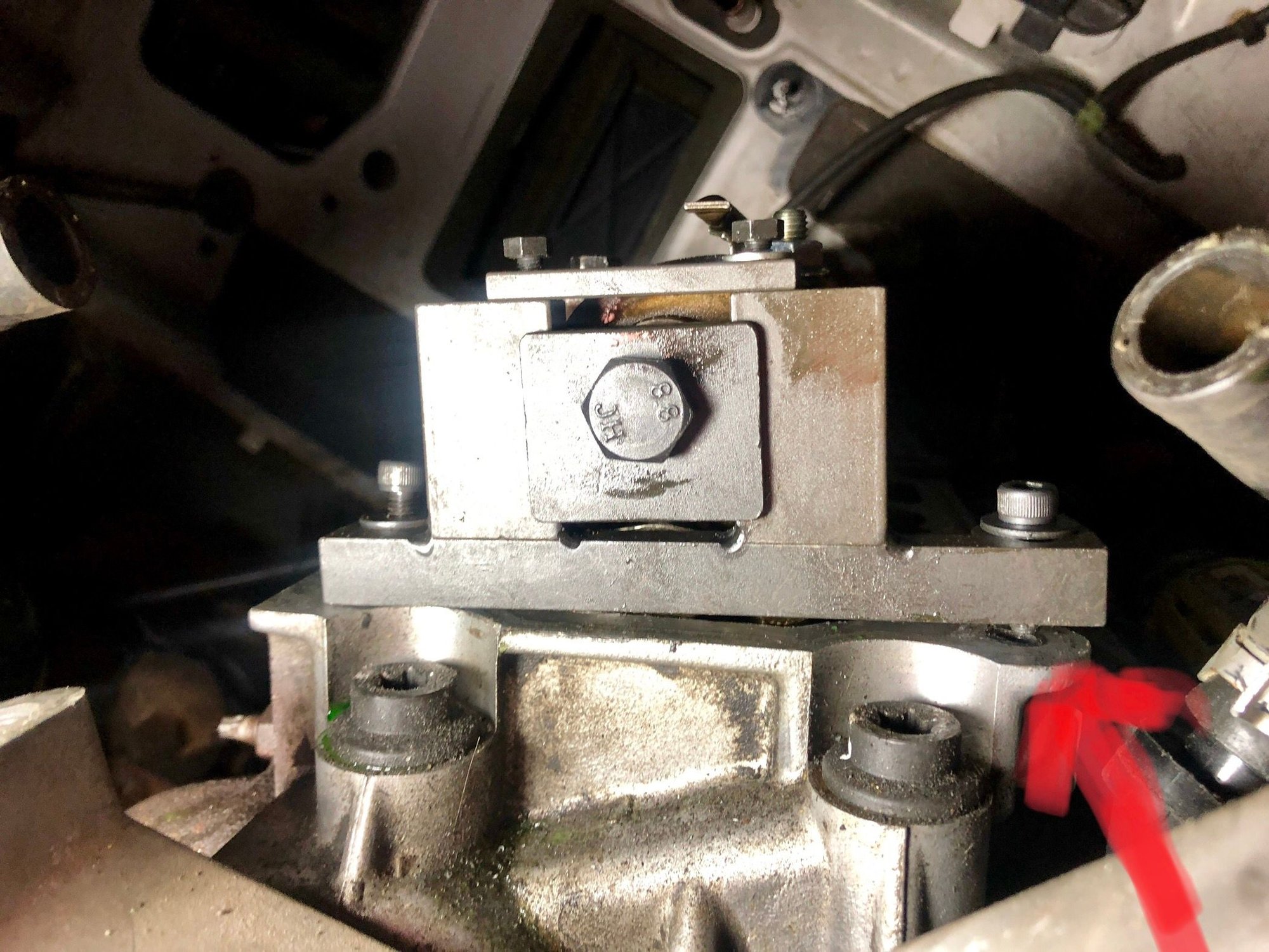

I got the sticky injector to work consistently after using an ultrasonic bath and pulsing 12v through them. Also, I was right to suspect that the timing on bank 1 had slipped (pic below). I reset the timing and will report back later to say whether or not I'm still having problems.
