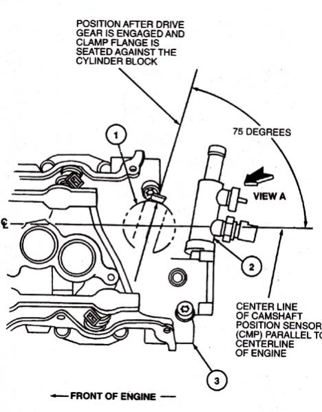

Yes, the marks are on the pulley. Just make sure that # 1 piston is at it's compression stroke when lining up the timing mark to TDC.

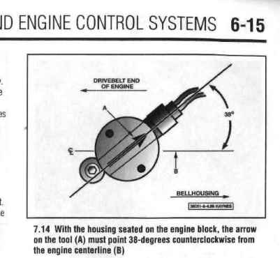

I'm looking at the same picture way2old posted for you and my 97Ford manual shows a 75 degree angle where way2old's picture shows 38 degrees. Was the angle changed somewhere along the line?
The tool ( Syncro Positioning Tool) part no. my book shows is; T95T-12200-A
I don't know if there is another tool available.
The pictures are identical except for the # of degrees shown in the picture.

hanky. Could you post the pic you have? I am getting my pictures from the online Ford Manuals from Ford's website.

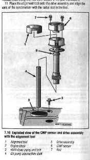

As for my questions I guess I should've looked in my Chilton’s book first because it describes all this. However it refers to 38 degrees the way2old's picture shows. I snagged a couple of pics from the manual. The alignment tool my co-worker loaned was different. It had a smaller window for the sensor vane where mine needs a much wider slot. So, I’m currently running with the sensor disconnected and it is running OK. CEL is still on, it has been since we bought the car. I’m trying to find the correct alignment tool now and will try to realign again. I did have a little trouble getting the pump shaft to line up and go into the cam sync. assy. but finally managed.

Attached Thumbnails red oil light is on 97 Taurus-cmpsensor.jpg   red oil light is on 97 Taurus-cmpsensor1.jpg

Here is the picture.

Wierd. It seems that Ford manuals would show the same charts. Wonder if the publishing date would have any bearing on it. I am using Ford's on line repair manuals.
Old Mar 29, 2011 | 03:54 PM
  #18
Knowing Ford , anything is possible. My manual is a 97 date and I am wondering if possibly due to emission /performance considerations, Ford backed off the injector timing which is what I believe the cam syncronizer influences. I'm just speculating here and have no other explanation to offer that might make any sense. What do you think?

way2old's Avatar
Joined: Jan 2006
Posts: 1,234
From:
Sounds good to me. I just try to make them run, not make them.
