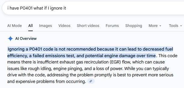

P0401, a confirmed code, should be addressed first when P0191 is only at pending stage. If you compare P0191 with P0190, P0192 and P0193, the P0191 is less critical.
You have same symptoms as rough idling.

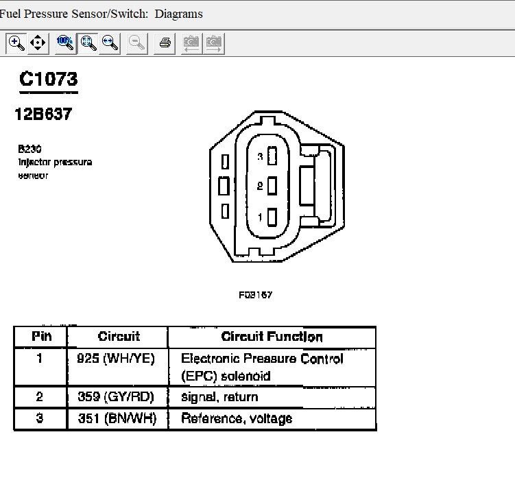

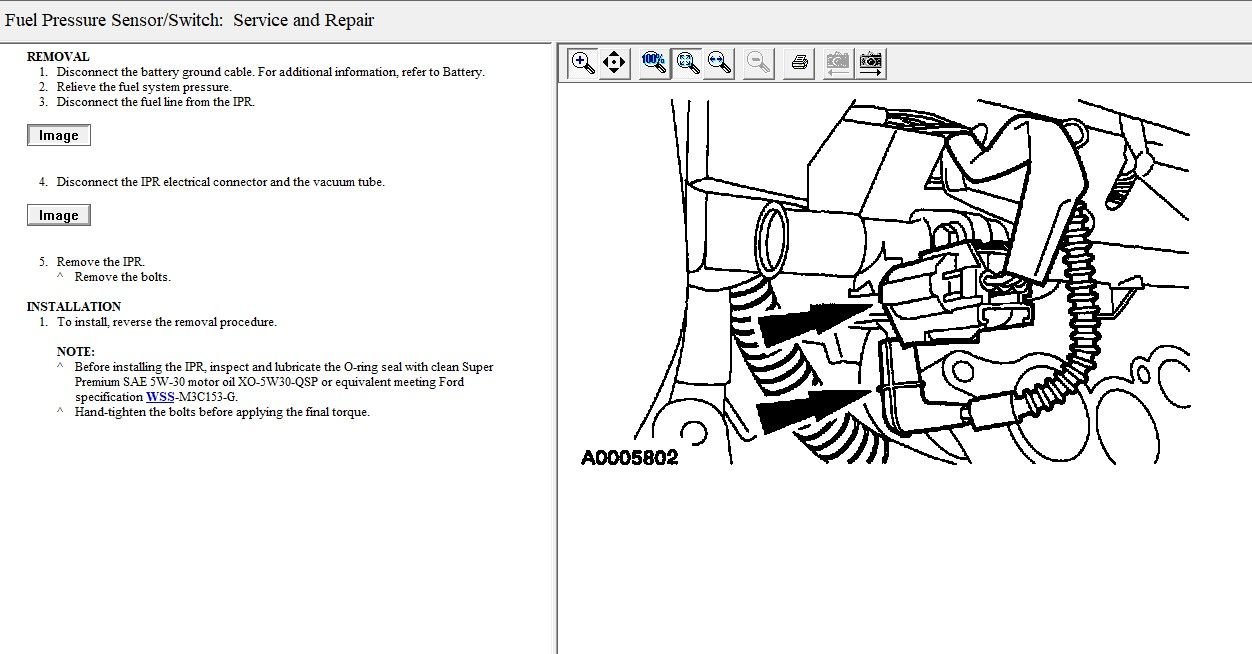

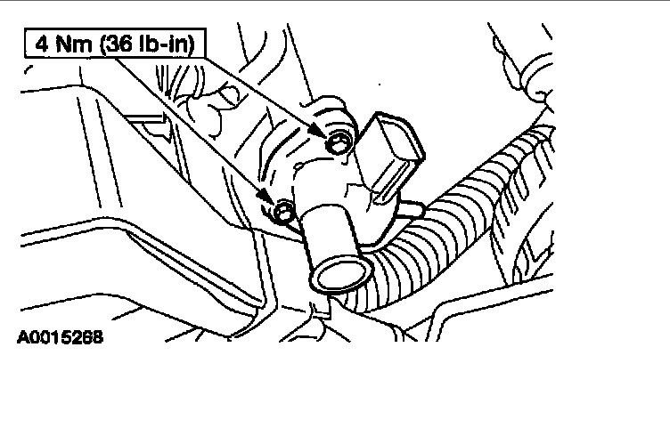

It was a motor out of a 00 Taurus going into a 00 sable. My first thought is fuel pressure regulator, or is that sensor also a regulator? What is this part in the pic

Default Regulator and sensor in one?
K, but that's just the sensor, which I am not saying isn't bad but isn't the regulator a more likely culprit, how do I test both of them. Or is the fuel pressure sensor also the regulator. That pic I posted I thought looked like a regulator but no vacuum line going to it where there is a vacuum line going to fuel pressure sensor so idk.
