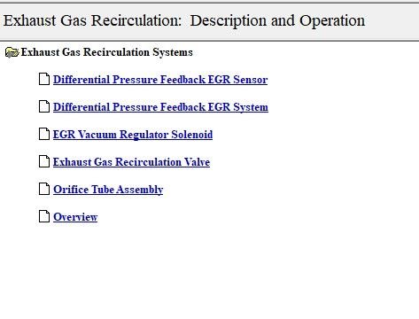

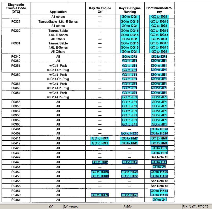

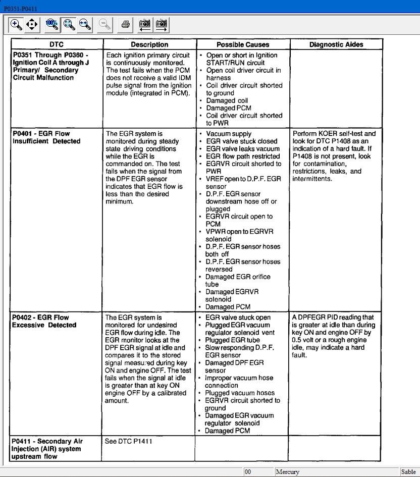

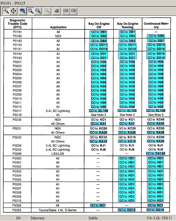

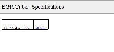

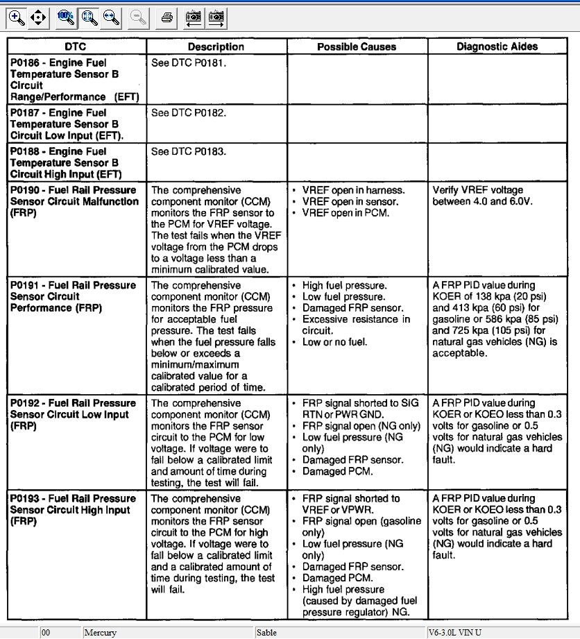

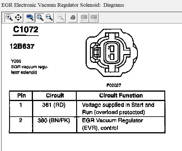

No more guessing and forget about getting TFT.
You have P0401 and P0191 so check the possible causes as shown below. And if you need to throw any parts related to EGR, you don't need motorcraft brand.
If you look at post # 13 above, for P0401 you need to check HE70, Pinpoint-HE.pdf already attached there.
With just a BlueDriver, or even OBDLink MX+, you can only do so much with just the adapter and to go over those KOEO or KOER tests you really need a handheld scanner like Foxwell NT510 Elite or ForScan Desktop version.
EGR below:
EGR Vacuum Solenoid below:
EGR Tube below:
EGR Valve below:
Anything EGR related already attached.

Default Sparatic fuel pressure
I noticed my fuel pressure is within range of what the chart said but it's really sparatic and doesn't really correlate with rpm. It will jump from 30 to 45 or 50 at the same throttle position. I would imagine this should increase steadily with rpm shouldn't it, not just randomly be all over the place?
