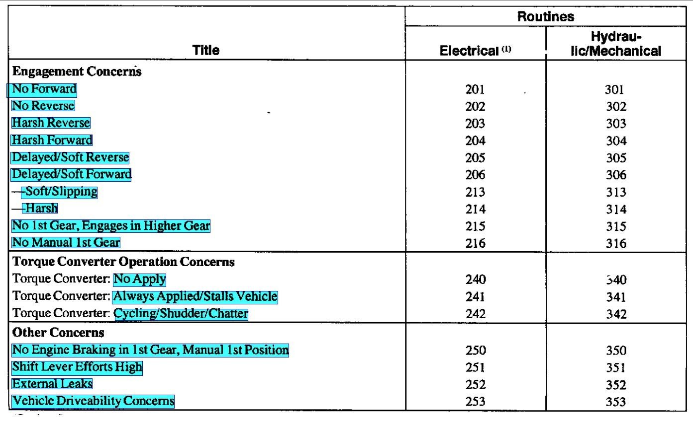

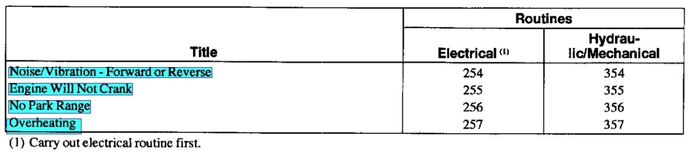

If you have a capable scanner to retrieve TFT (transmission fluid temperature) it can tell the health of your transmission when it's in operating temperature, you can tell if it's overheating or running cold.
25-40 mph is considered stop-n-go while 50-60 mph is probably expressway or freeway. Say you live close by the freeway entrance, and after 10 minutes driving, you can have ECT at 190, EOT at 170 and TFT at 140 and that's normal. Same 10 minutes on stop-n-go, ECT 190, EOT 150 and TFT 190, that's normal still because TFT temperature raises so much quicker in stop-n-go. Under normal driving condition TFT should take much longer to reach operating temperature than EOT. If you are seeing ECT 190, EOT 200 but TFT is 230, that indicates overheating problem, you will need to look for issue with transmission cooler lines or system. You don't see the problem when driving 50-60 mph because torque converter works much harder and generates more heat in stop-n-go traffic.
Note with a generic obd2 scanner you won't be able to retrieve TFT, you need OEM-specific one for Ford/Lincoln/Mercury.

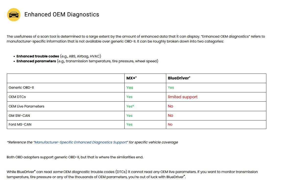

When it comes to obd2 adapter, I would either get the cheapest $10 or the most expensive OBDLink MX+ on the market. If I want full support I expect 95 to 100%. BlueDriver at such high price to me is a complete garbage I would rather stick with a $10 cheap generic one.
TFT according to what's shown above is not available with BlueDriver. You never know until the adapter is plugged in, so why don't you plug it in and see. And while you are at it show us all the DTCs you have at this moment.
