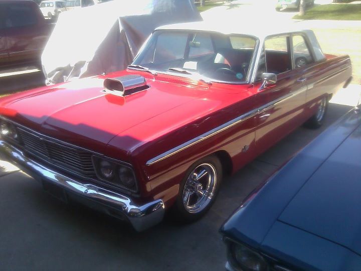

289 40 over compression 160,175,175,180,190,180,180,175.#1 wet 160 to 175. Leakdown 3% all cylinders.problem no smoke at start up,rev engine no smoke let off smokes about 3 to 5 seconds later. Guessing top end intake manifold leak from valley as it smokes at high vacuum.guides or seals any suggestions?
