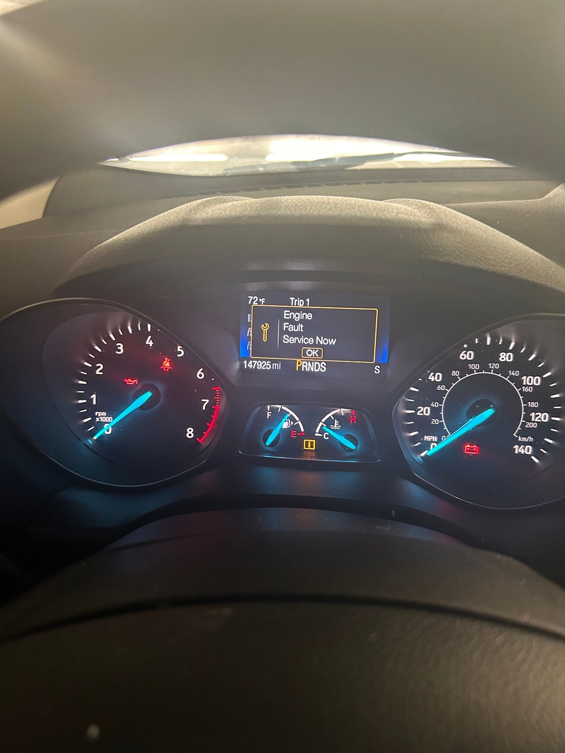

Battery, oil pressure and engine light all on I have a 2017 ford escape titanium and notice this past week my car has been slow to start. Today all these indicators came on and my car is not drivable. The engine stalls and is not running. Anyone know what the possible issue is? I’m currently waiting on the tow to ford but to be honest. I’m over this escape, it’s been very problematic. I have had transmission, oxygen sensor, alternator and agm battery within the past year in a half.
Anyone experience this issue with the indicators

A good scan tool very likely would help here because it should show any codes that would cause the check engine lamp to come on.
Many times a poor ground connection will find ground through the lamps and cause them to come on.
You might check the grounds from the battery negative terminal on the body sheet metal . Some are at the radiator frame mtg. and some are at the firewall.

I have a 2017 ford escape titanium. Not sure about a recall, but my issue was the starter. I’m going to dump this vehicle. So many problems.
