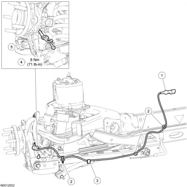

My 2006 Frrestyle Ltd ABS light stays on so I went to Auto Zone for a computer scan. The guy came up with bad a right rear wheel ABS sensor. I wanted to save some bucks and asked if it was something I can do myself. He said it should not be a problem so I ordered the part.
Can someone give the step-by-step directions for replacing the sensor? Thanks

Here are the instructions from Ford.
Removal and Installation
With the vehicle in NEUTRAL, position it on a hoist. For additional information, refer to Section 100-02.
Disconnect the wheel speed sensor electrical connector.
Remove the 2 wheel speed sensor harness retainers.
Remove the wheel speed sensor bolt.
To install, tighten to 8 Nm (71 lb-in).
Remove the wheel speed sensor.
To install, reverse the removal procedure.
Attached Thumbnails How do I replace rear ABS sensor on 2006 Freestyle?-freestyle-abs.jpg
