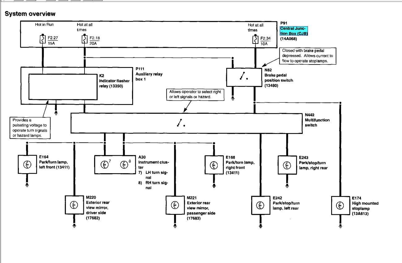

So let's go over the turn signal first instead.
Above diagram locate K2 indicator relay.
Below diagram locate the same K2.
This is a single relay (both turn signal and hazard) with a normally closed setup type because hazard needs to function with engine off key out situation.
For turn signal to work: K2 relay needs to be energized as: terminal 85 (already always hot), terminal 86 (already grounded at all time), terminal 30 (requires key to run position), terminal 87 (gets 12v feed from terminal 30), your turn signal switch does NOT need to be turn to left or right, the 12v is already there it's up to you to toggle turn signal to left or right to activate blinker. The 12v feed from terminal 30 to terminal 87 to turn signal switch in off position and it terminated right there.
For hazard to work: K2 relay does NOT need to be energized as: terminal 85 (already always hot), terminal 86 (already grounded at all time). When the relay is NOT energized, terminal 87a is always hot, this is so-called normally closed setup. 90% or higher uses normally open setup. The hazard switch is pretty much an inline cut off switch between the relay and the blinker so your hazard can function when engine off key out.

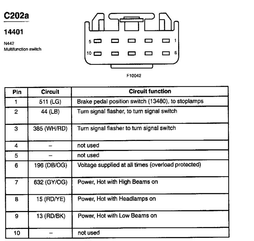

When terminal 85 is always hot and terminal 86 is always ground, your k2 relay energizes or not, sends 12v to the multifunction switch. Look up 2nd diagram from the top you can see terminal 87 connects to terminal 2 on the switch whereas 87a connects to terminal 3.
So let's assume your brand new k2 relay is good you should get 12v at terminal 2 of the multifunction switch when key in run without toggling the turn signal switch. Please check and get back. It's circuit 44 shown below diagram and the wire is in LB (light blue). Use voltmeter and probe terminal 2, key in run, you get 12v or not.
Next step is to probe the (17) right turn and (16) left turn to find out why 16 is not working when you reply to my original parking light question.
You can also follow the pinpoint test K pdf below.
