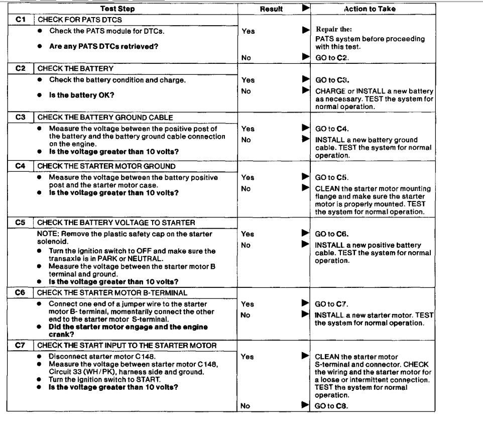

Below are pinpoint test C.

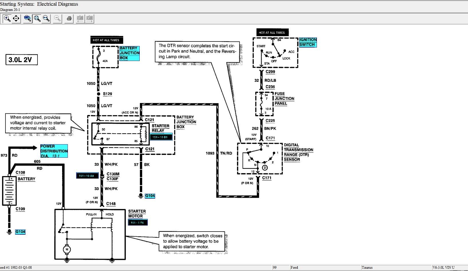

Correct diagram above.
If you compare the one previously, upper left you can see 3.0L 4V and 3.4L SHO, this new diagram you see 3.0L 2V
4V is 24 valve whereas 2V is 12 valve and you said you have 12V.
Have a look at this new diagram, terminal 85 with BK instead of PK wire, and no PATS on yours. So don't worry about finding locksmith, at least your PATS doesn't interrupt your starter motor.
Remember you said (1) you get ground signal on both previously?
What I suggest is to bench test the relay, both old and new, and see if you can feel or hear any click and see you get 12v on terminal 87 is most important. Do you think you can handle the bench test or you need more details?
1) Terminal 85 (BK wire) - you confirmed ground signal previously
this time please test resistance, 5ohm or less? You know how to test this or you need help with this?
2) Terminal 30 (LG/VT wire) - you confirmed 12.56V previously
3) Terminal 87 (WH/PK wire) - you confirmed 0V previously
x) Terminal 86 (TN/RD wire) - you confirmed 12.38V previously
Let's get your starter to crank and start first, then work on the obd port's electrical stuffs.
