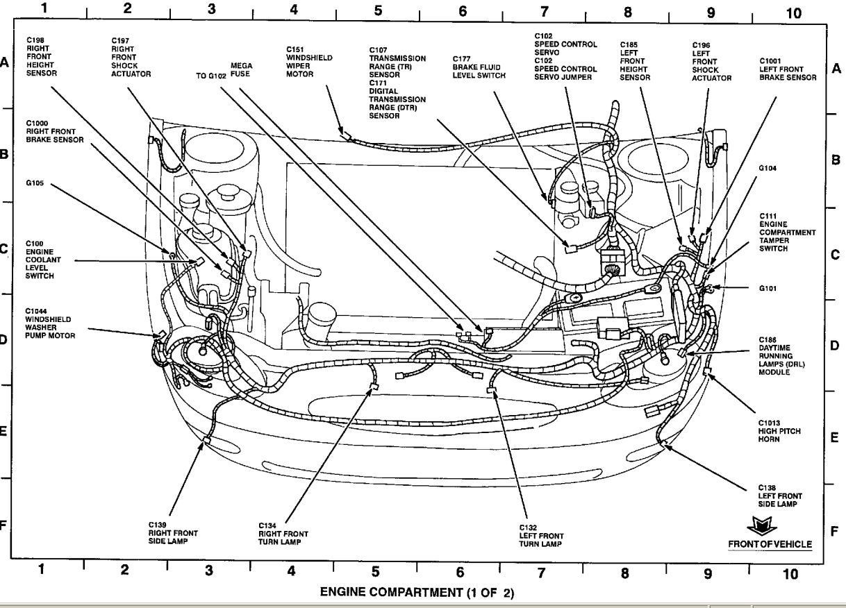

Below diagram locate G104, don't get mixed up with G101 (on the upper right), that's the ground point for the BK wire (terminal 85). If you get high resistance after the test tomorrow you may need to clean or replace the BK wire or terminal at G104. If you have electrical contact cleaner, use it, if not, isopropyl alcohol 90% or higher works as well, if you don't have it too, grab one at Walmart it's cheap.

Terminal 85 is the BK wire and it connects to G104 ground point, not PATS.
