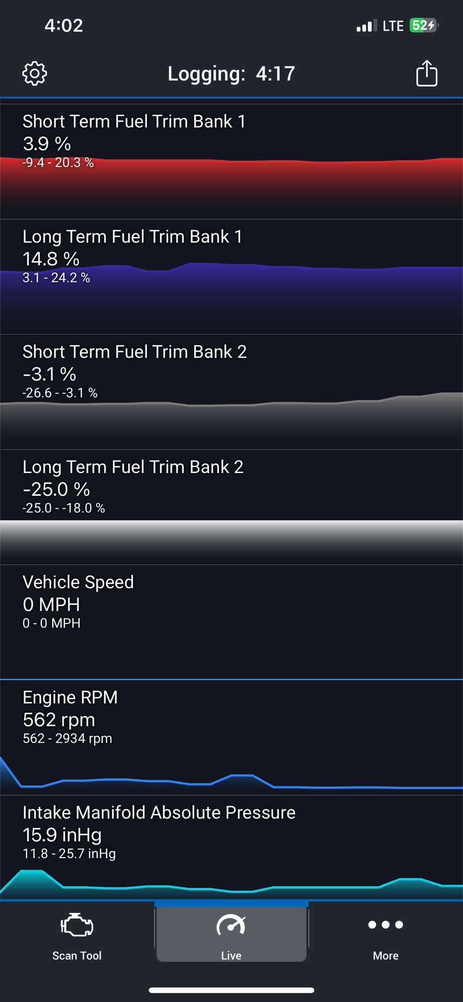

I have BlueDriver code reader and was trying to attach some live data photos for you guys to see for some reason have a hard time uploading them I get no codes on my scanner i will rent one out DTC SCANNER and see if it shows anything

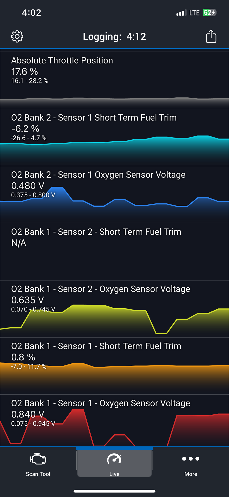

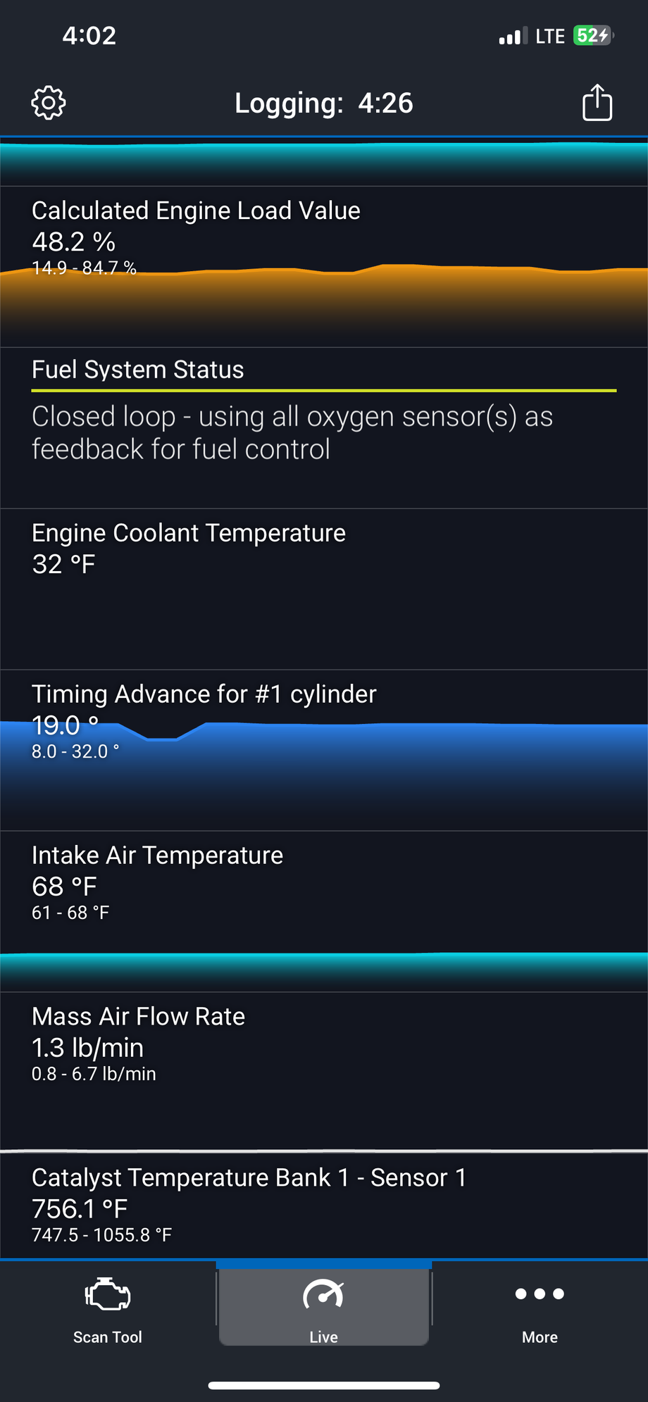

Old Mar 19, 2025 | 07:57 AM
Miraldo78's Avatar
Joined: Mar 2025
Posts: 22

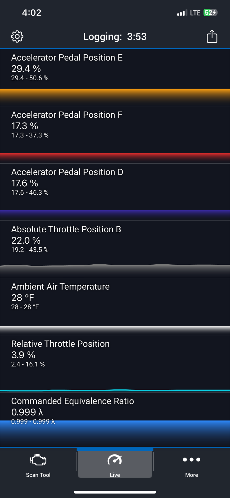

These readings were taken when I turned my AC on only change was RPMS they dropped from 750 to 536

Don't see any issues from your live data.
Can you do the smoke test one more time plus checking the pressure with a gauge? How about you remove the IAC and clean it? After that you can run a cycle of Berryman 2611 thru the throttle body.

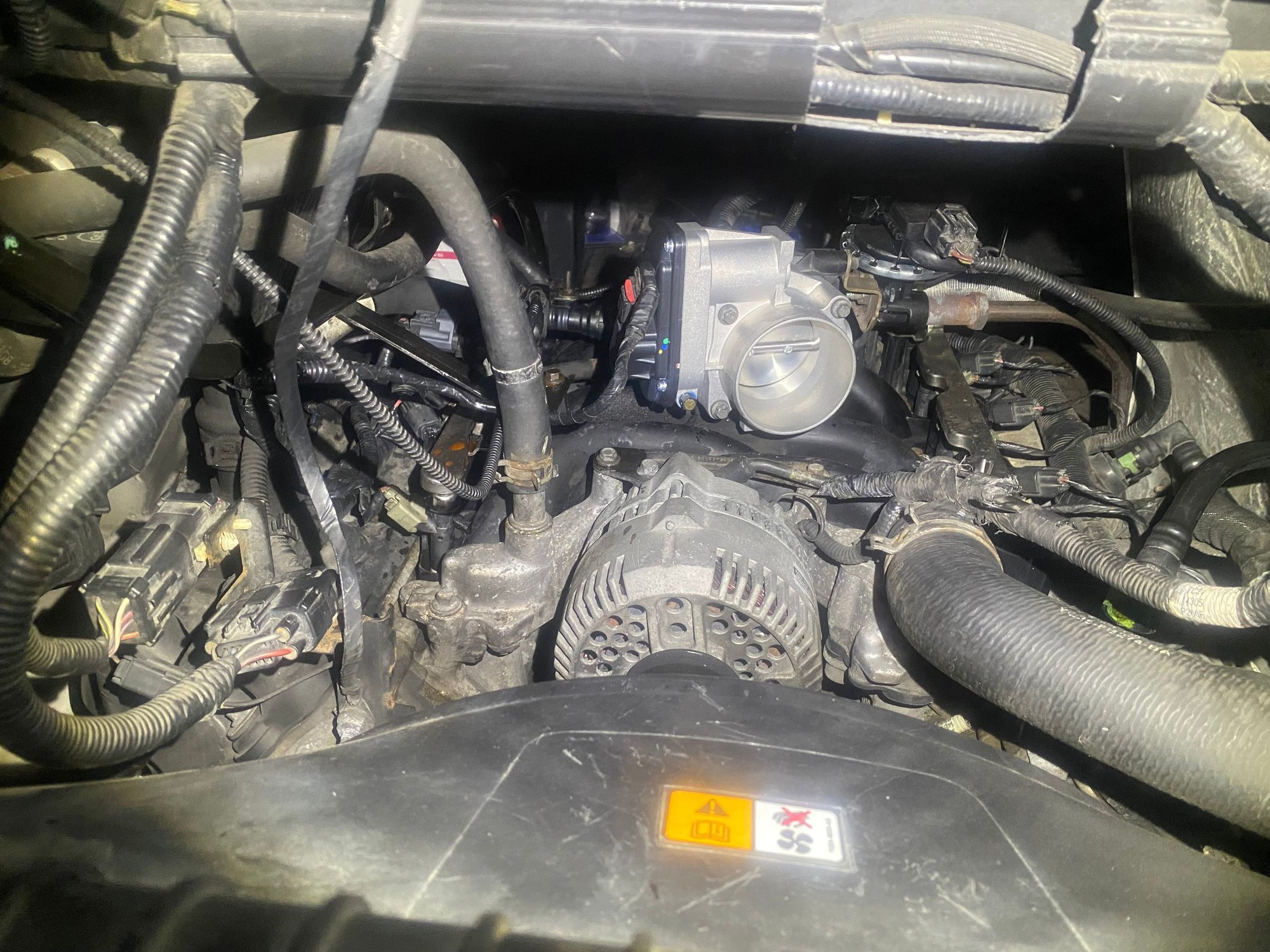

Hello so ended up removing PCV VALVE it was so packed with crap I shook it little device inside rattles i cleaned it with parts cleaner installed it back no change i did order new one soon it comes will install new PCV Valve

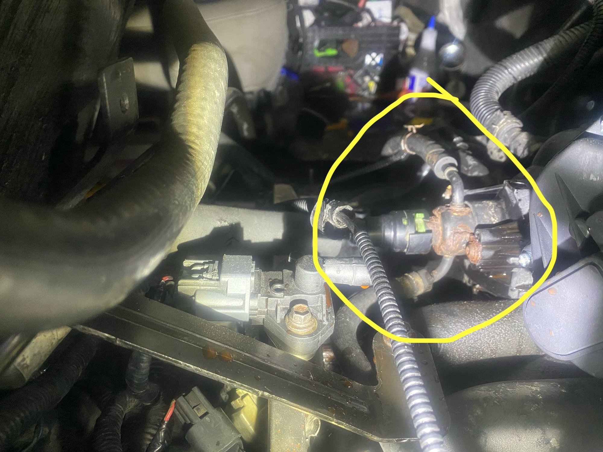

Have a question tube that comes off the PCV goes to intake manifold where it attaches part between tube and manifold it has two rubber tubes coming i and out of it when I disconnected one of the tubes has coolant in it looks like a recirculating line for auxiliary heating core will attach pics
Smoke tested again no smoke detected
Scanner I have BlueDriver does detect manufacturer codes also DTC CODES ran out if time today but will rent out another scanner and check for any other codes

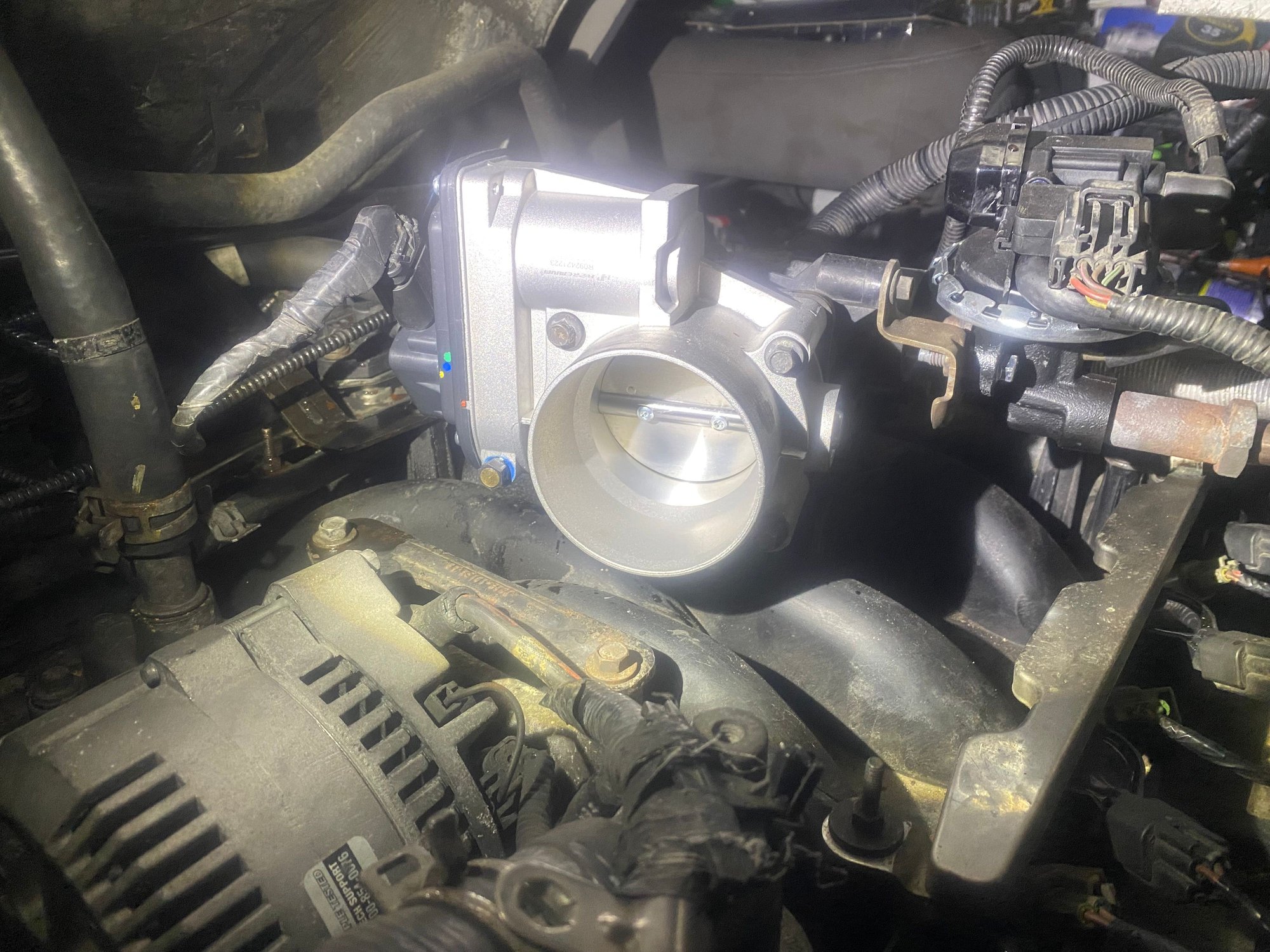

I'm having a hard time locating IAC VALVE it supposed to be on throttle body looked all over could not locate it have photos of the area will attach them.
looked from hood side and cab side
have you or anyone here ever heard that cam
Synchronizer causes issues my van is experiencing?
thank you and everyone else in this forum for all of your imput

[img alt="Yellow circle that part has two small tubes (baby blue color) going to it and they both have coolant in it
Large tube goes to PCV VALVE "]https://cimg2.ibsrv.net/gimg/www.fordforum.com-vbulletin/2000x1351/img_5757_992cc8780db91a3fe7ebac9c2ef6ee872b55ca20. jpeg[/img]
Yellow circle that part has two small tubes (baby blue color) going to it and they both have coolant in it Large tube goes to PCV VALVE
This is the part that I can not find anywhere what is called even dowloaded service and maintenance shop manual I can not find it

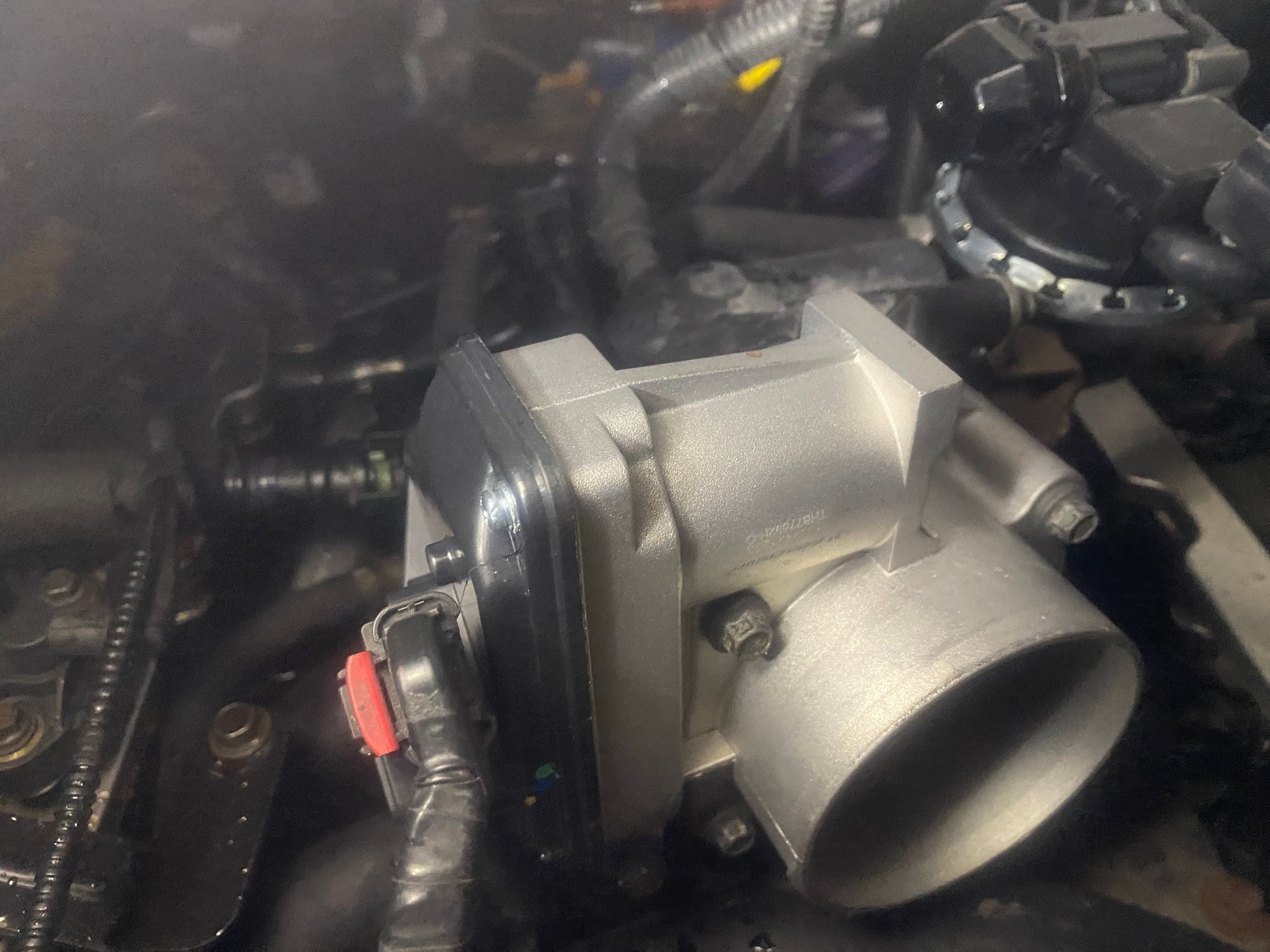

This is to show that I can not locate IAC VALVE anywhere around throttle body EGR is to the right there is nothing in back of it
