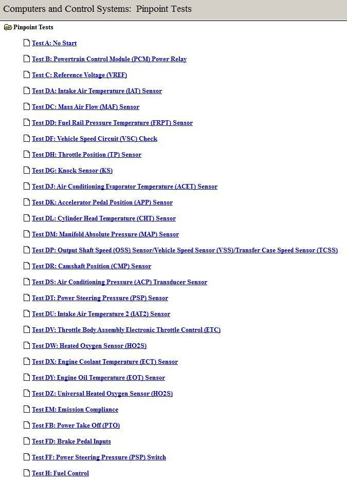

Pinpoint Test Index Page Below:

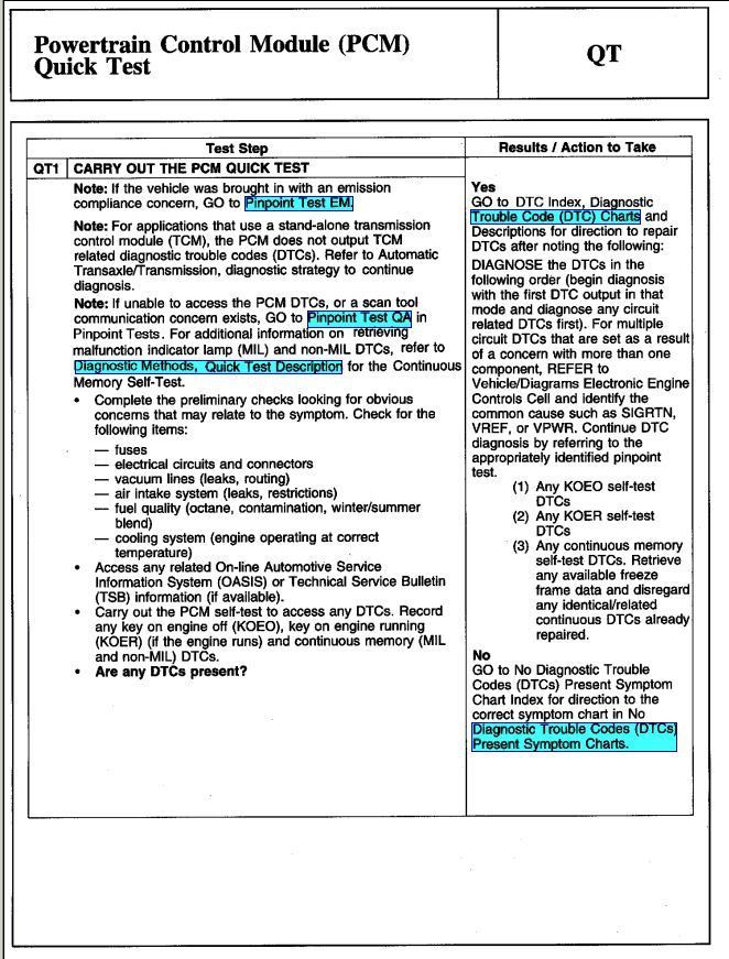

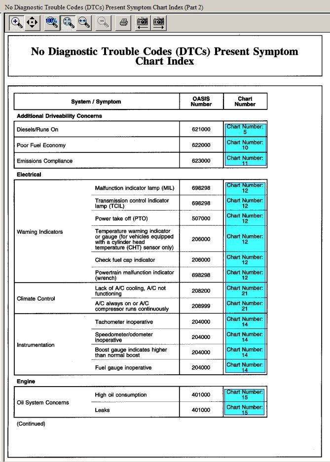

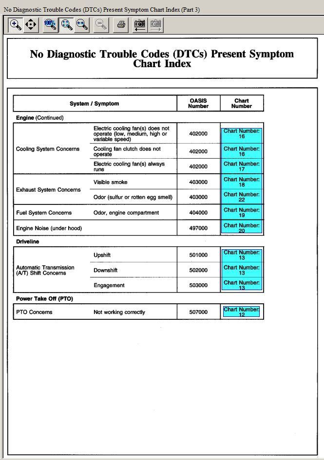

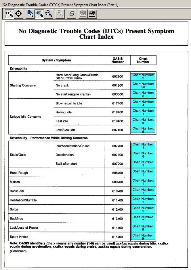

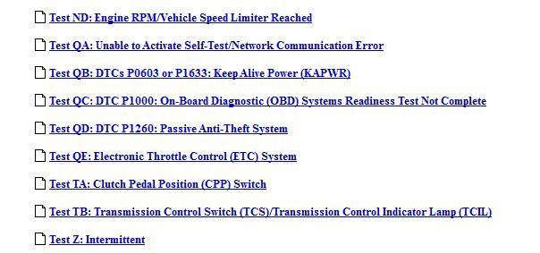

All those are from my alldata software and it covers any car up to 2007. It's copyrighted so I can't burn DVDs and sell or give away to anyone. If you need anything in particular please ask and I'm more than happy to share my alldata with anyone.
