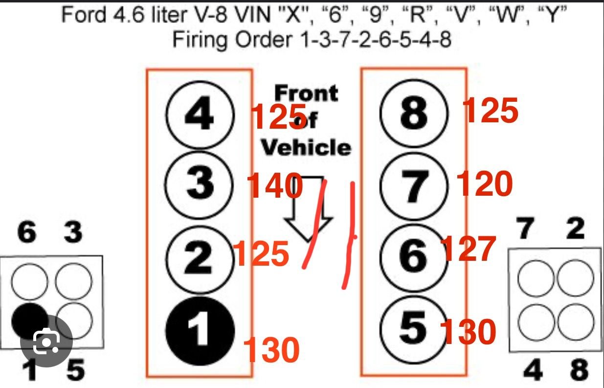

Not sure if I already mentioned I did compression. Test on all cylinders will attach pic of the readings

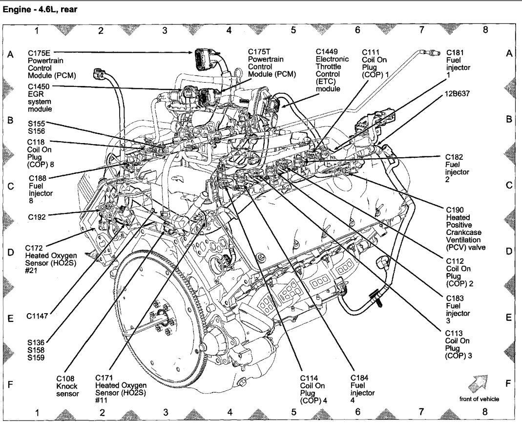

The PCV valve is supposed to rattle when you shake it. Just that it rattles doesn't mean it's in good condition. It's a part that should be inspected and changed whenever a car is getting a regular tune up, some bad shops skip that check up.
A valve cover gasket leaking is usually a good sign of bad PCV valve when the crankcase has to find somewhere else that's weak (the valve cover gasket) to ventilate.
You should also inspect the hose for possible crack or damage. My 98 E150 4.2L, once the doghouse is removed, the hose is from the right corner of the valve cover to the intake manifold.
Your 08 e250 4.6L should be elsewhere, can't go wrong if you start looking from the valve cover. Check the diagram below:
My alldata software supports any car up to 2009 but the 2008-2009 are missing a lot of diagrams and locations so the diagram above is for 07 e250 4.6L hopefully it's the same as your 08.
Your van might not have IAC if you have electronic throttle body.
If you can't locate something like shown above near your throttle body, then you don't have it.
And if you don't see any significant DTC showing up, you might just want to run a bottle of Berryman 2611, it will deep clean the carbon build up at the combustion chamber when a walnut blasting on GDI engines can only target at the intake valves.

thank you for your picture i agree ford dropped a ball on diagrams and directions for 2008

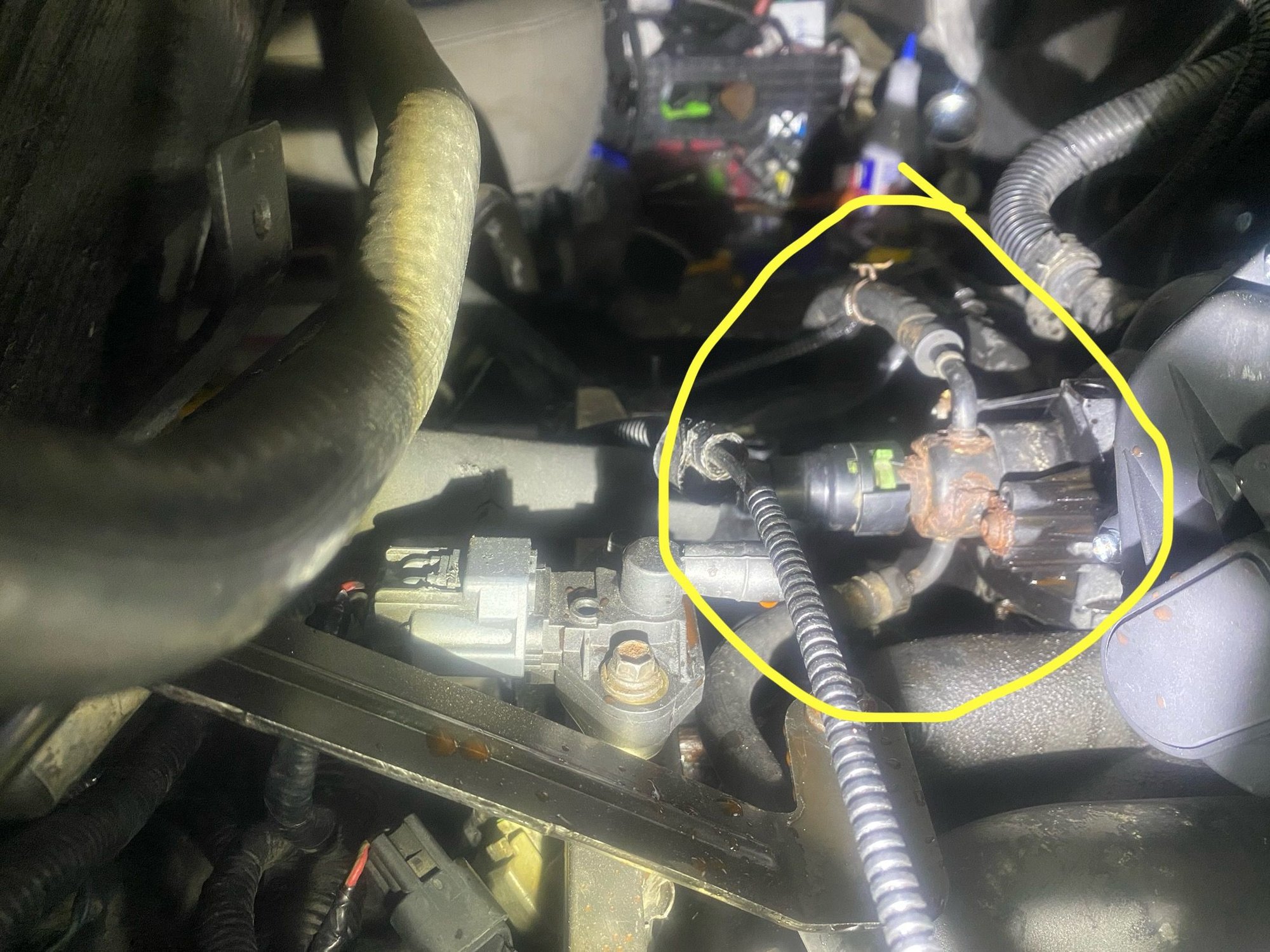

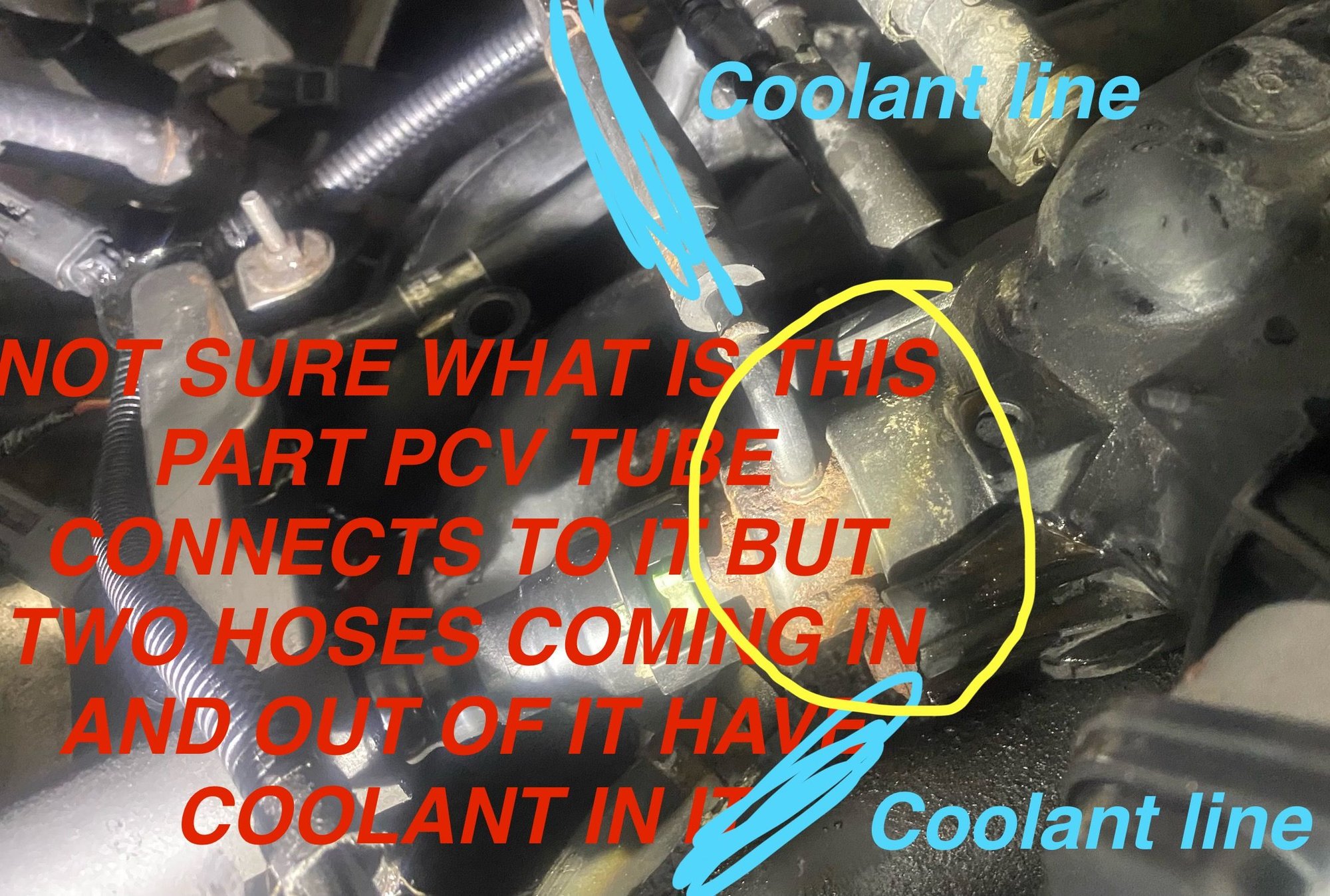

Were you able to see in one of the pics where PCV tube connects to intake manifold what is that part that has coolant tubes connected to

Again, below are from 2007 e250 4.6L
