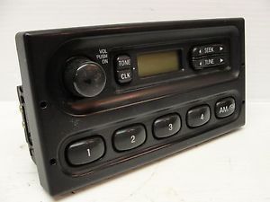

The buttons and dials light up but the face does not. Should I just replace the radio? There is no radio either, its like its dead?/ or maybe just sticky and wont turn on because its so gross inside haha.

1) Can you take a screenshot of your radio?

I have the basic 99 AM/FM radio.

And to answer your question, the aforementioned AM/FM radio style

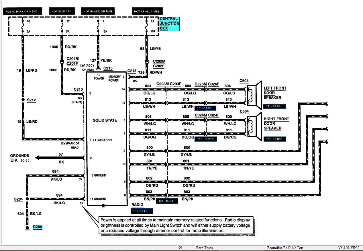

Most radios have 2 types of power supplied. One constant for clock and memory, and one after the ign is turned on.
You might check all the fuses to insure all power as not been interrupted.

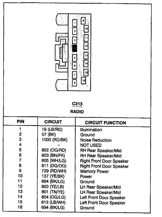

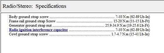

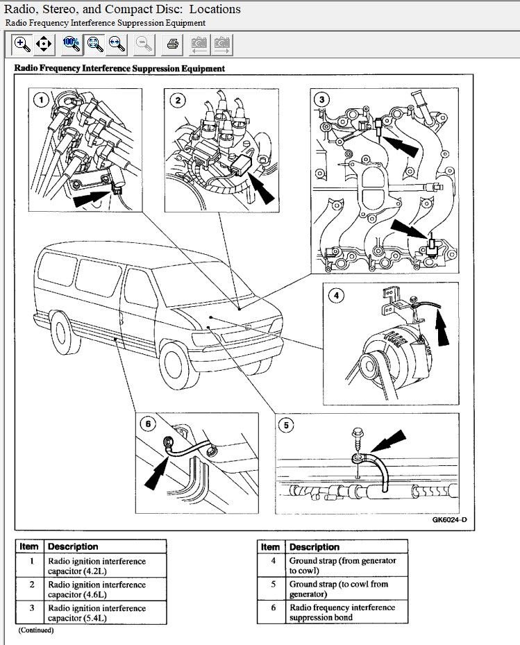

Above diagram locate that from your alternator to your cowl, clean using 91% isopropyl alcohol and wire brush, use ohmmeter to check make sure it's less than 2 ohm.
You can also tell by now why is engine size important, too important that I had to mention that on my signature, in order to provide the correct diagrams.
Above shows just the index page, to click thru them check Pinpoint-Test.pdf below.
Never forget to check if you have speakers at your front door, what if the previous owner removed them? Your radio won't give you any sound if the speakers are missing, that's why I mentioned this in my last post. Check the pdf below.
