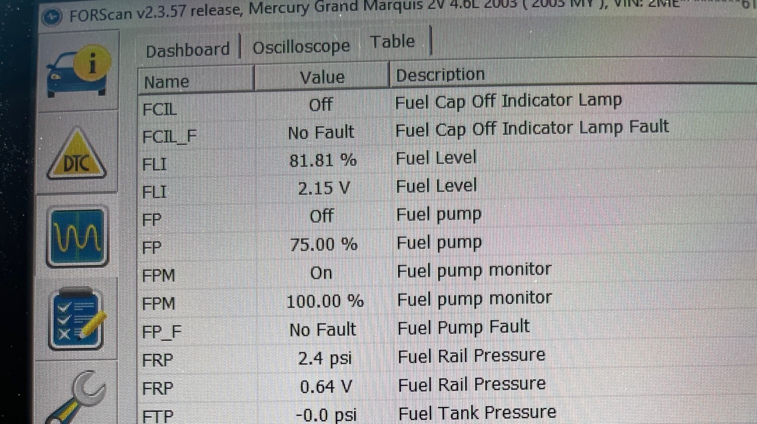

Scanned with Forscan.
It reports no pump fault but also shows no-run for pump
At KOEO I don't hear the pump prime.

Fuel rail pressure doesn't look right., should be much higher.
Did you run it any after you put in the HEET? If not, if still cold could it be frozen fuel filter?
should there be fuel rail pressure if the pump does not run? Tried to start after HEET but same crank no start.
